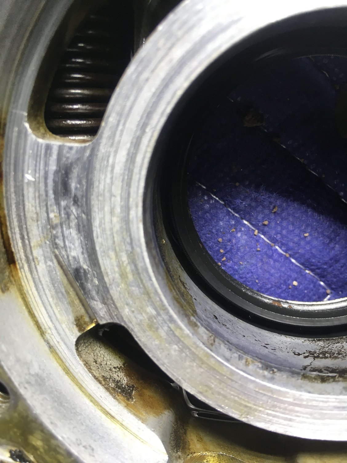

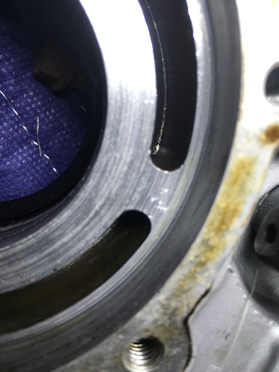

What do you guys think about the cover and gears? Reuseable?
