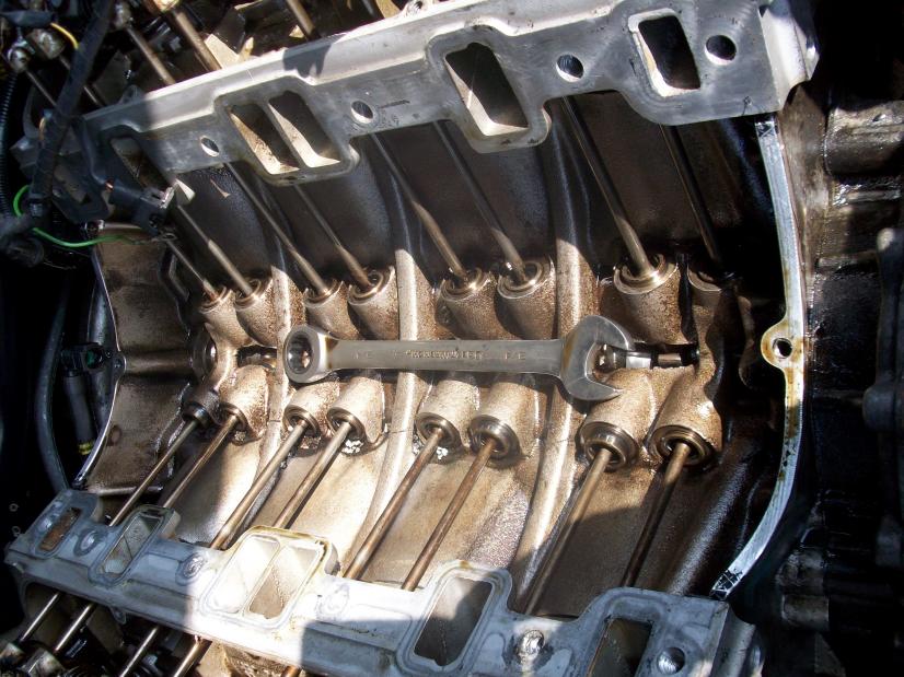

Put in 15W40 Rotella dino oil, do a mechanical gauge OIL PSI test. Also check coolant temp with a scanner (not the temp gauge). If engine is real hot, oil will thin.
But since it happens warm, it could also be "the tick" from a slipping sleeve. Or a tool left behind by shop.
