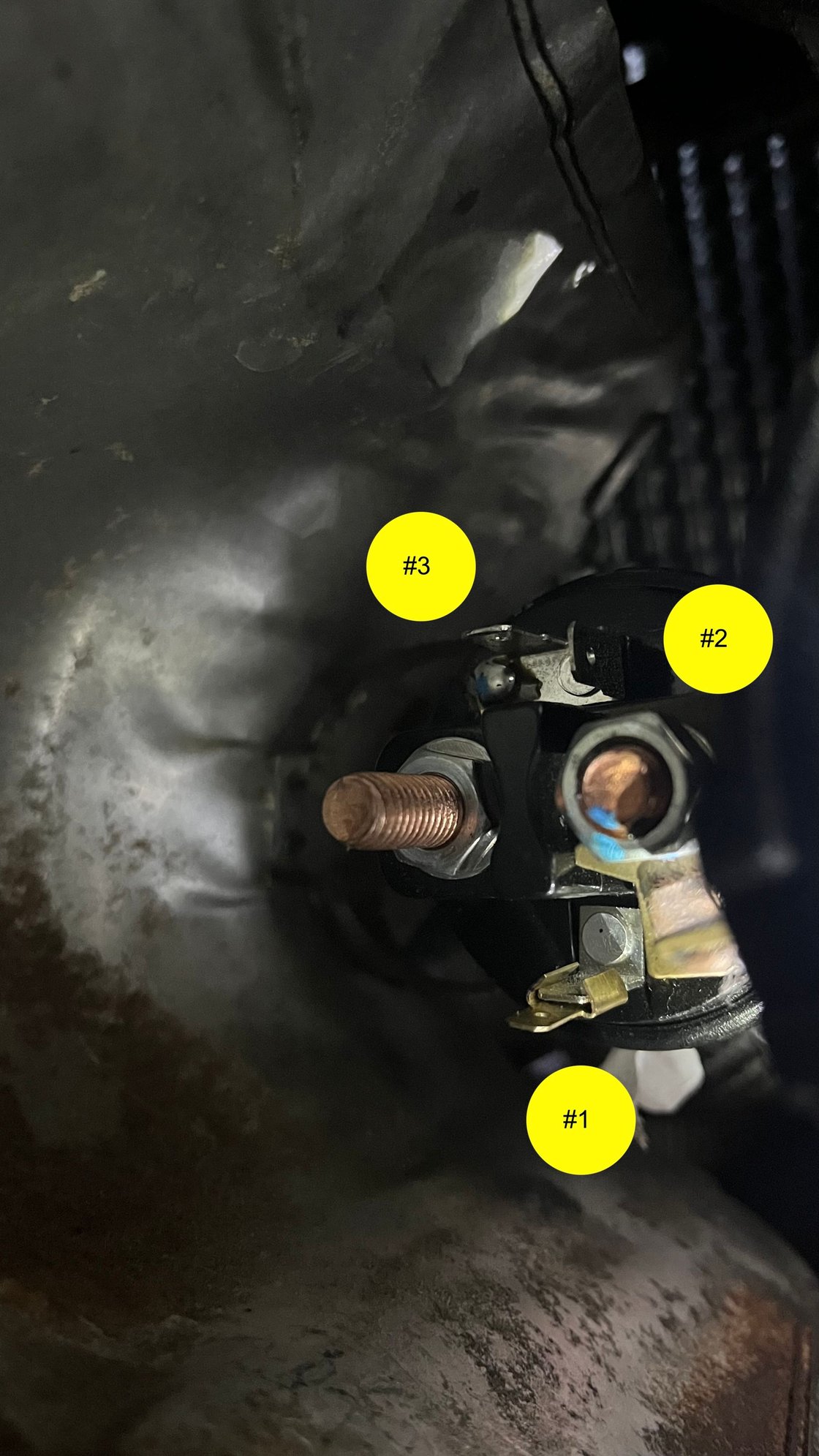

Can you post a photo of your wiring on the starter?
I just replaced my starter with one from Oriellys and it had several spade terminals (whereas the original bosch only had a single spade) for the "signal" wire and the large battery cable terminal was able to touch one of those spades causing the same auto-start behavior. I had to bend that extra spade out of the way but I've been meaning to go back in there and just cut it off.

We did it folks!! @gecko951 was spot on! I was so excited reading your comment last night that I got up early this morning to try it out. You'll see from the picture I've attached that when I had the battery lead connected to the starter, it was twisted and making contact with #3. I had the signal wire attached to #1. This morning when I removed the battery lead, I could see evidence of sparking against #3. So instead I turned the battery lead down instead of up, and bent #1 far out of the way. Then I connected the signal wire to #2
I turned the key to prime the fuel pump and she fired up immediately! First try!
