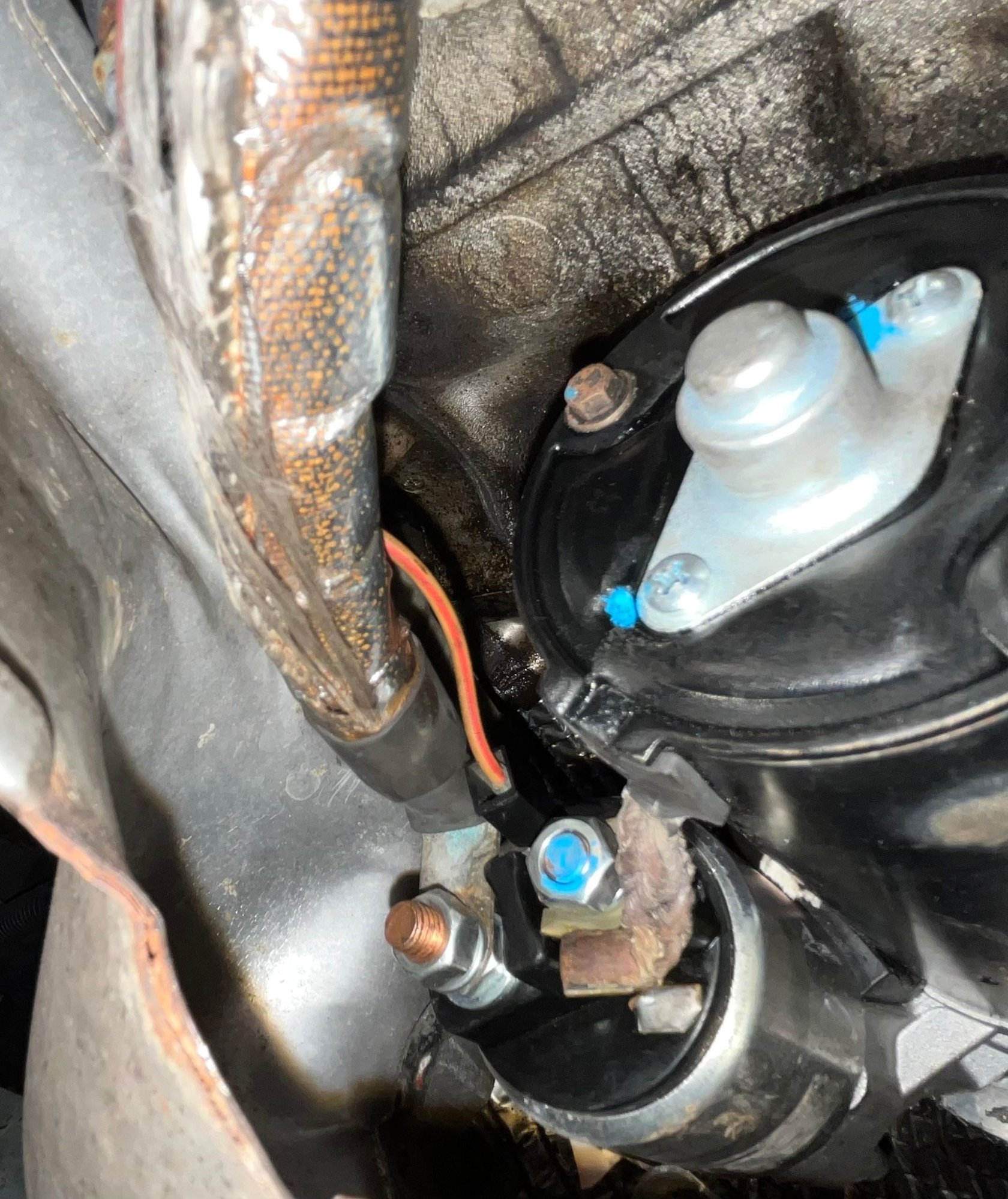

From: Florida
@H20nSnow , some assistance based on the photo below? Additionally, this is a new starter and it did work for several test starts and a couple of test drives. Would the solenoid go badly that quickly?
What exactly am I supposed to be jumping between to test activating the solenoid?

Place a large screwdriver between those two lugs on the start and see if it turns. It is possible with the low battery you arced enough on the solenoid contact ring to pit/burn it and now it won't start. Did you try jumping the relay?
Old Sep 10, 2024 | 09:41 PM
  #29
H20nSnow's Avatar
Joined: Nov 2023
Posts: 301
Likes: 109
To expand on Extinct’s comment, jumping those two large studs bypasses the solenoid. If it works then the solenoid is bad. If it still doesn’t work then you still have a cable or battery problem. If it works then move up to the start relay that drives the solenoid. If it works there then you have a bad relay. Keep moving up the chain until you locate the device that works when you bypass. That is your failed device. Make sure you don’t get hung up trying understanding why a given part might be bad before testing it. Test it THEN understand why it’s bad, or move on if it’s not.
