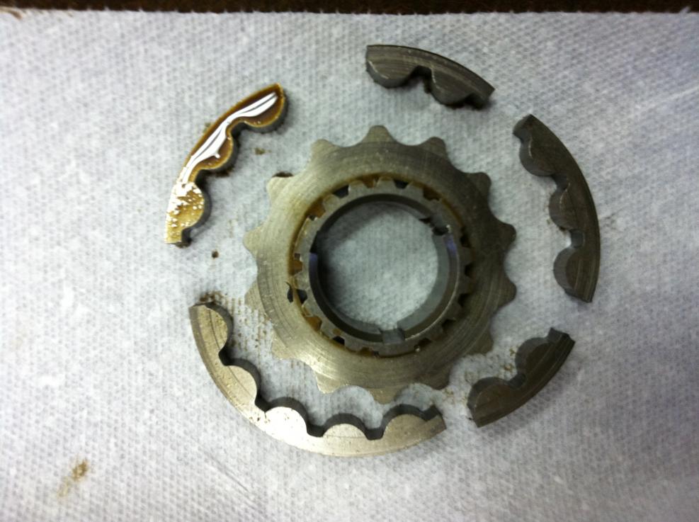

Well as I am getting ready to install the oil pump in the engine cover, I take a closer look and........WHAM!!!! Looks like a hair fell in. Try to take it out and.......my fear becomes a reality. CRACK!!!!! Probably created by the 5 piece outer ring from the oil pump rattling around the housing.
Just called Atlantic British and ordered a new cover. Guy seen that I already spent over a grand in last two weeks so he decides to give me 10% off.
It is a small crack but I can not take chances. If it cracks more, I will lose oil pressure or if a piece of the cover falls in the pump.....well then I need a new engine. So.....Place another order.
Word of advice: if you have a cracked oil pump, check your engine cover really good. Obviously they have tendency of cracking as well. THANKS LAND ROVER!!!!!! Should of bought a boat (there goes another grand) lol.
See picture of the front cover and oil pump.
Cheers.
Attached Thumbnails Now I got a cracked engine cover!!!!!-cracked_engine_cover.jpg   Now I got a cracked engine cover!!!!!-cracked_oil_pump.jpg

Well my new cover came in. Looks great!!! So since it came in with oil pump already in it, I decided to take the cover off and inspect to make sure everything is in good order before I install it. Guess what I see!!!
A fu$%ing parting line in the same spot that I thought my crack was!!!!!! It was not a crack....it was a fu%^ing parting line from cast aluminum in the old cover!!!!!
So.........got myself a new cover+oil pump+crank shaft seal+few other gaskets that I did not need.
PLEASE MIKE OR SOMEONE. Place the picture on this topic to the "sticky" and advise others that if they are doing the inspection on their housing that what seems and looks and feels like a crack is actually a parting line from the cast.
I didn't know if I should keep my mouth shut to save myself the embaresment or should I say something and maybe save others a few hundred bucks........
I would hate to see others throw their money away like I just did. I am surprised that nobody caught this before.
Moderator....please take the picture I posted and make it a stick in "maintenance" section or something. It identifies the area clearly and it is unmistakable. Very hard to miss when you are cleaning the cover from the inside.
I feel like crying..........
