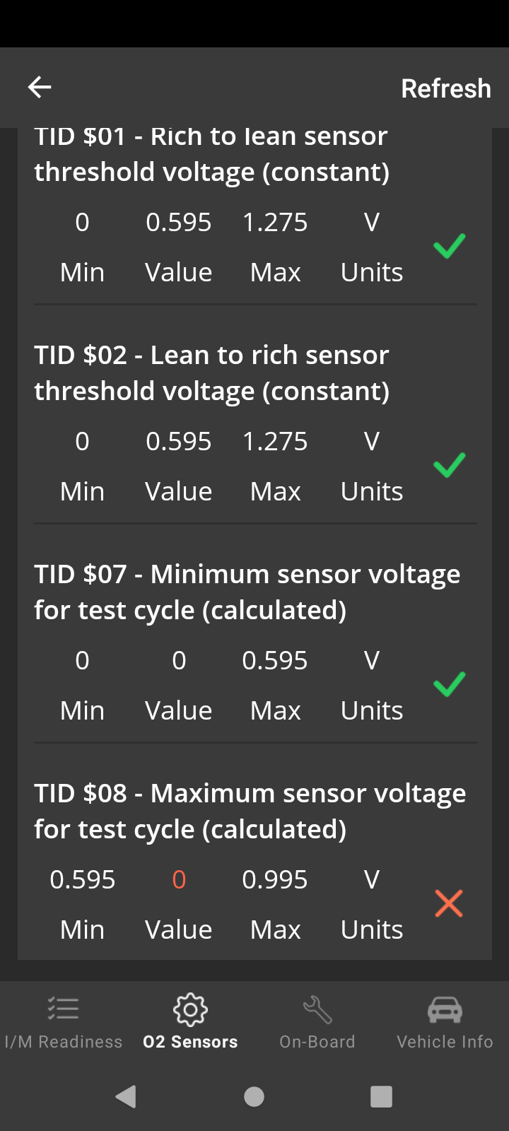

Currently getting a P0420 and P0430 codes. I recently ran a O2 sensor test on OBD Fusion and iCarSoft devices. The Fusion app shows the downstream O2 sensors fail the max voltage test. (Bank 1 Sensor2 & Bank 2 sensor2) The iCarsoft shows the same failure on max voltage test. The whole system is a Magnaflow front to back. Bosch sensors were installed new. Systems is 12+ yrs old. Here is the backstory the led to this

Fast forward to last week and while driving on the highway around 65 the check engine light comes on. Check codes and now I'm getting P0420/P0430. I have cleared these codes twice. Is it possible that I fried the downstream sensor by driving it with the cracked connection or heating it up/contaminated them and/or are my cats fried as well? Trying to figure out if this max voltage test is legit for the sensors? I downloaded the Torque App and will be trying that later today. The initial voltage reading showed fluctuations in voltage with the upstream ones and downstream at idle and warmed up. Should my downstream O2sensor voltage remain constant or fluctuate? Truck is driving normal/good acceleration and temps back to normal.
