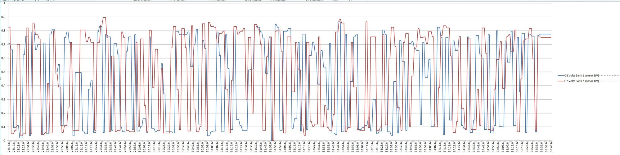

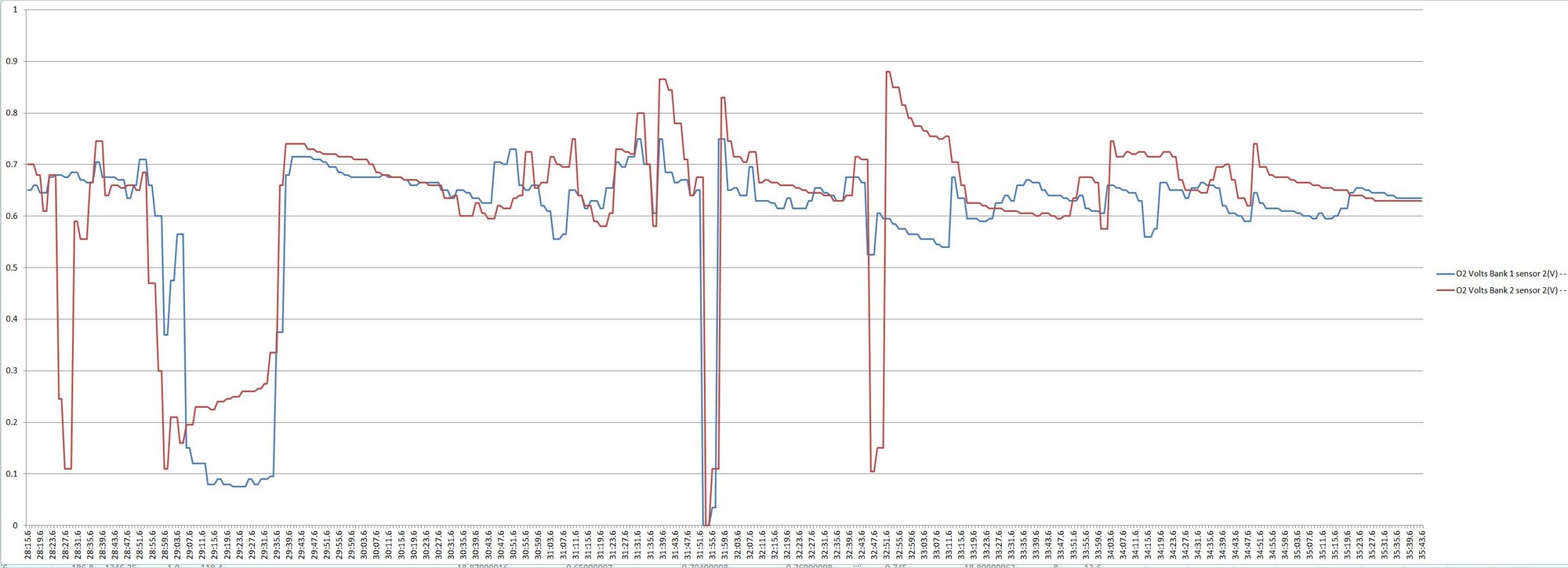

Some images time & O2's engine temp was between 183 and 194, time is minutes and seconds
Front
Rear
Rear

Here's a shot of mine over a 10 mile stretch. I'd say your rears indeed look pretty funky.

OP: the front O2 sensors are supposed to oscillate back an forth between about .1 and .9..averaging somewhat at stoch value, so what you are seeing is normal. the rears do look a bit wonky... were they up to temp? I think there is a few min delay after starting before O2's are read by the ECU.......

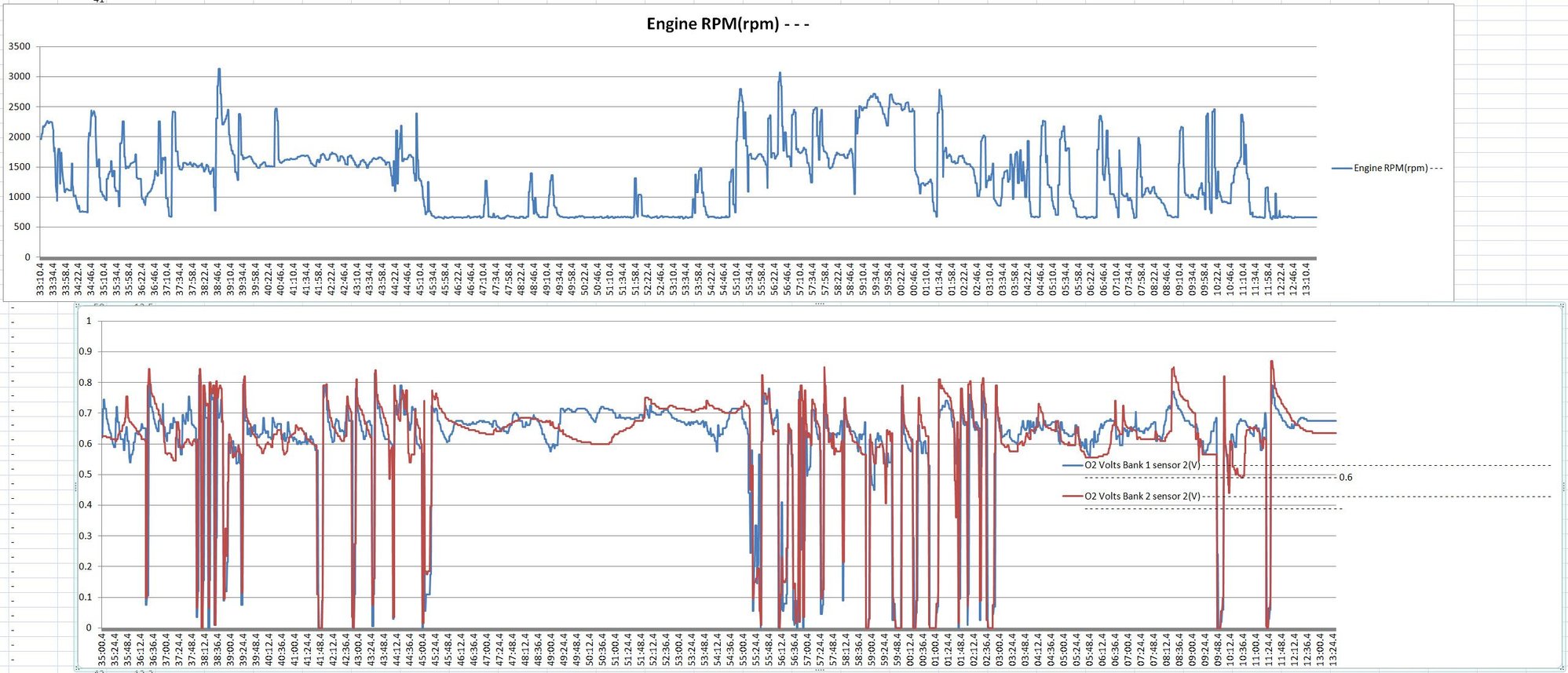

@ahab thanks for the graphs, I am going give the cleaner another few days. I have short off road trip this week end, if the rears are still ugly after that I will replace them and continue checking. I have torque setup to log so it is easy to check
@XRAD they were, but as noted I will have a better idea after this weekend

I took @XRAD question into consideration perhaps it was more of the hi /low speed issue for teh trip, below are the results for a dump run I did about 45 minutes the flat line would be setting while unloading and not breaking 1000 rpm. Route was uphill, and some down hill largely coasting at towards end
