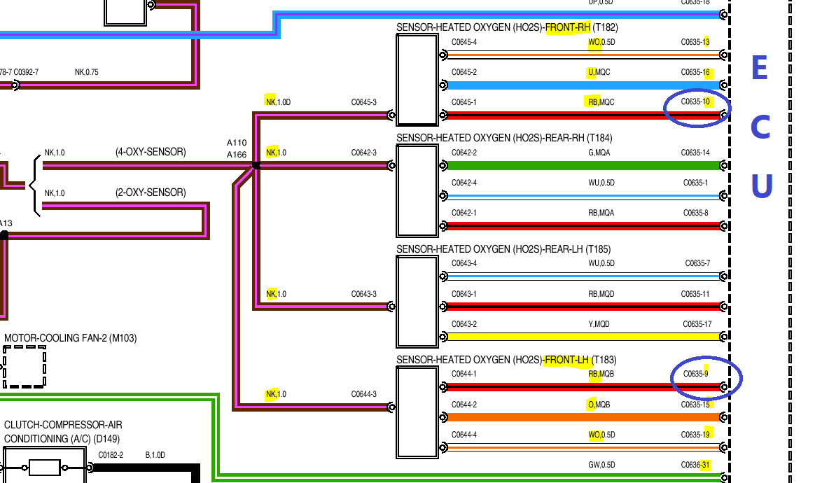

I looked by search for the thread where someone stated that the upstream O2 sensors sometimes lose ground back to the ECM. IIRC, the red and black wire.
While I am putting my engine back in and since I previously had two (upstream) O2 sensors that were not showing any reading on my live data stream, I wanted to add some small pigtails to the harness for testing after I get the truck running.
Can anyone verify the wire color is right?

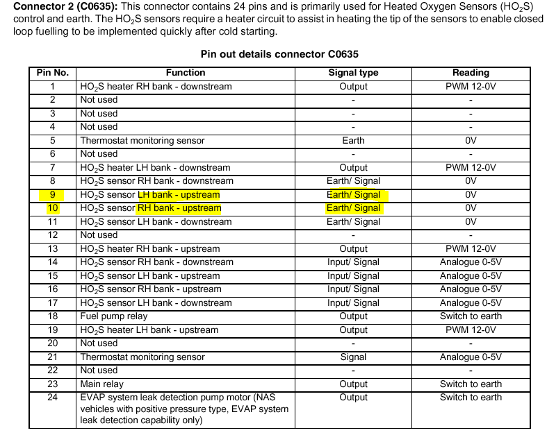

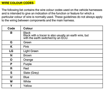

Yep Red/Black is ground back to the ECU. Here are the rest of the pin outs and more info than you need. Go NUTZ!
