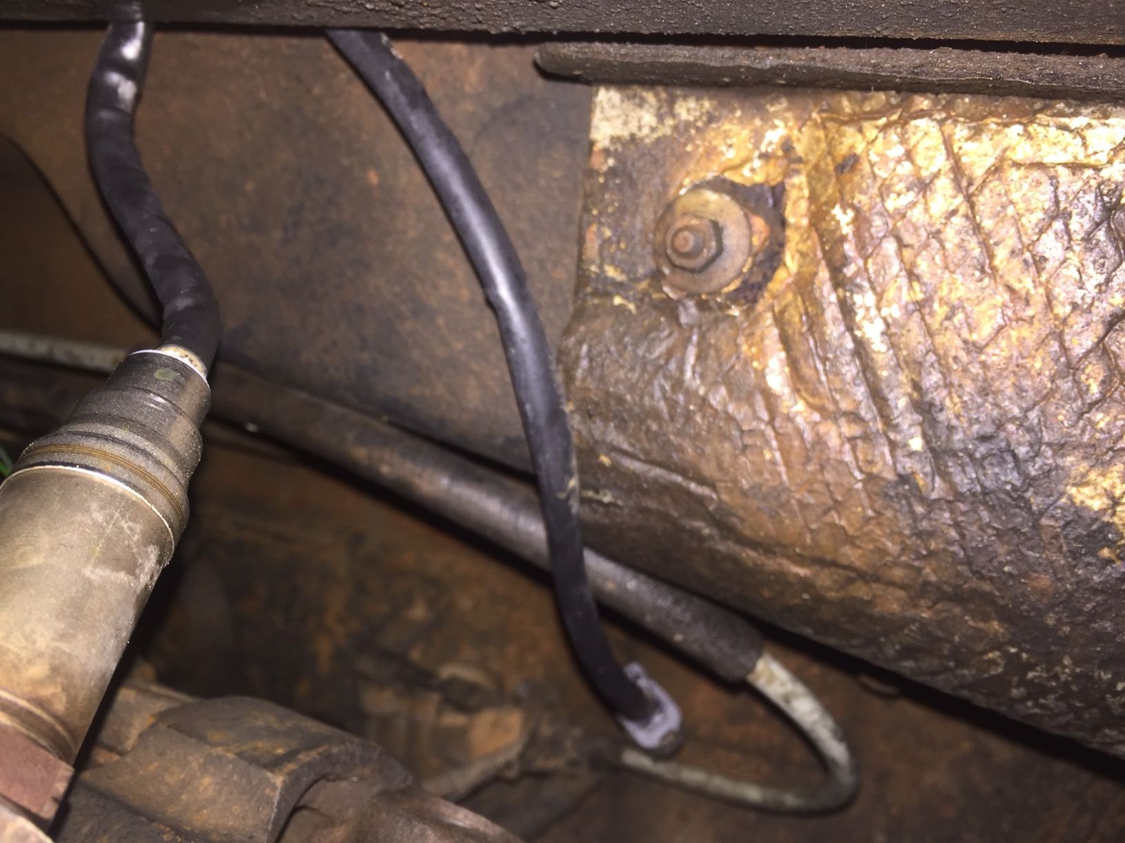

I haven't put the second new one in yet. I thought I would check in before I did to see if there was something I should look at before I threw another $50 sensor at it. In the picture, you can see that the plug is pretty high by the transmission and loops over another hose. Is that where it should be positioned?

I swapped in the other new Bosch o2 sensor and again it's unresponsive after a few minutes of driving. The wires go over the transmission. Is that right? I'm thinking the transmission heats up and causes the wire not to respond. Any one have a suggestion?

Are you getting a click when inserting the O2 connector? In my case the harness side clicking lock mechanism was broken and not holding the connector tightly. That is why it would work after install but die after driving/vibration.
I ended up cutting the harness connector off right at the plug and using butt connectors to attach the new/used connector.
Also check that the white insert from the old O2 is not in the connector.

Can you confirm that the wire should continue over top of the transmission? Is there something safe I could wrap the wires in that could reduce the heat onto the wire but not melt?

I think the wires looked fine for looping if they are secure. As long as they don't get on the exhaust it should be fine.
