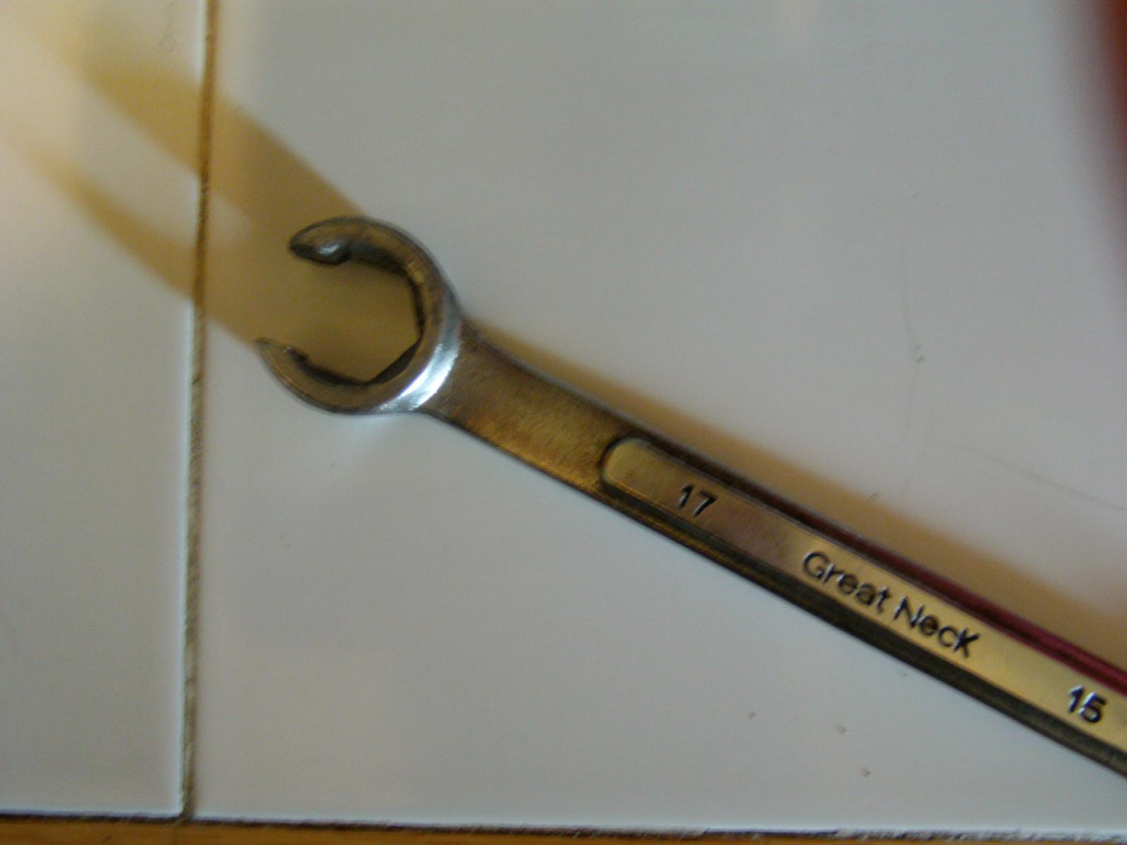

You are correct, o2's on my d1 were 17mm,not a standard size. To remove them, I found a wrench at autozone that was for a/c lines or something. its like a 17mm box end with a notch cut out it. worked great. From reading other posts everyone will recommend replacing in pairs, as an old one and new one mixed will give false readings on one side.

There is also a special socket made for 02 sensors that is made to fit around the wires, an open wrench is good though.

i cant describe things to well. $8 at autozone
