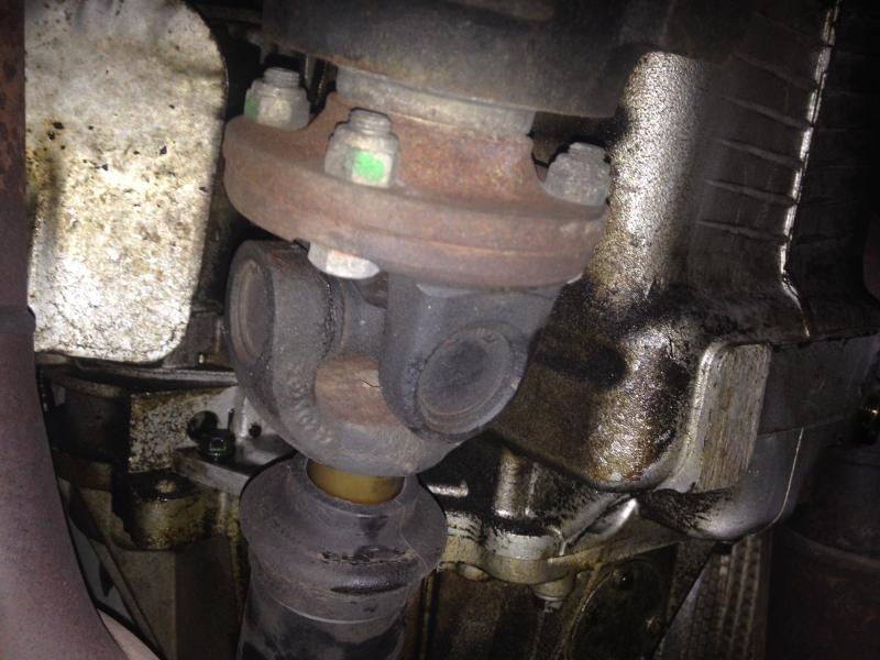

Just had a good proper look underneath. Swapped the oil for Rotella 15w/40.
Have bought in coolant. Tyranny fluid. Tasks for the coming days.
So, drive shaft. Only one grease nipple on the front. So it needs swapping? Is it as easy as it looks? 4 bolts each end. It's telescopic. 30 mins? Or is it some kind of Trojan horse, looking friendly until it's off then, bam, didnt see that coming. Anyone got a link to the later best deal on one of those?

As far as diveshafts, sounds like it still has the original in it and they can fly apart and knock a hole in the transmission due to being too close to the catalytic converter (bakes the grease out) and being none greaseable. So... the none servicable joints and the centering ball have never been serviced.
Yes it's an easy swap, just not an easy rebuild. There are alot of vendors that carry replacement upgraded shafts... best to get one with all greaseable 1310 series u-joints and greaseable centering ball and then grease the joints with every oil change and centering ball at least every other oil change. Jack one front wheel up and you can spin the wheel to spin the shaft to get to the grease fittings.
Buyer beware...Prices vary on driveshafts and you don't always get what you pay for.
This one is priced fairly and has the greaseable centering ball and all 1310 series greaseable u-joints... also the seller has 100% positive feedback and specializes in driveshafts.
1999 2000 2001 2002 2003 2004 Land Rover Discovery 2 New Upgrade ft Driveshaft | eBay
Tom woods also makes a good one.
