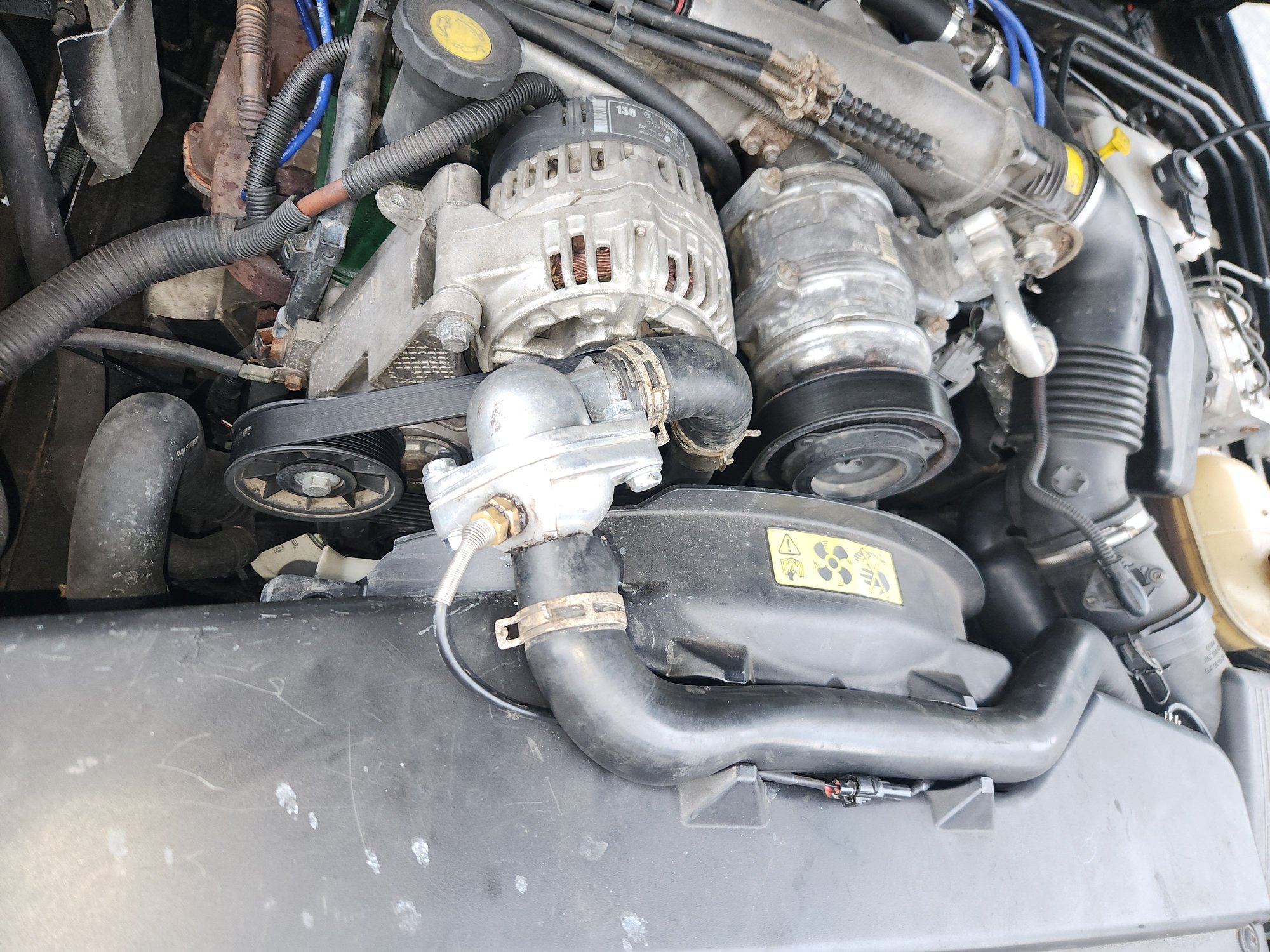

Not sure why you had trouble with the fitment, here is a photo of one of my current trucks with the port up with no interference.

I suspect it is because of the way I had the hoses fitted. I did my best to get it to work out, but I just couldn't. There could also be something else going on I simply don't know about.
