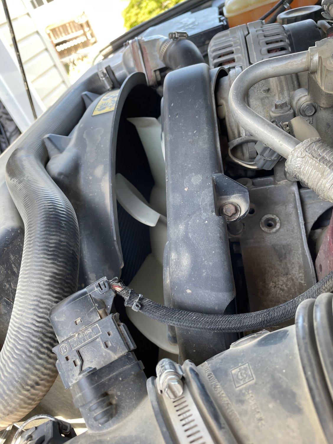

  2. Check your fan and fan clutch - do you have the right fan is the fan clutch working at 220 it should be roaring

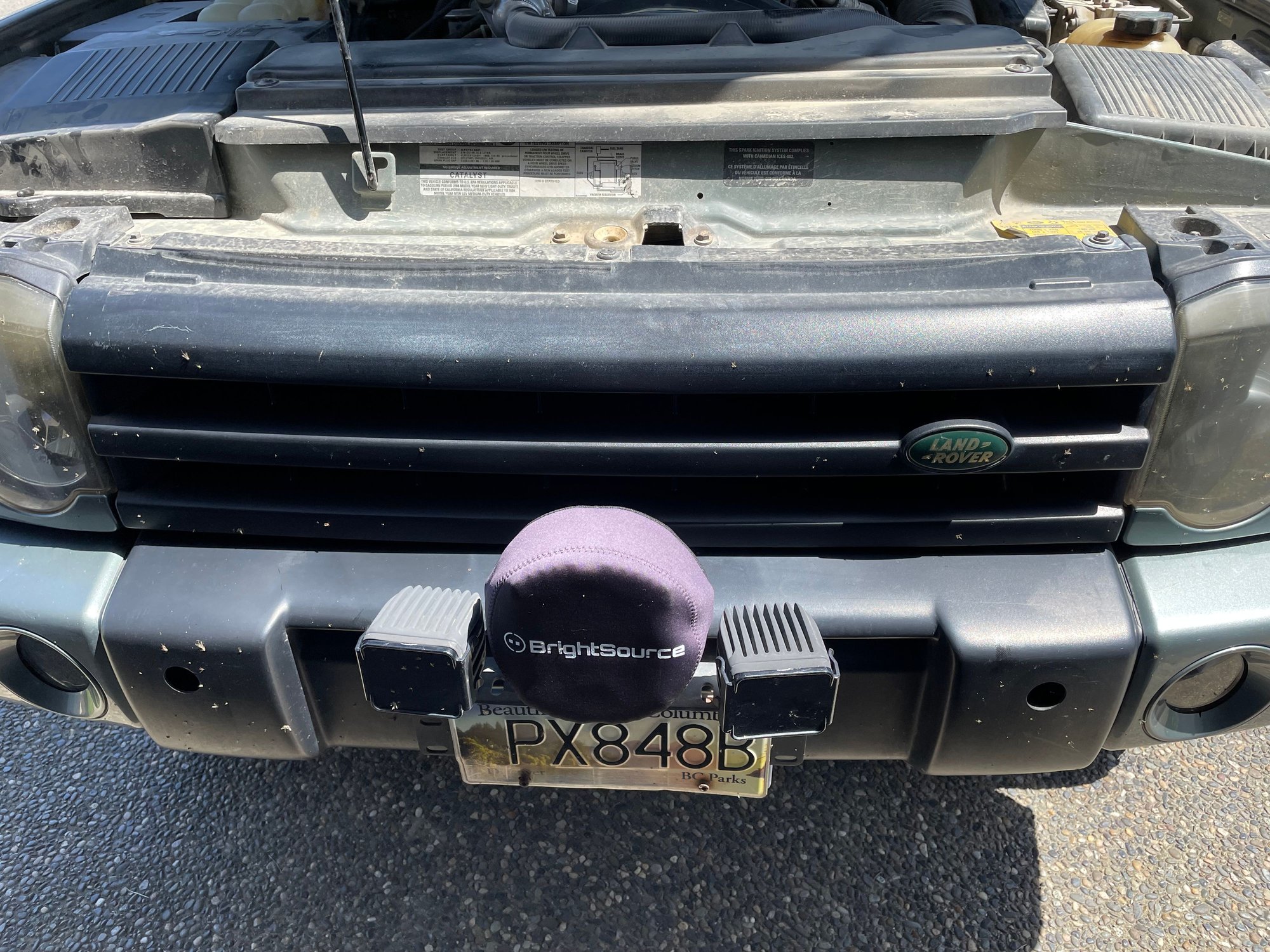

My grille area for refernence
Fan from drivers side
Fan from driver's side
