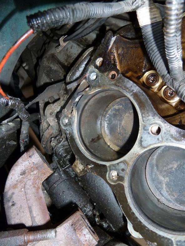

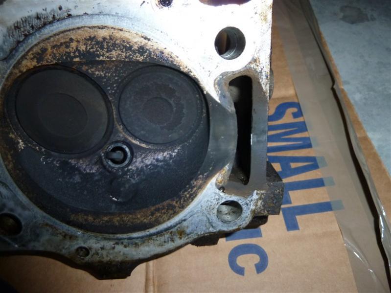

But with such loss, no external leak, and no white smoke, no running rough, may be valley pan. Pix of an HG, there is a slot at the end of each head for coolant in/out.
Any strange color on the plugs if pulled for inspection (like steam cleaned)?
It is said that a slipped sleeve and cracked block can allow coolant to ooze up behind the sleeve and into the cylinder. But, "It" may not be a cracked block, or slipped sleeve, or even head gasket.
I'm afraid you will find out a lot at the valley pan point. See drawing attached. Wonder if you could see with mirror and flash light between valley pan and intake arch, if anything looks strange.
