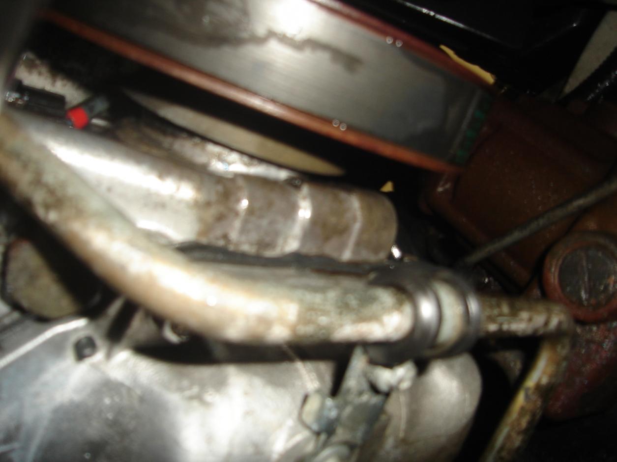

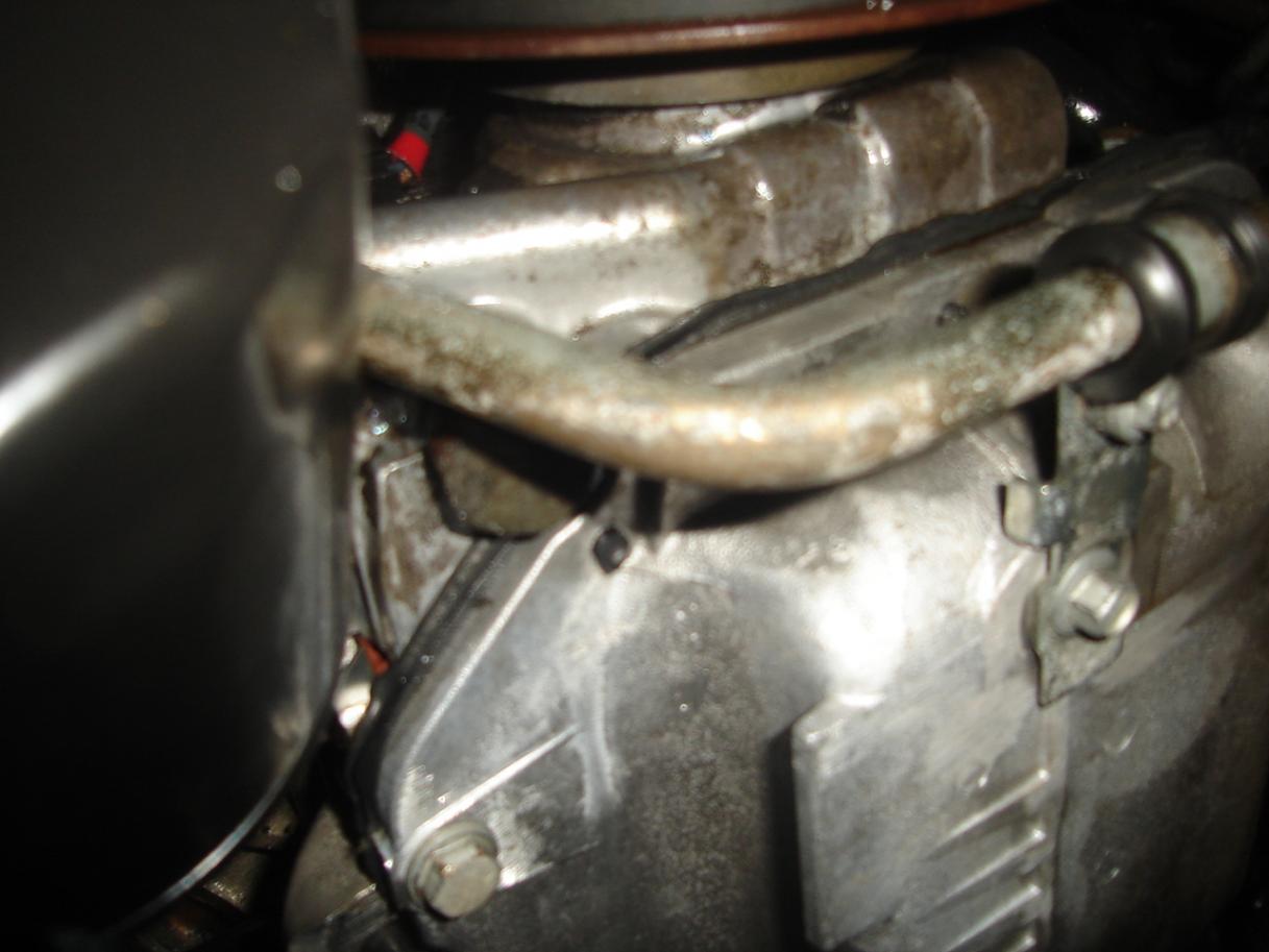

I was hoping I got get a little help. Well for the last 2 weeks I have been having to put a 1/4-1/8 qt of oil in a week. This weekend I cleaned the pan up to see if I could find the leak. After I cleaned it I let it sit for the whole day. And there was no sign of the leak. I drove her on Sunday and return home a parked it overnight, Today on the garage floor is more oil???? I climb under it to see where shes leaking and i cant tell where it is? I got pics after I cleaned it and again today, I was helping someone could point me in a direction? Thanks Again for your time

Most likely the front cover gasket and/or the front oil seal - judging from the location of the photos. Tighten your valve covers as they love to leak.

Check out my 90k maintenance thread. Also Have a look at the large bolts on the front cover. They are close to 22mm. They can come loose and were oil cooler ports on 00-02 discovery's.
It most likely your front cover gasket and a leaky crankshaft seal. I just replace my crankshaft seal and oil pan gasket. I still have a leak, but it has slowed down a little. I dont have too add oil between 5000 miles. So its not too bad.
