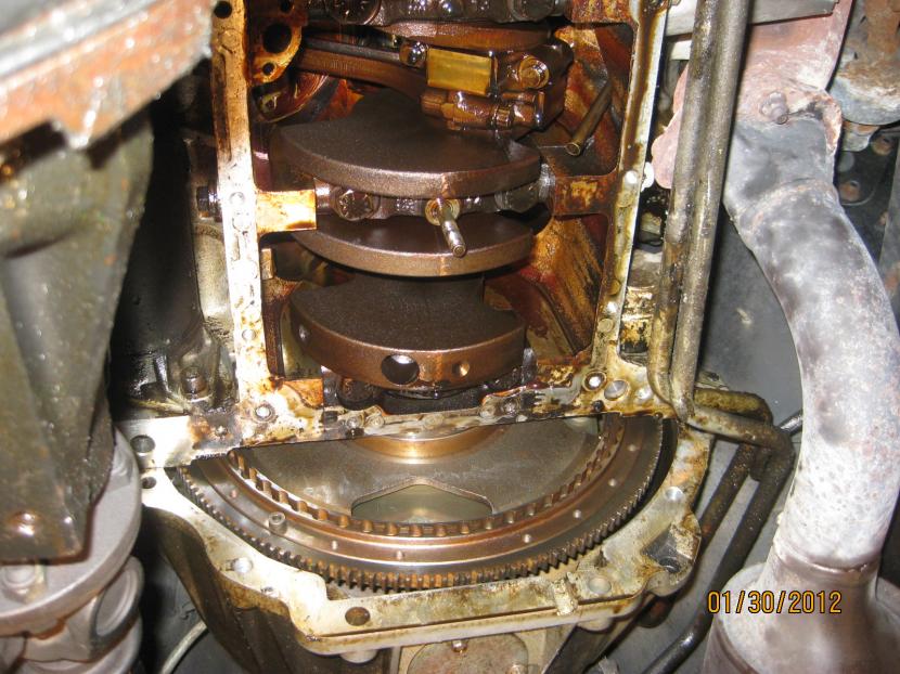

Dang - that oil light comes on when pressure is under 7 PSI. You sound like engine just dumped coolant into the oil pan, or something. You should drain oil, look for coolant contamination (milky). It does not get higher by itself. You can't drive like this. You should never drive with oil light on unless you have some proof that oil PSI switch is bad. Maybe rear main seal blown out, but they usually leak. Could have oil pan gasket problem at the rear - see photo. Will need to do an oil PSI test.
Or could be head gasket leak. They can leak oil as well as coolant. Valley pan can leak oil out the back also.
