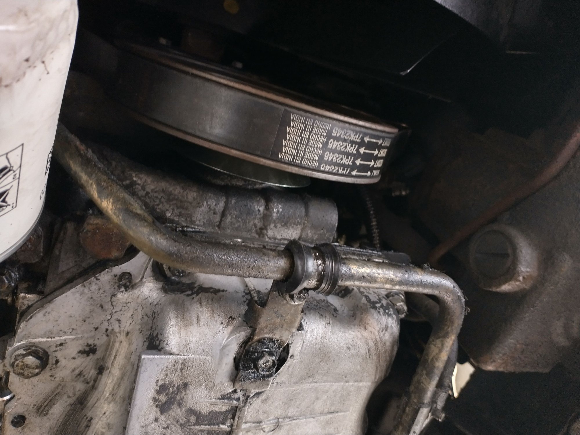

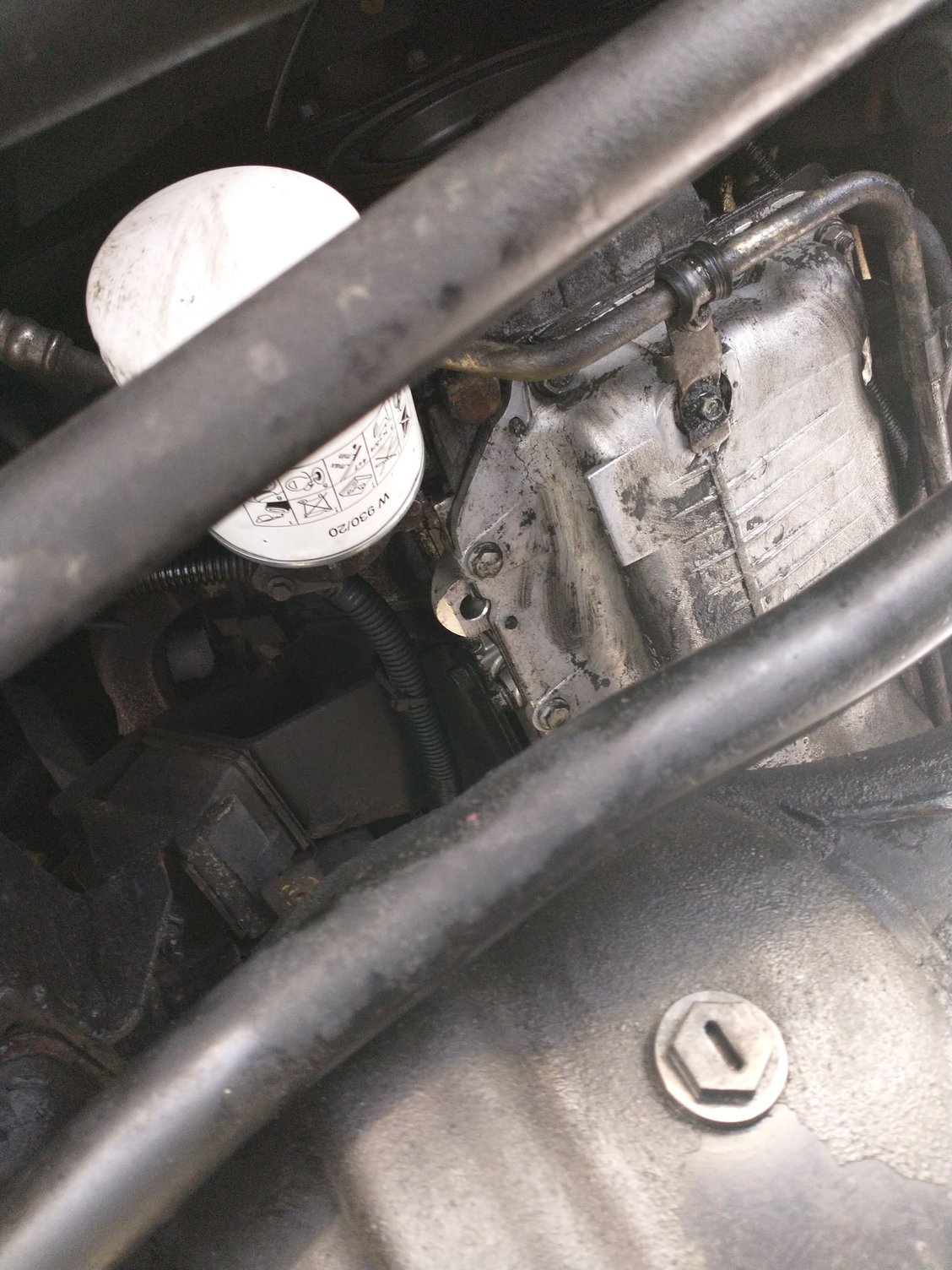

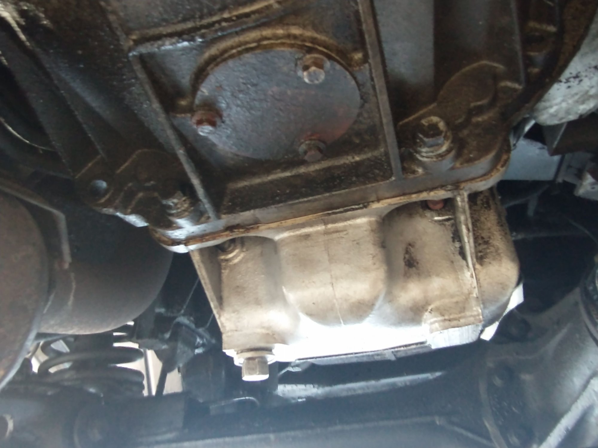

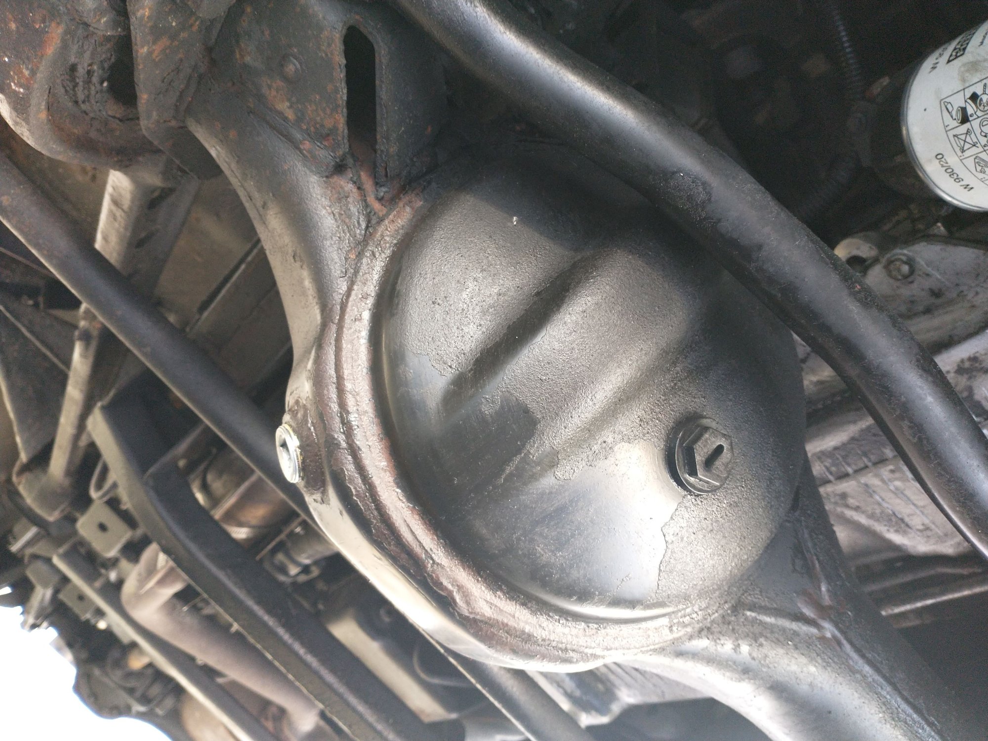

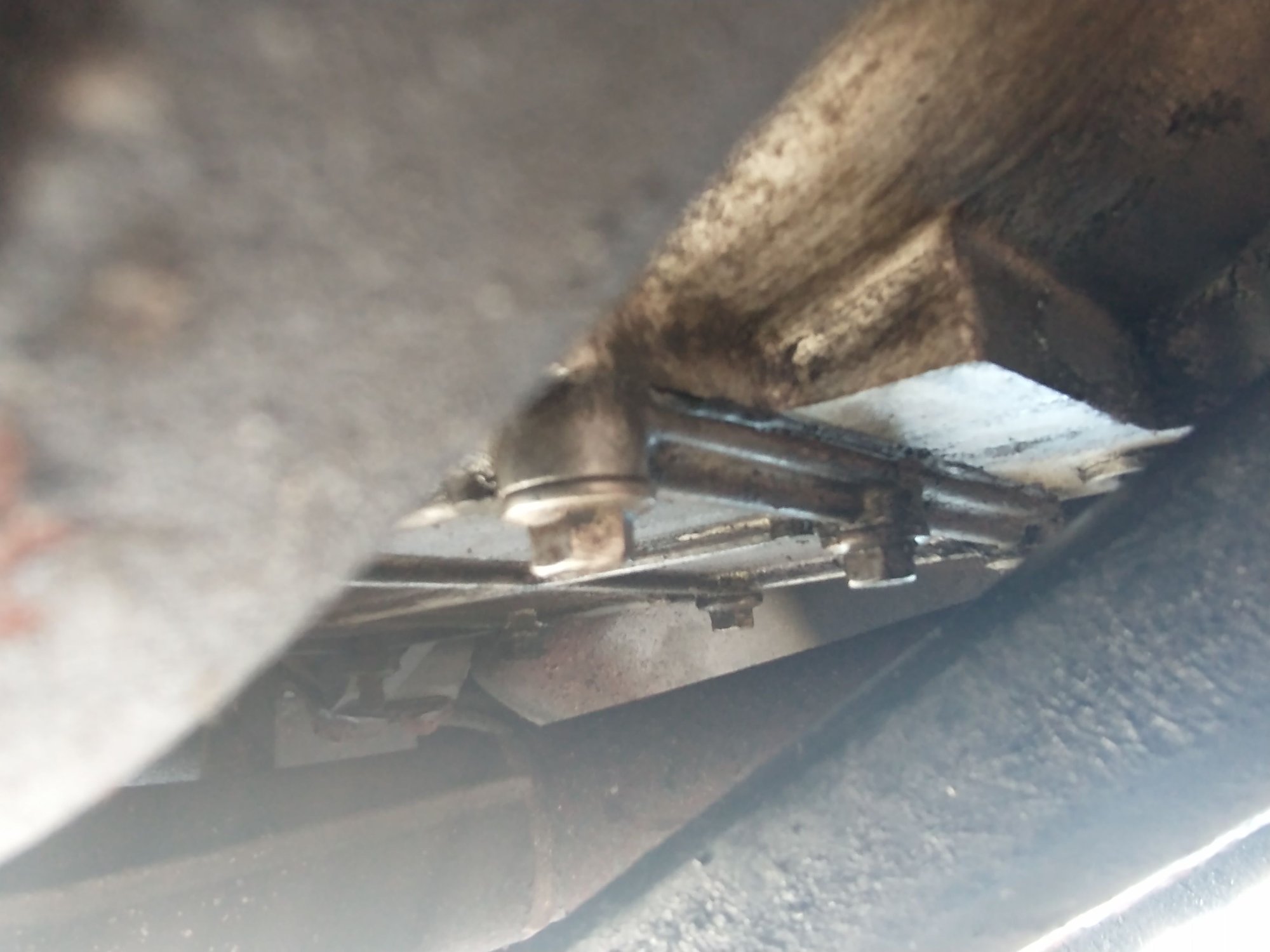

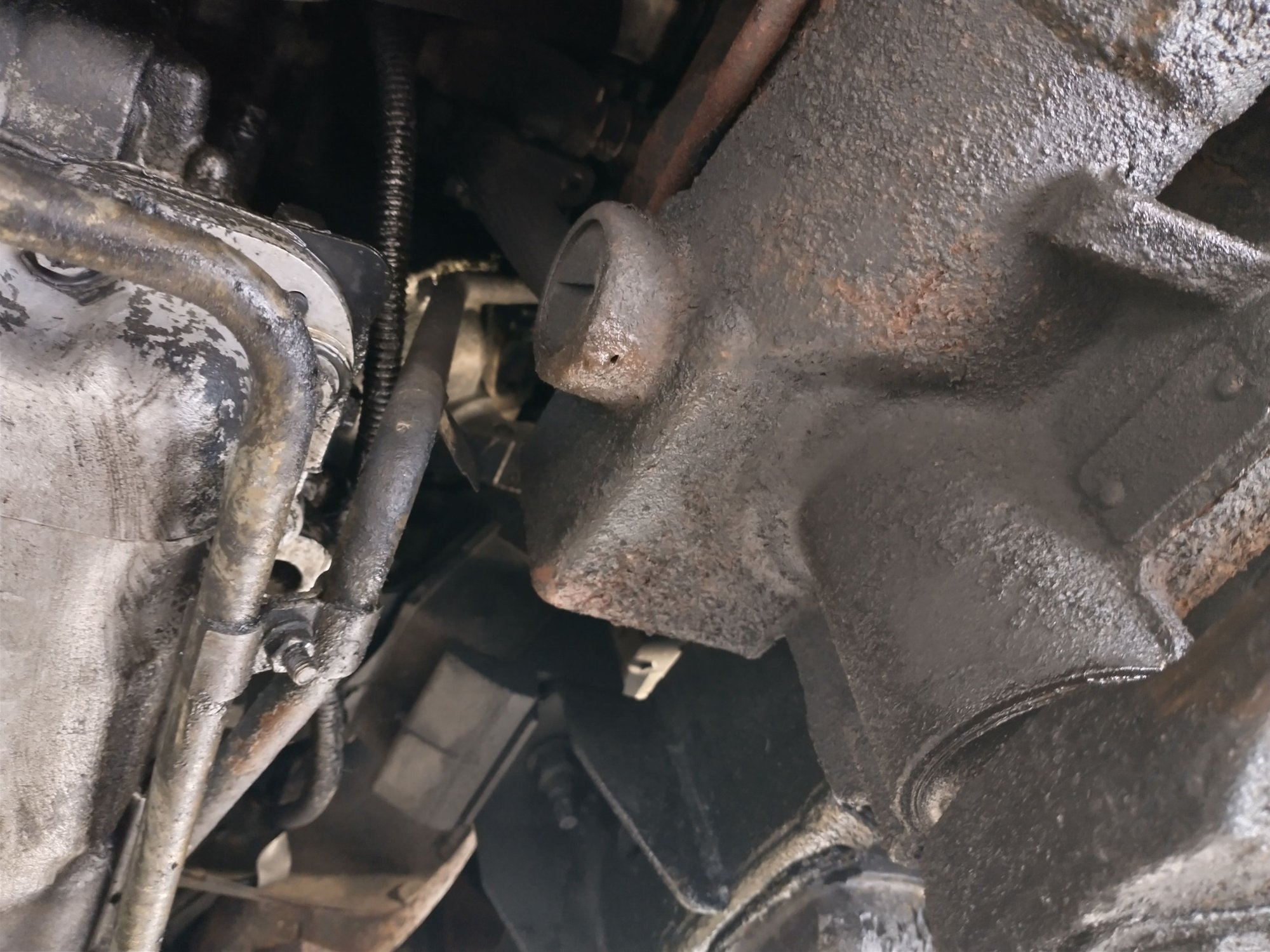

Here are some pics of the truck after going to the wash and hand scrubbing the areas where there was active leaks. I'll take it for a drive shortly and see if new oil drips form.

The side panel of the transfer case is a known spot for leaks, and seems to be almost impossible to seal. Steering box is also pretty common.
If you're trying to get a Rover to be permanently leak-free to avoid spots on your driveway then sure, chase them as much as you can but also just put down a pan to catch the inevitable drips.

that's what I'm gathering...I put a rubber backed mat under the rig to catch any drops...
just checked underneath where I wiped everything on the front and mid areas of the engine/tranny....
oil leak in front is defintely coming from the fill plug...so that sucker is coming out and I'll put some teflon tape as a 1st try to seal it up better.
there were a few drips from the tie rod ends on the passenger side ...must be brake fluid I'm guessing there.
