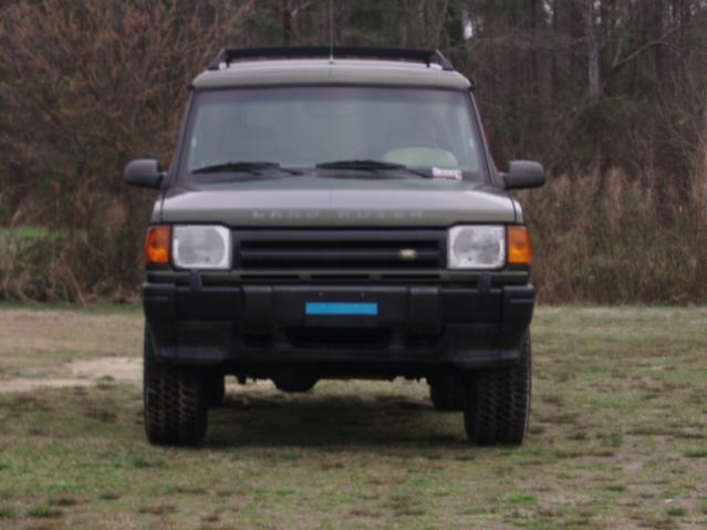

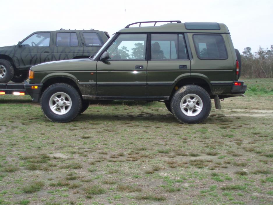

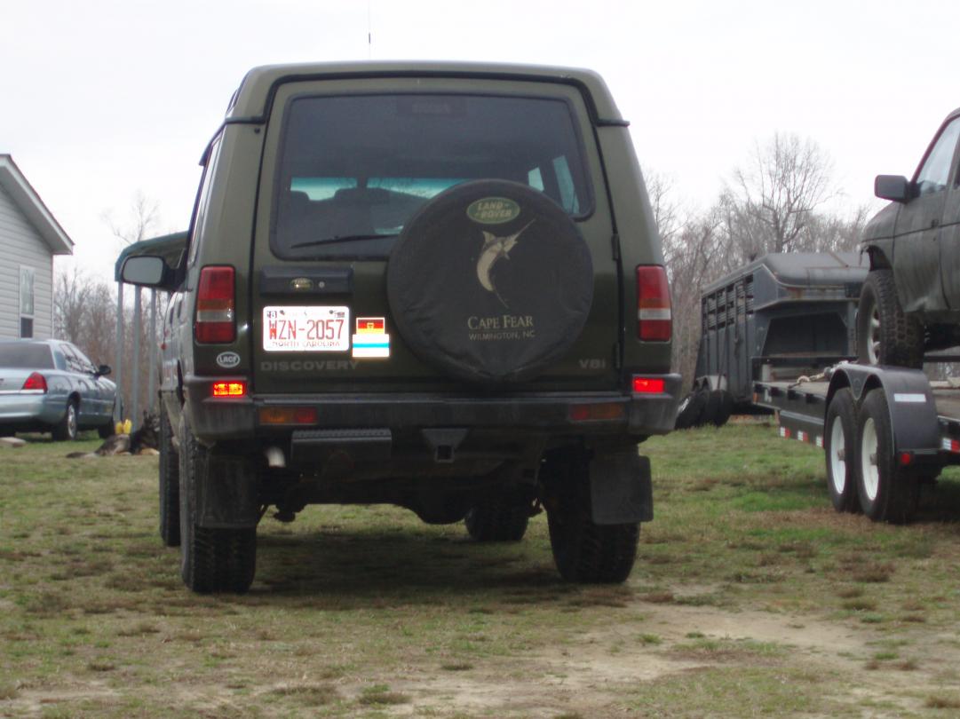

Here are some pics they are only the after pics.
Attached Thumbnails OME is ON-p3170009.jpg   OME is ON-p3170010.jpg   OME is ON-p3170011.jpg

what is that a 31 or 32 inch tire? Could you go any bigger? I'm wanting to do a 33 on mine and don't want to go higher than the 3" lift but I'll probably have to
Old Mar 17, 2009 | 06:18 PM
ghostrider747's Avatar
Posts: 79
From: North Carolina
The 265 75 R16 is 31.6 X 10.4 R16 . I dont think 33's would do too good with just the OME 751 front and the 762 rear. Any bigger I could see some rubbing when loaded and hitting the trails.
