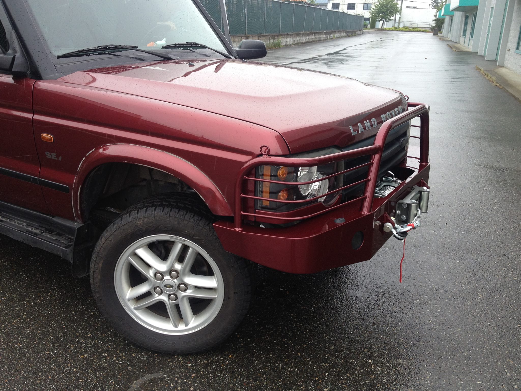

My Disco was modified with a custom heavy-duty front steel bumper and 12K winch. It was also converted from an SE to SE7 with the rear jump seats. Mostly a daily driver with the occasional weekend off-roading trips.
The Terra Firma 2" medium duty worked well for me. I think that heavy duty version would ride pretty rough on the highway. I am glad Justin at L8 recommended the medium duty instead of the heavy duty springs.

How much did the steel bumper sink the springs down? Surely you couldn't have kept the full 2" of lift with it.

Here are some pics of the ride height after the bumper install (with the 255/55R18 tires).
