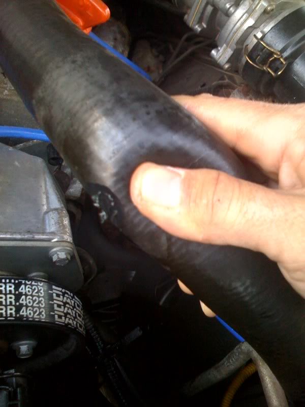

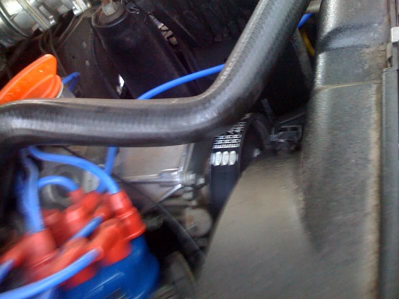

It seems that the upper radiator hose has been rubbing against the Alternator Pulley..

Now I have to dethaw the Camry to drive to the Land Rover Dealer and get a new one...

When you install the new hose, rotate it up a little to correct the angle.

Yea my dumbass must have done it when I changed the Thermostat..
Land Rover does not have the hose in stock..
Ordered from AB and am using an Autozone "Radiator Hose Coupler" for the time being..
One PVC tube.. Two Clamps..
Its ghetto but should work..
