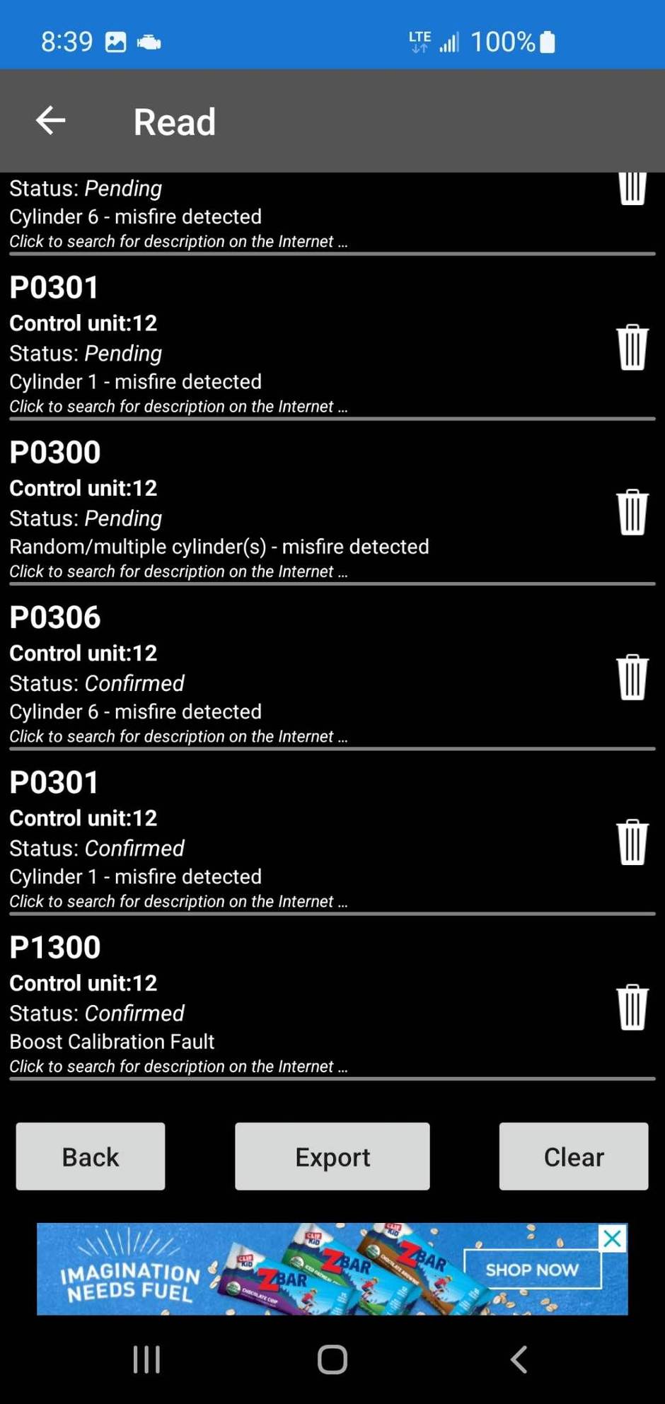

Thought I would be cute and splash my buddy who was filmingbmy shallow creek crossing. Not such a good idea.

Is yours a turbo diesel?
Probably not if there's a cylinder 6 misfire, the turbo diesels were only 5 cylinder models.
no it is not
Old May 25, 2023 | 11:10 AM
cerpindicular's Avatar
Joined: Apr 2023
Posts: 38
Its better now that it dried out but man did it run like crap after. The knock sensor is because someone cut the damn wire plug off it and removed the knock sensor itself.

@greisinb it was not the depth it was the speed, @cerpindicular going fast through water leads to problems. Check your coils, air filter and the area around the plug that are mis-firing you will likely find moisture. I have seen trucks literally die in the middle of water 6 inches deep just from going too fast, looks cool but not a good idea.
oh i know it was from me being an asshat and going fast. Just thought it was a little amusing. Havent had that problem really in long time. And that was in a old jeep with points.
