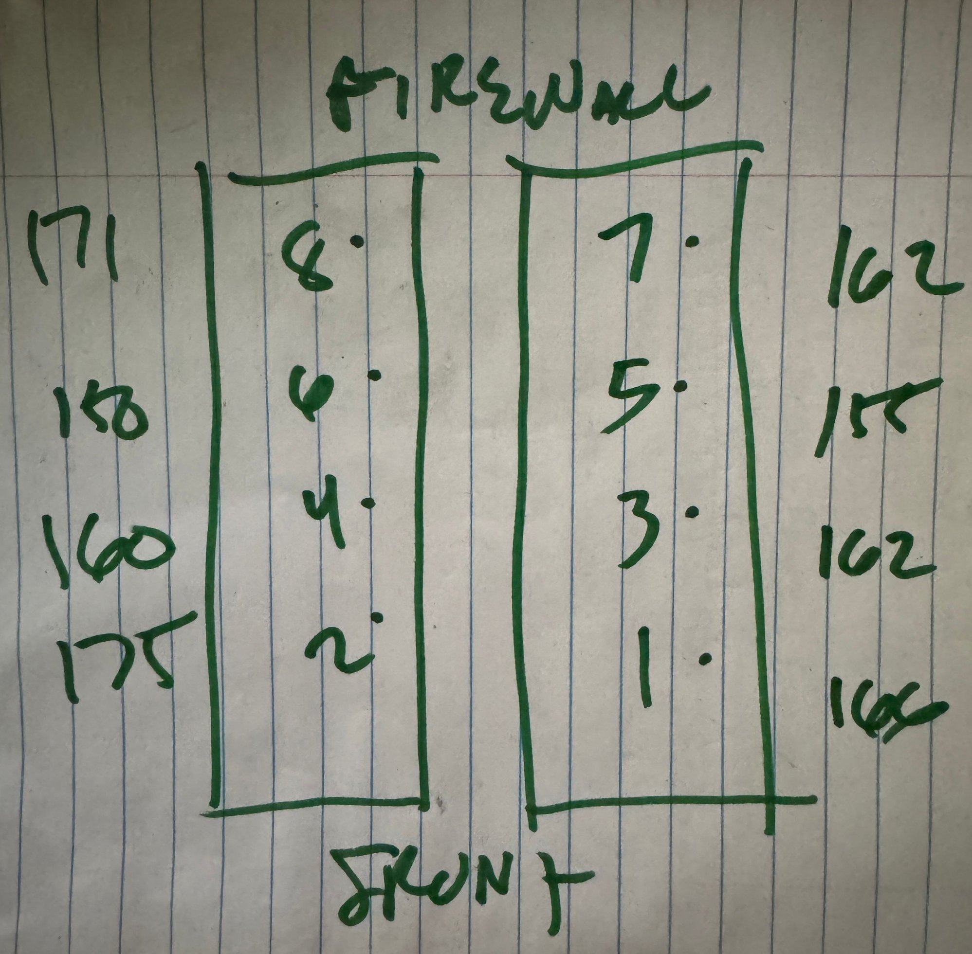

Does not hurt to cap all the vacuum lines as John Zo suggest. Although rarely would an engine overheat affect brake booster or other engine vacuum devices, but does not hurt to test.
compression looks good. I’m going to go ahead and replace the upper intake manifold gasket and the valley pan gasket. I think I just need those two gaskets plus the 2x ends gaskets to reseal the manifold?

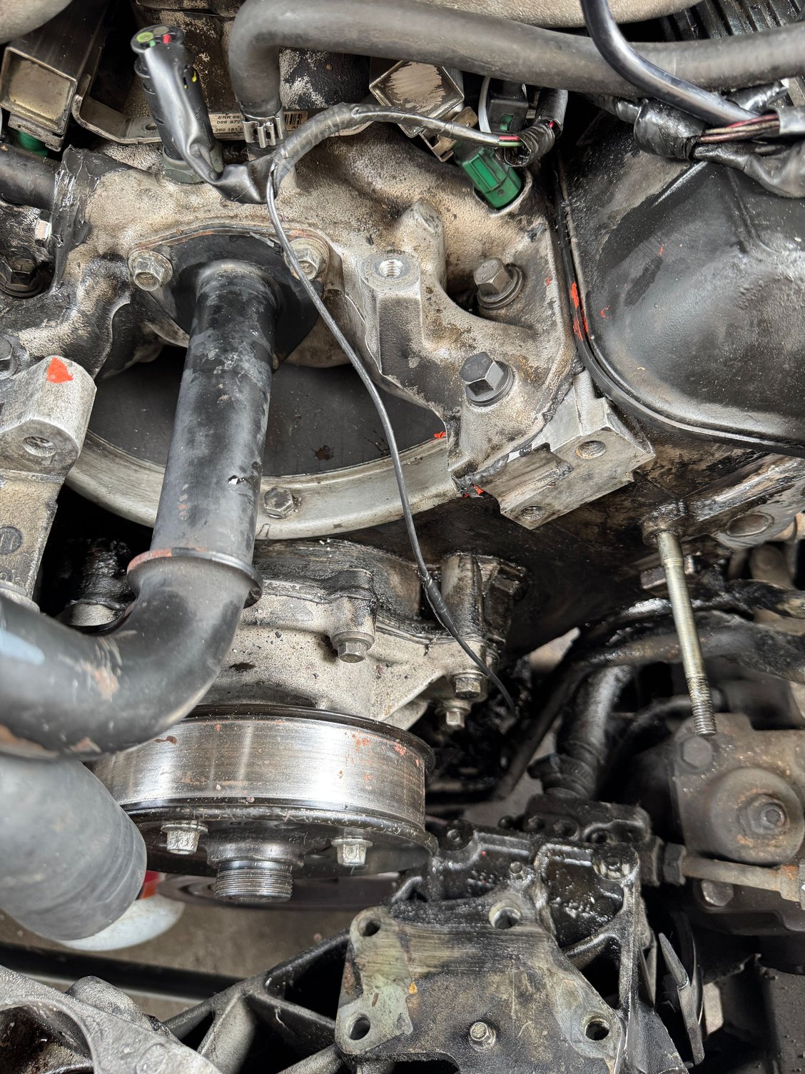

Anyone know what this wire is for and ends up going to? Branches off from the sensor on the manifold there and heads toward the drive lower crankcase , guessing maybe the crank sensor is the destination? It had break in the coating which i repaired and putting heat shield on, I got check this more tho.
The manifold gasket lower and upper have been serviced. I had two bolt threads on pass side stripped so the bolts were not holding tight, which i'm hoping was the culprit. That sensor wire shorting prob didn't help anything at all... lol
Thanks
