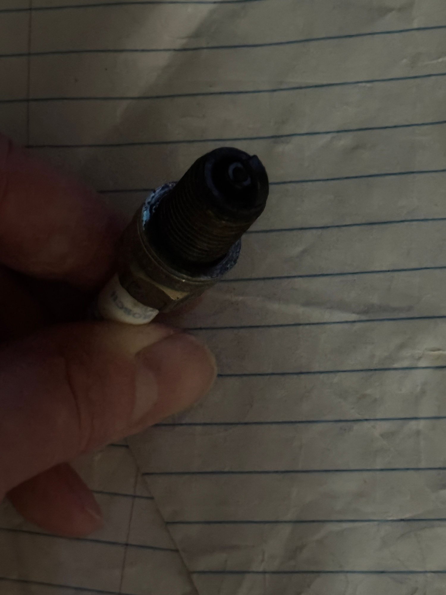

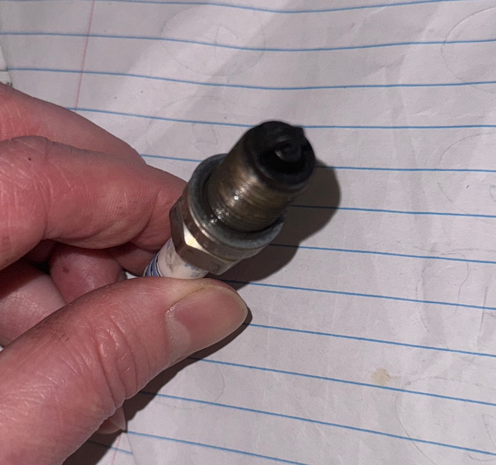

Thanks buddy - that’s helpful! The coil packs, wires were new just prior to the meltdown… I’ll go through check it all. I have my old coil packs and another set wires which are working I just tossed new stuff on so that will help test. Do you think the overheat can smoke cool packs and or wires? The plugs were also. They blacked out now. Pics aren’t great.

Could be ultra rich due to being so hot. Hotter temps, more fuel, may have reached rich limit.

Can you tell us the temperature range of your spark plugs, or the model number?
Bosch 8100 double platinum thanks
