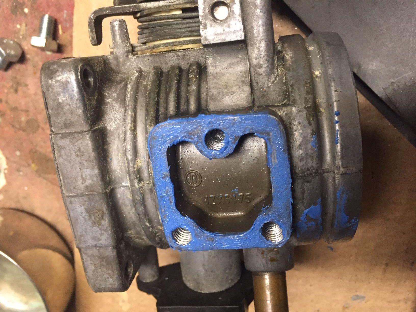

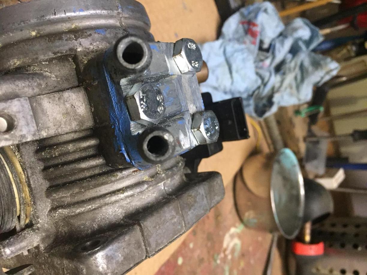

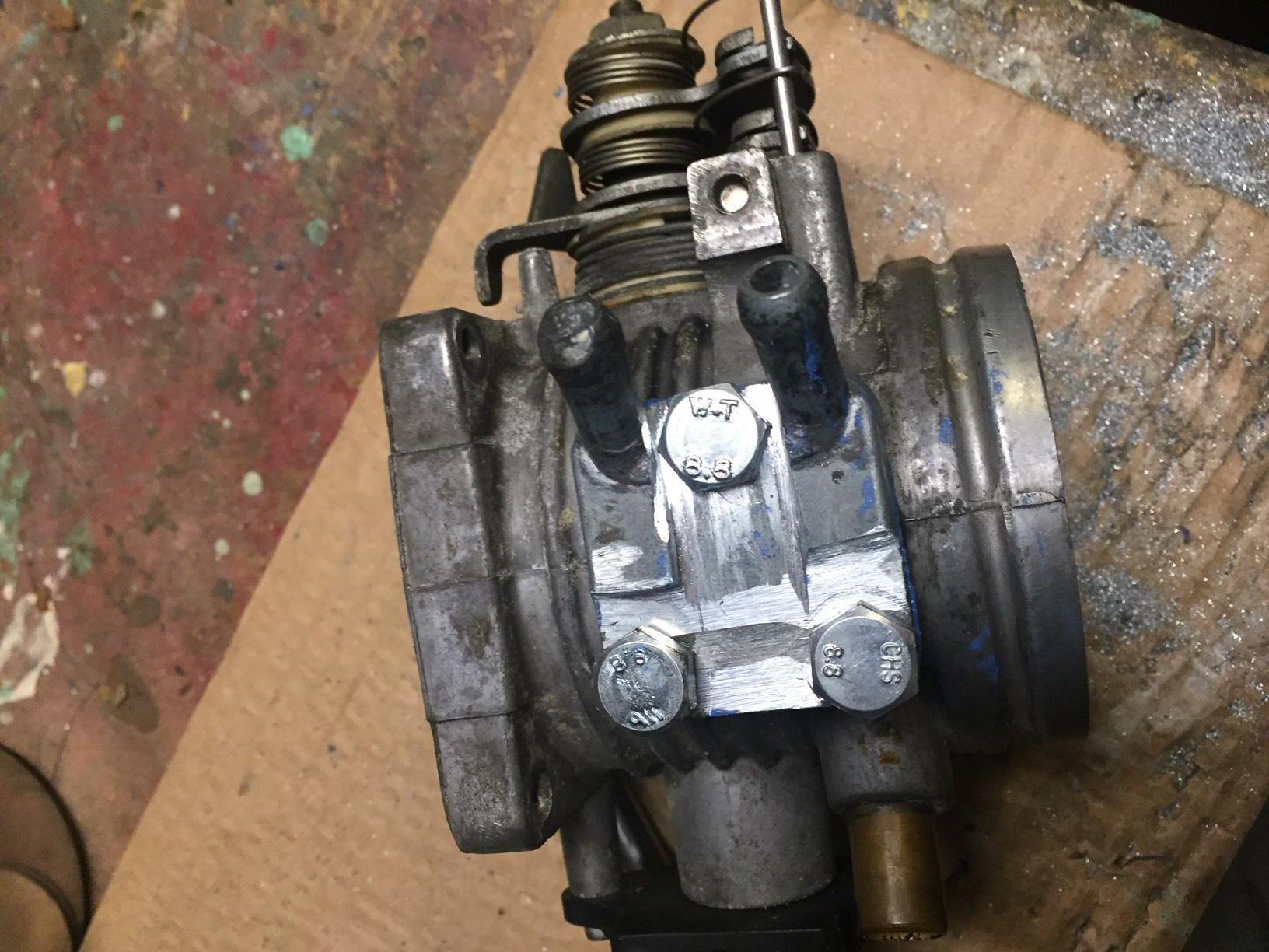

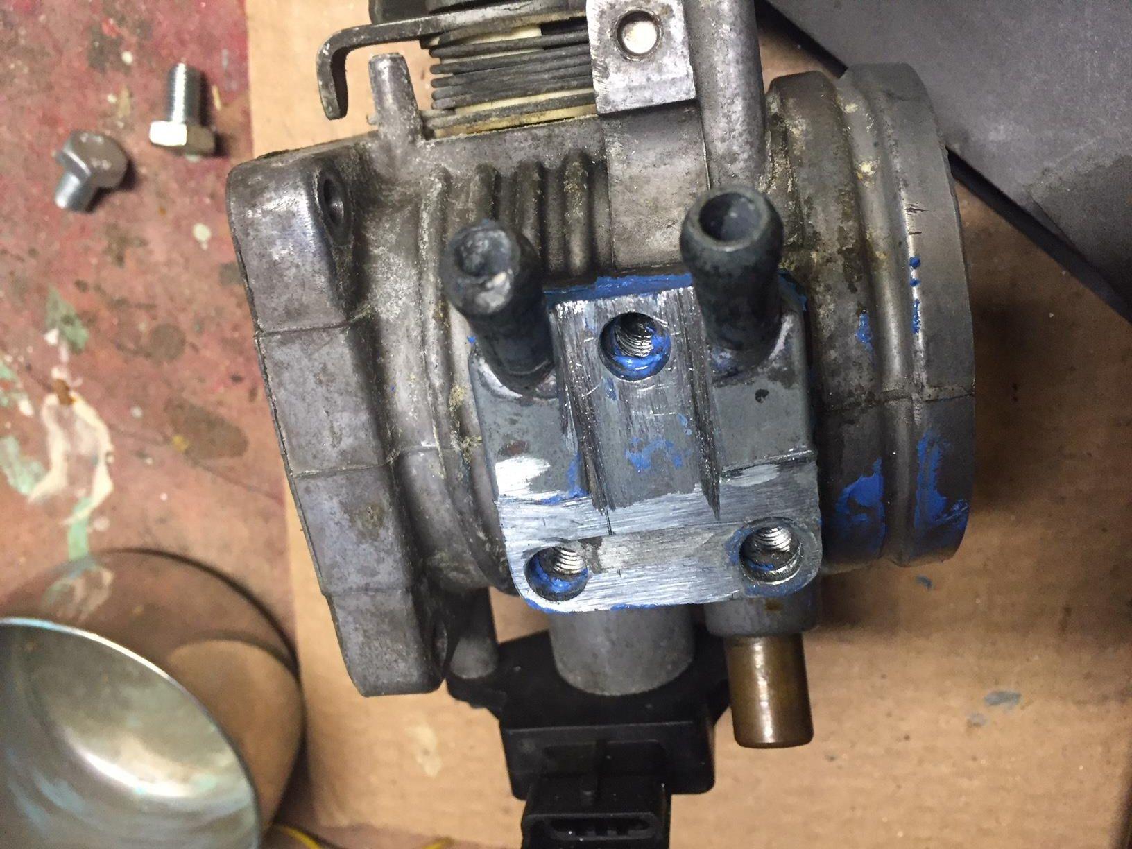

Old Jul 30, 2018 | 10:45 AM
hemicharger69's Avatar
Posts: 94
Leaky throttle heater plate has been on my annual maintenance list since I started owning my Disco 2.
This weekend, I did something to make this problem go away forever...(hopefully)
1. Retapped throttle body for 8 x 1.25mm bolts
2. Filed throttle body heater plate to accommodate larger bolts.
3. Blue RTV
4. New DIY gasket
5. Torqued 15-20 ft-lbs
Let's you see you leak now you son of a bitch!
