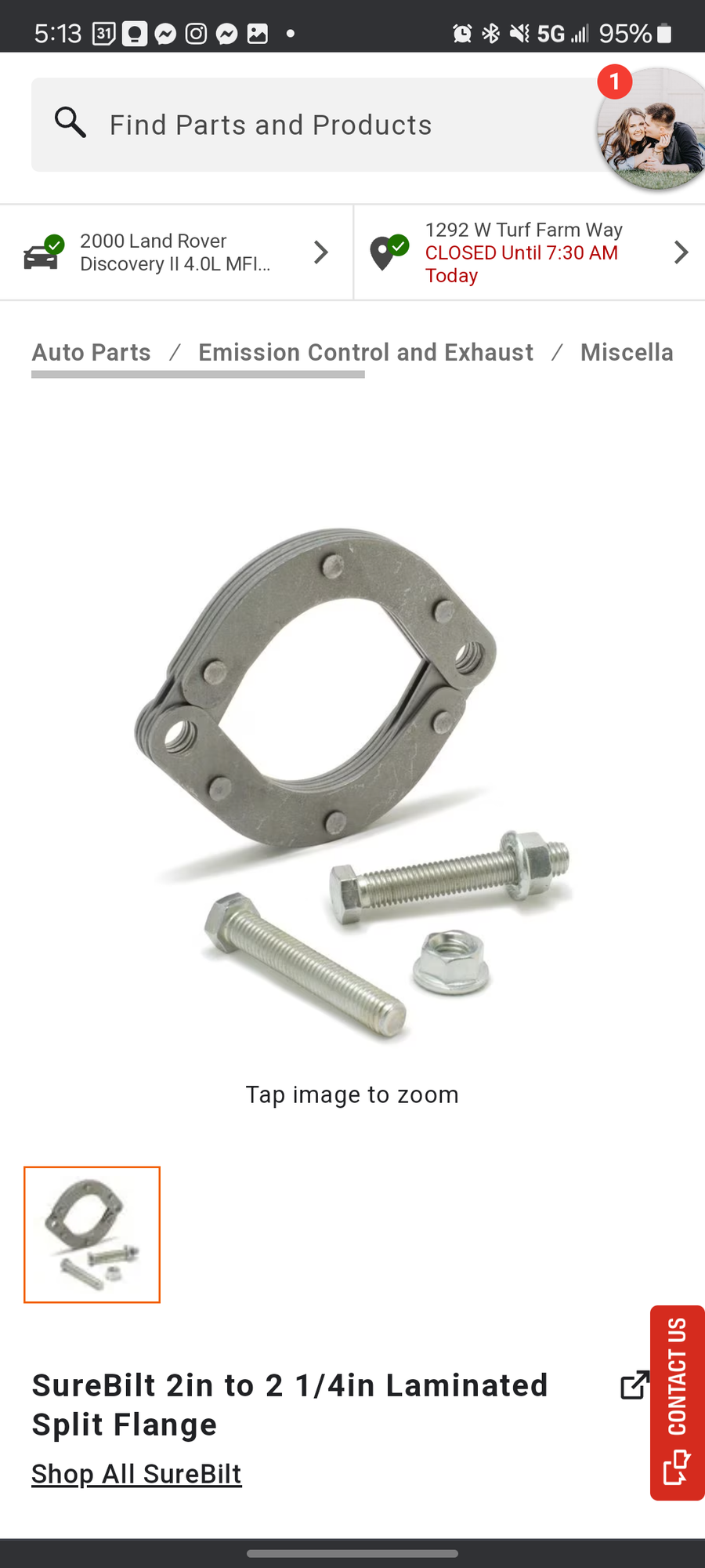

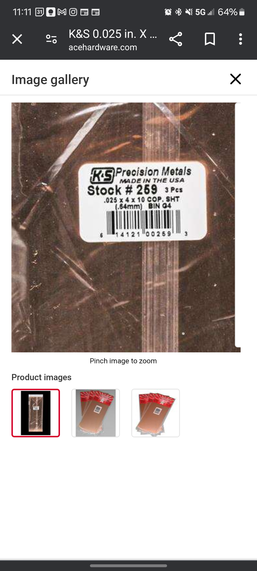

So I decided that I'll make some copper metal gaskets for the bottom of the exhaust manifold and the top of that cat. That way they are more moldable to the mounting surfaces and heat transparent. I feel the ones on there don't seal well because of the weird lip on the edge of the gasket. I'll also get an exhaust flange clamp from auto zone in hopes that I can bolt and seal them together more efficiently. Hopefully both of those things will help eliminate the exhaust leak that I have on both of them. Checked last night with soapy water while the car was running and there is definitely some leakage out from where the gasket meets. Do you guys think that is a good idea? Any other thoughts on what I can do?
