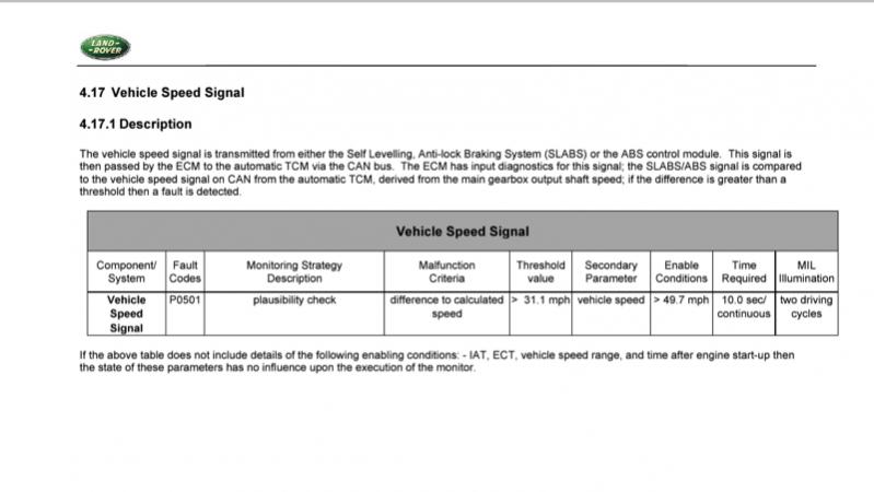

Alright you guys I'm still stumped here because pending code P0501 has not returned in weeks! Driving habits are the same, same distances driven to and from work, same errands each week and same hills. I have a theory that engaging the high/low triggers pending code P0501. I think back to each time that code came on and it was always shortly after playing with the high/low. I noted recently on here that I'm unable to engage the CDL and that the linkage seems rough to shift for the high low. Recently I sprayed some DW40 lub all over the linkage. Helped free up the high low but not the CDL. Does my theory make any sense or do you think its purely a coincidence that the code has not been triggered lately despite me not using the high low shifter at all?
Also regarding that other pending code I had P1171. The big hose that connects the engine airbox to the engine was very lose and the airbox clamps were not secure.... dont know why but I tightened everything firmly and now I wait. I think that was the problem though.
Old Dec 1, 2013 | 05:41 PM
jafir's Avatar
Joined: Nov 2009
Posts: 5,847
Likes: 106
From: Arkansas
This code, according to the manuals means that the slabs speed signal and the transmission speed signal that comes from the tcm don't match.
The tcm is under the drivers seat. Might check for corrosion or something? Slabs is under the glove box area. I'm not sure exactly where the transmission speed sensor is, but that is what the tcm uses for it's number.
