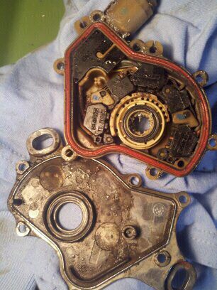

XYZ switch could be full of mud, can remove and open up, clean out, re-seal

I pulled XYZ and opened. Looked fine. Lubed with wheel with a light coat of white lithium grease and sealed with silicone on both sides of gasket. No change. Broke down battery contacts and reinstalled. No change. I need to get this thing started so i can continue with my list.

It looked nothing like this. As far as I could tell no water or mud made it in. Trans control module, now thats a different story. Replaced.
