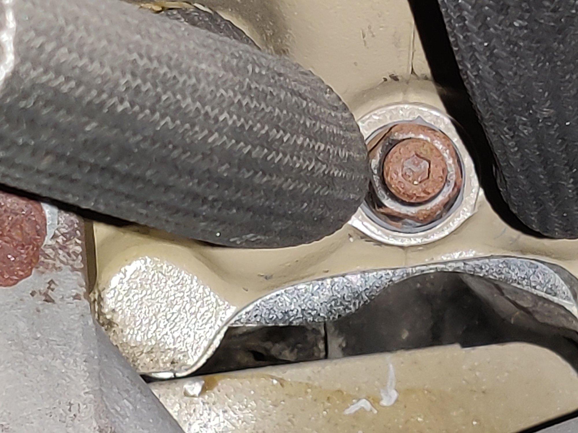

@Extinct here is a pic of my Cometic head gasket. Does yours look like this?
Here is a pic of my spark plugs, had a lot of carbon on it, it is an NGK Iridium cleaned it off with brake kleen and will reinstall then fire up and see if it makes a difference.

I have never used the Cometics, but they all stick out a little.
My fault, I thought you were the poster who turned me on to them. I will have to revisit my messages. Thanks for the thought though.
