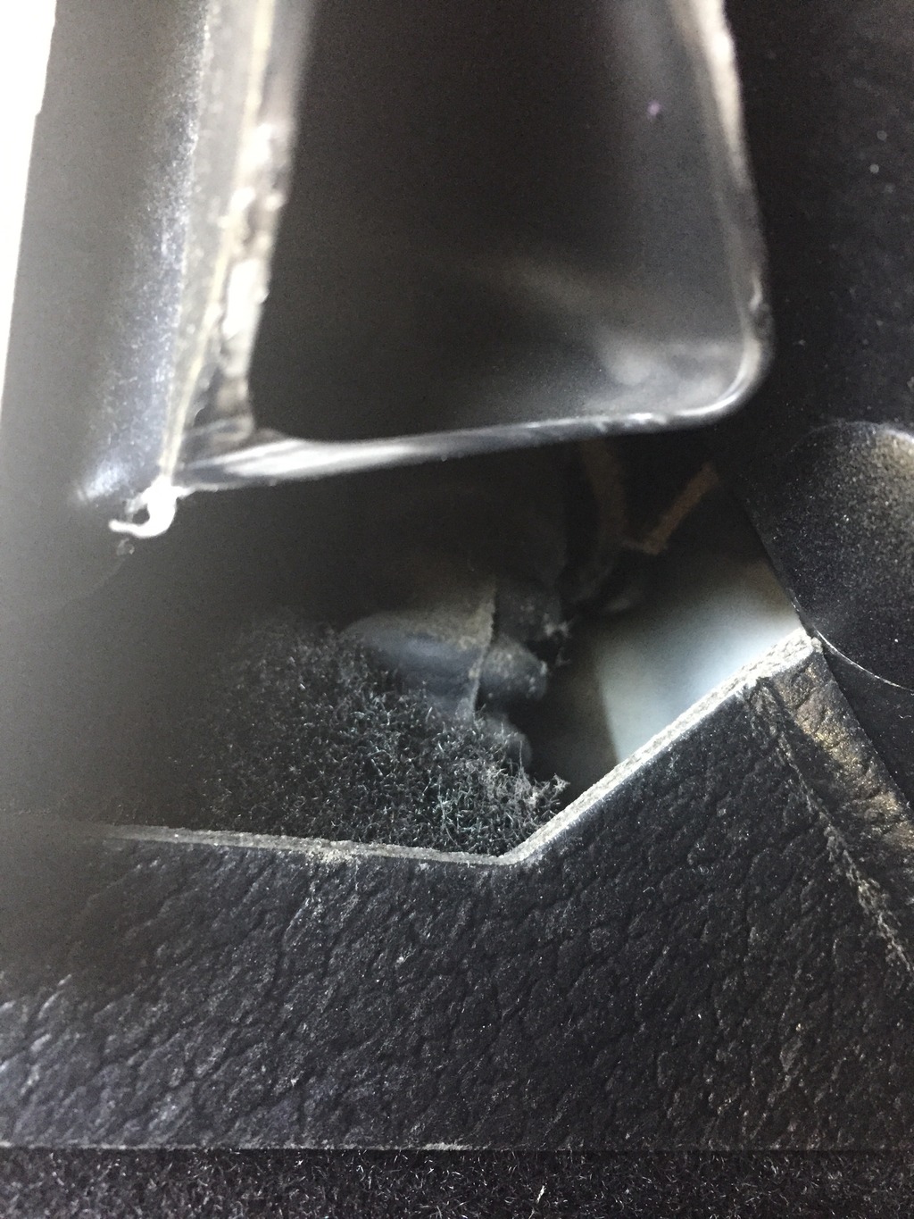

Old Apr 5, 2015 | 12:41 PM
abran's Avatar
Posts: 6,900
Likes: 789
From: Huntington Beach CA

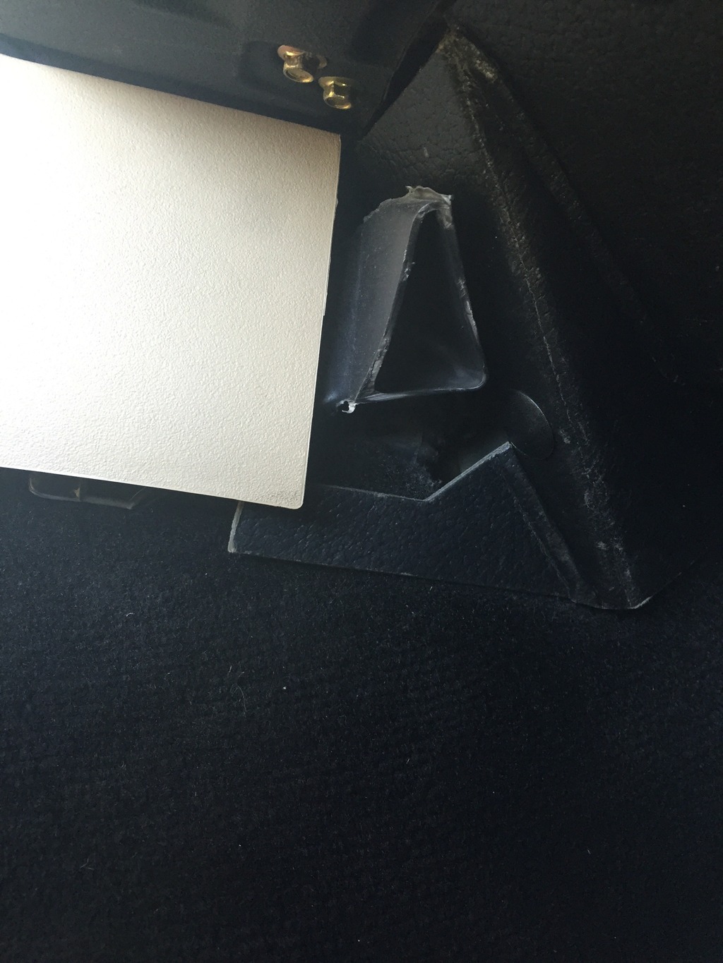

Old Apr 5, 2015 | 12:43 PM
abran's Avatar
Posts: 6,900
Likes: 789
There it is tucked back at the meeting point of the vent opening, under dash panel, and center console.

Old Apr 5, 2015 | 09:04 PM
cybercop's Avatar
Joined: Dec 2008
Posts: 1,025
Likes: 38
From: North Georgia
Thanks Abran. I found those. Very soft and squishy rubber material.
How do you make sure they are sealed or fitted without taking the dash apart?
