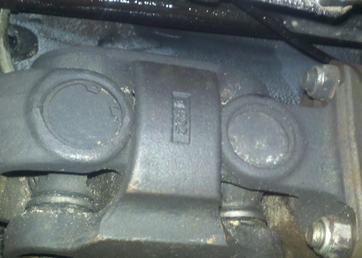

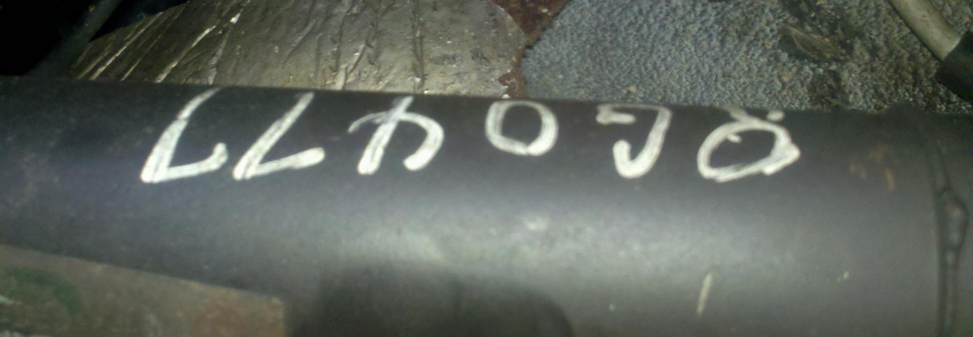

Here are some pics of my front drive shaft. I am not versed in all things disco yet. Can anyone tell me if it is rebuilt or should I race out and find one. There is a busted *** beat up land rover sticker in the middle and some white writing in the middle. If anyone needs a different pic please let me know. And thank you in advance!!!

It is not possible to tell from the photos, look at the double cardan end if any of the u joints have grease nipples. If not then they need to be replaced, if they do then they need to be greased. The single u joint has a grease nipple, that is stock.

It looks stock to me but you can only see the two sides of the joint. If the other sides of the joints look the same and there are no nipples then it has not been rebuilt. The u joints with the nipple look like this.

Alright I will look at the other sides to see if there is a nipple. If not, should I buy a rebuilt shaft or is it a do it yourself kind of project. I have gone up in tire sizes and do not want to do any damage.
