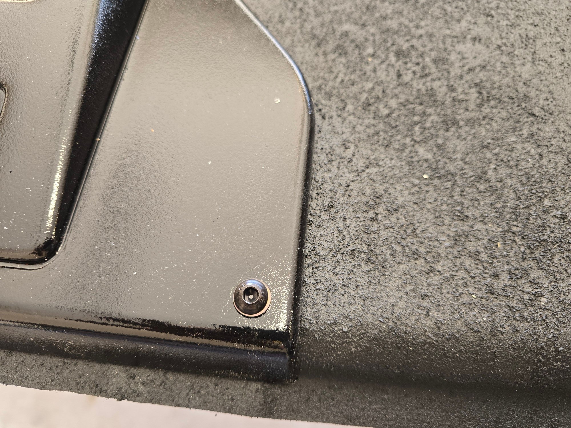

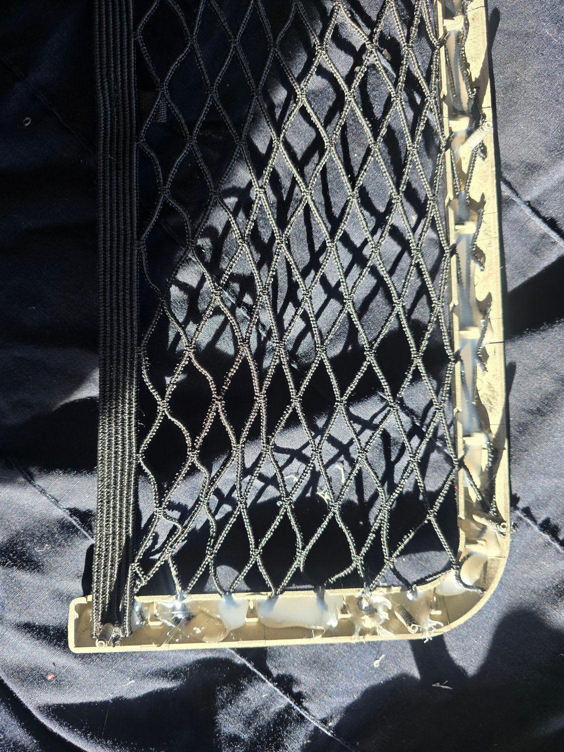

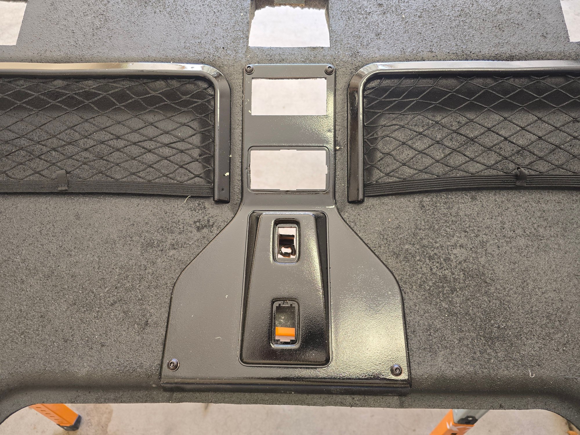

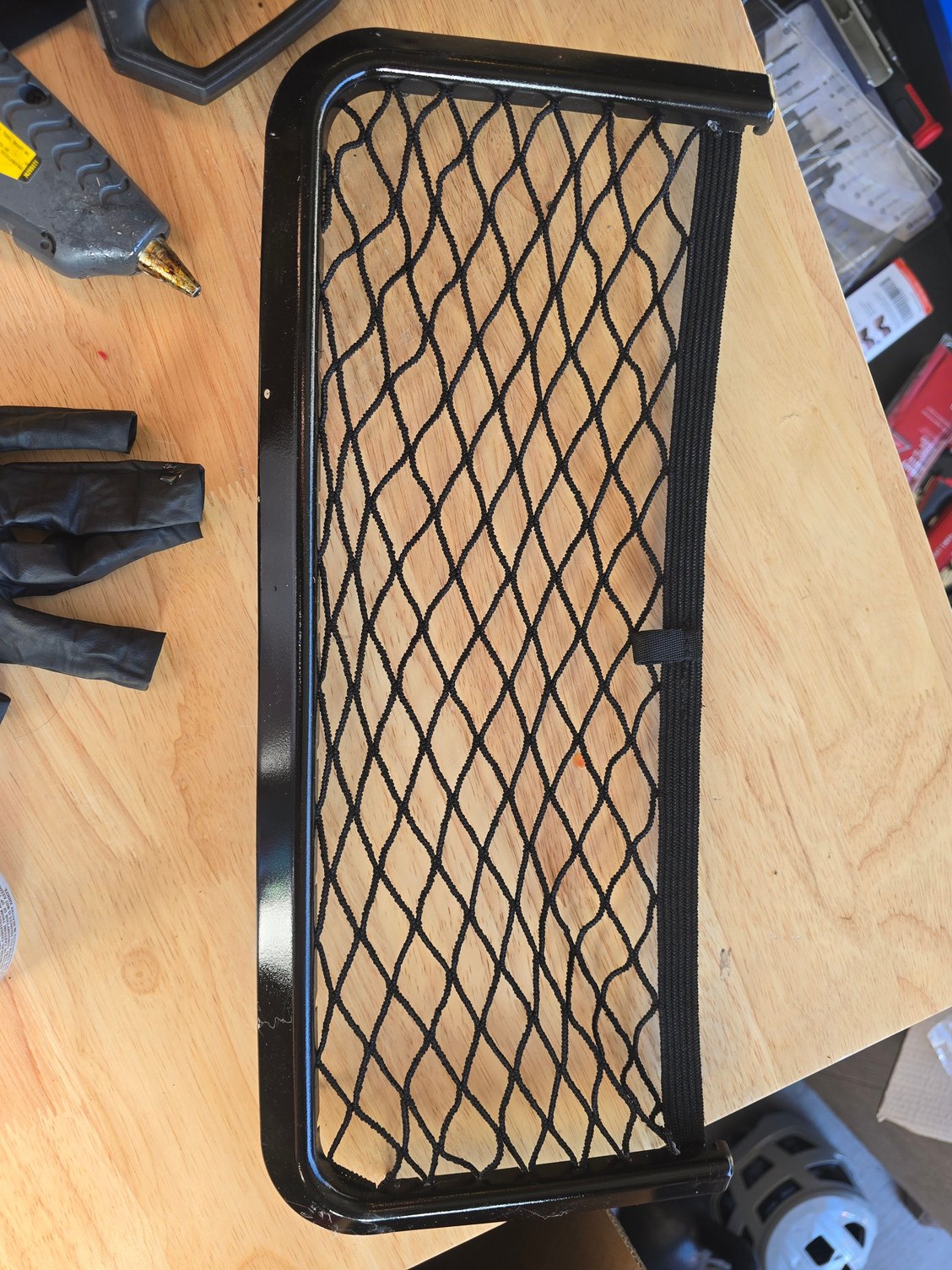

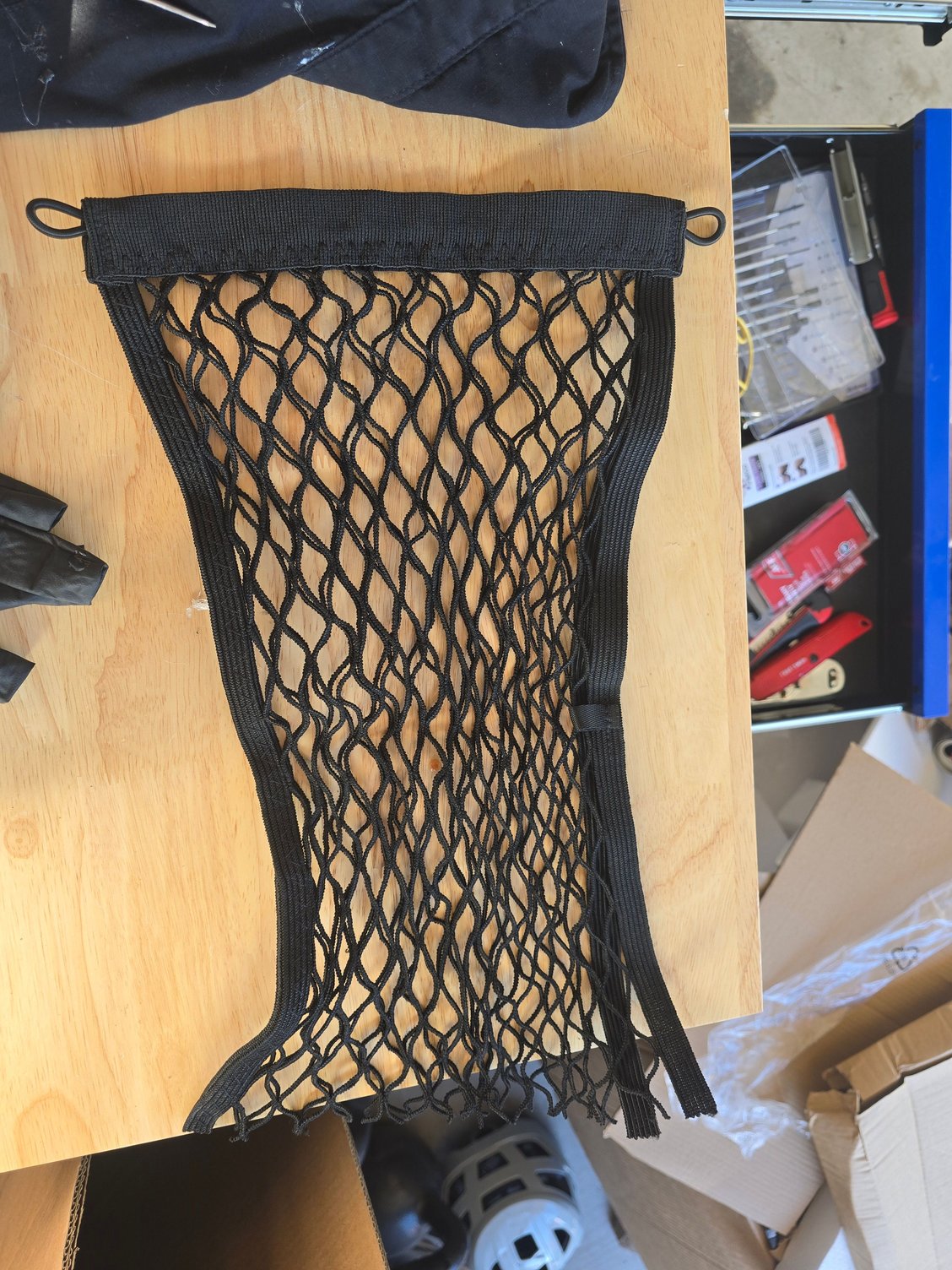

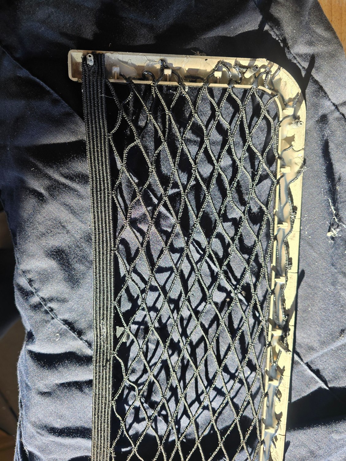

Several of the plastic studs on the backside of the headliner trim pieces snapped off during their removal/install, so I drilled holes and added through bolts to secure the trim pieces.
Also, the elastic nets for the map holders were worn out. I purchased these replacement black nets from Amazon and retrofitted them. They required cutting and hot glue to retrofit.
It bugs me that the one main elastic strip of the netting on one side is slightly curved, but that's my fault for stretching that net too tight. The asymmetrical appearance is irritating, but I still consider it an upgrade.
