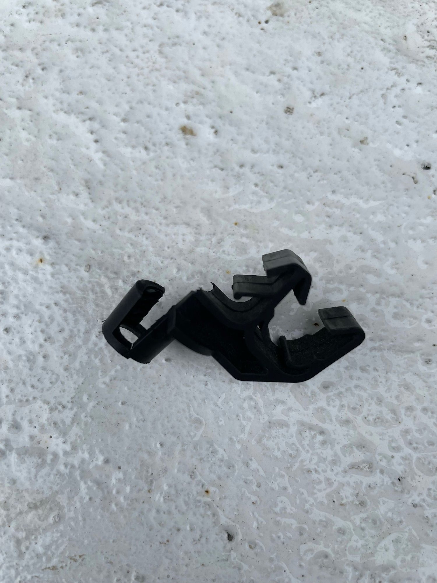

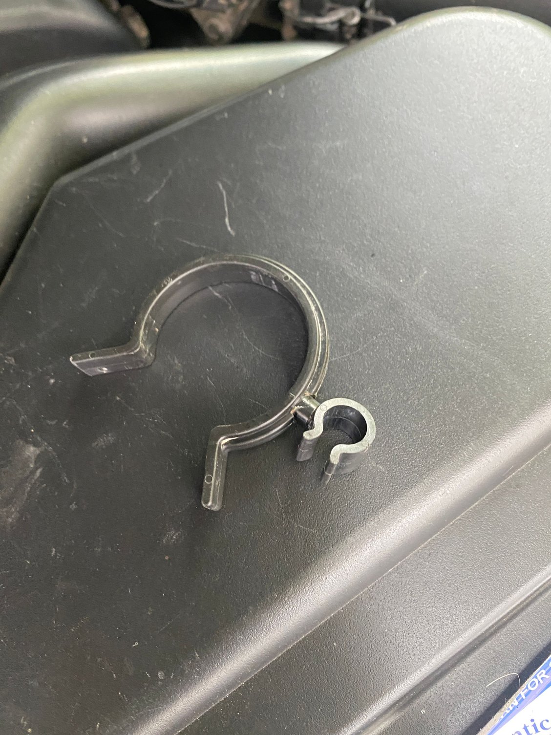

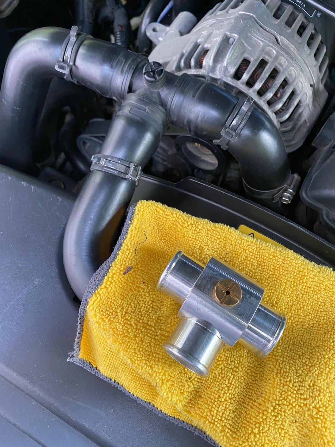

Was redoing my throttle body heater, cleaning throttle body, fitting a metal T bleed valve and replacing the octopus of little plastic SAI plastic tubes. Success on the project, however, I have this little plastic clip left over and I can’t figure out what or where it goes. I thought it was somewhere by the brake master cylinder area. Could be wrong. Anyone know? TIA

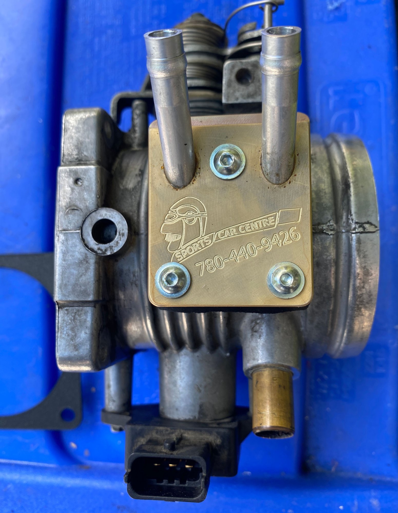

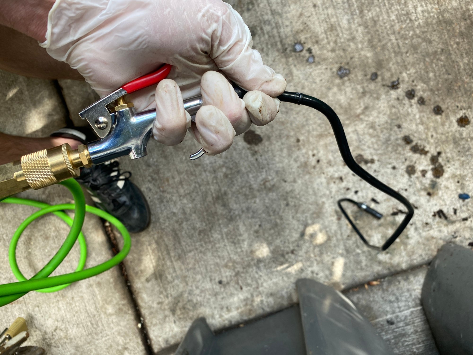

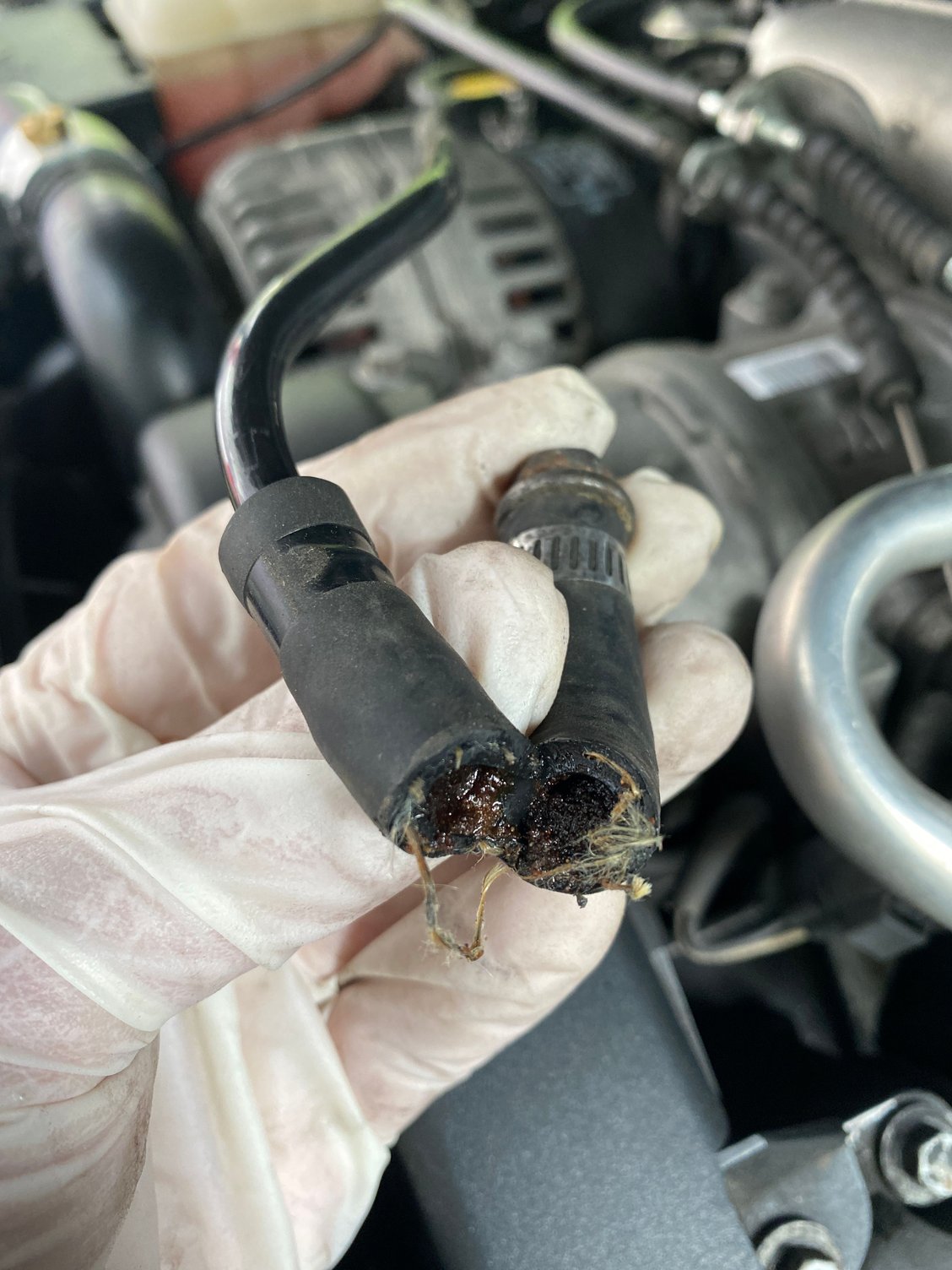

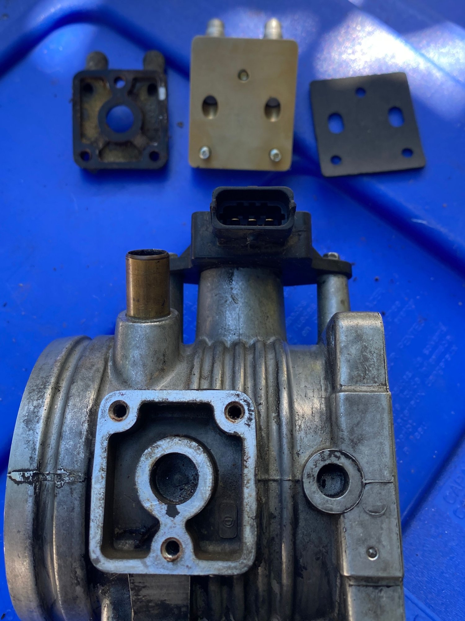

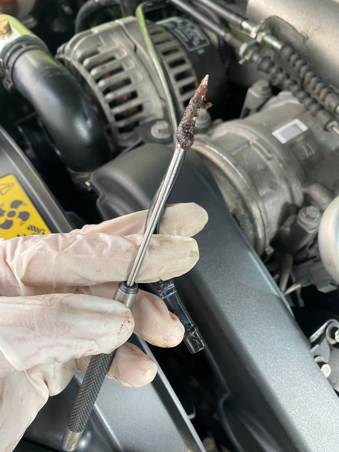

And some project pics. The throttle heater has been bypassed since I have had the Disco... bolts in the end of the hoses (ie “dead ends”. Look at the gunk in there ... this was in the return hose to the coolant reservoir tank. Dexcool yup.

That plastic clip rest on the IAC motor and the Throttle Body Cable then clips into it

AH. you sir, are a prince!

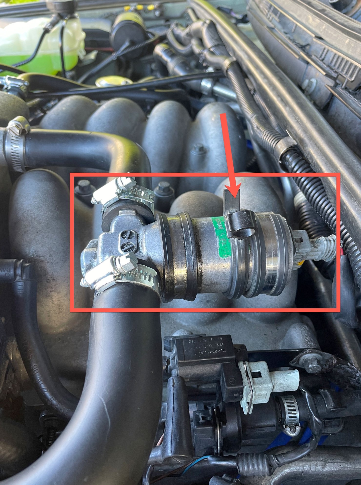

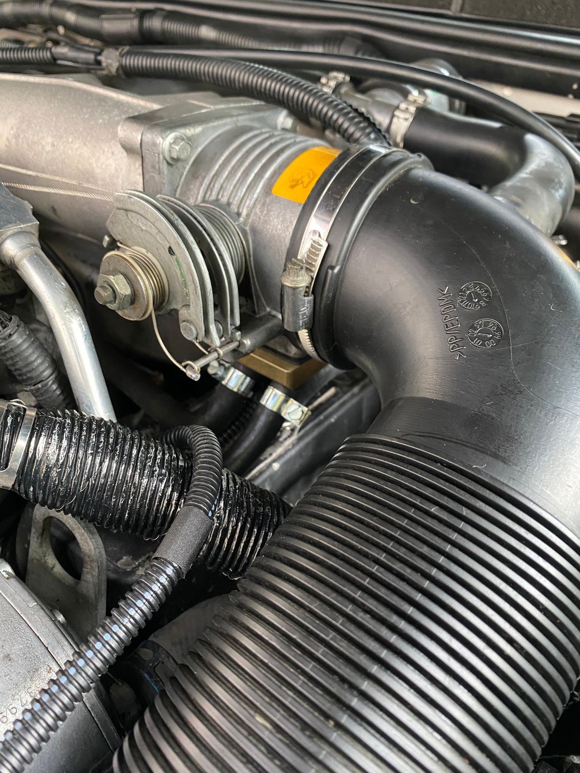

And for those of us who have no idea what the IAC motor is....a photo.
Apparently I managed to reroute whatever it originally held.

Thanks for the pic was wondering. I found the same clip in middle of my engine after some work was done.

I also could use some help knowing right location for this clip.
EDIT: Ehhh...actually doesn't look like what I was thinking.
It's a rubber grommet that goes over the u-latch on your back gate. At least that's what it looks like to me.

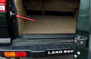

yeah that clip was hanging off the throttle body cable. But you never know!
