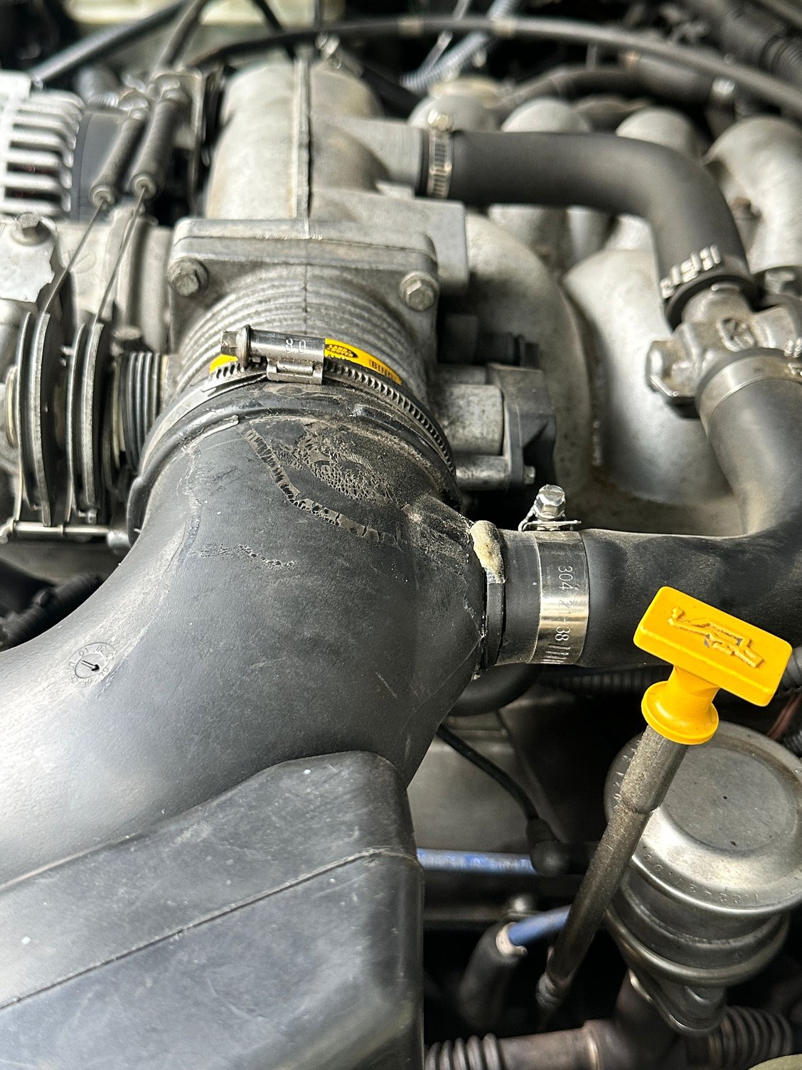

I think I found the issue. PO used epoxy to repair a crack in the air outlet tube coming off the MAF, it got crusty and started flaking off, allowing air to escape under high engine load. I removed more of it to test if it made it worse while accelerating, and it did. I just covered it in RTV silicone and covered that in epoxy, & will retest once dry, & will replace with an undamaged one I can find online. If anyone has one they want to offload, I’m a buyer.

Well, that wasn’t it. You can hear the whoosh sound in the video when it hits ~45mph. It’s much louder with the window open, but the wind was too loud on video. Any ideas? Again, it only happens at ~3200 rpm at any speed.
