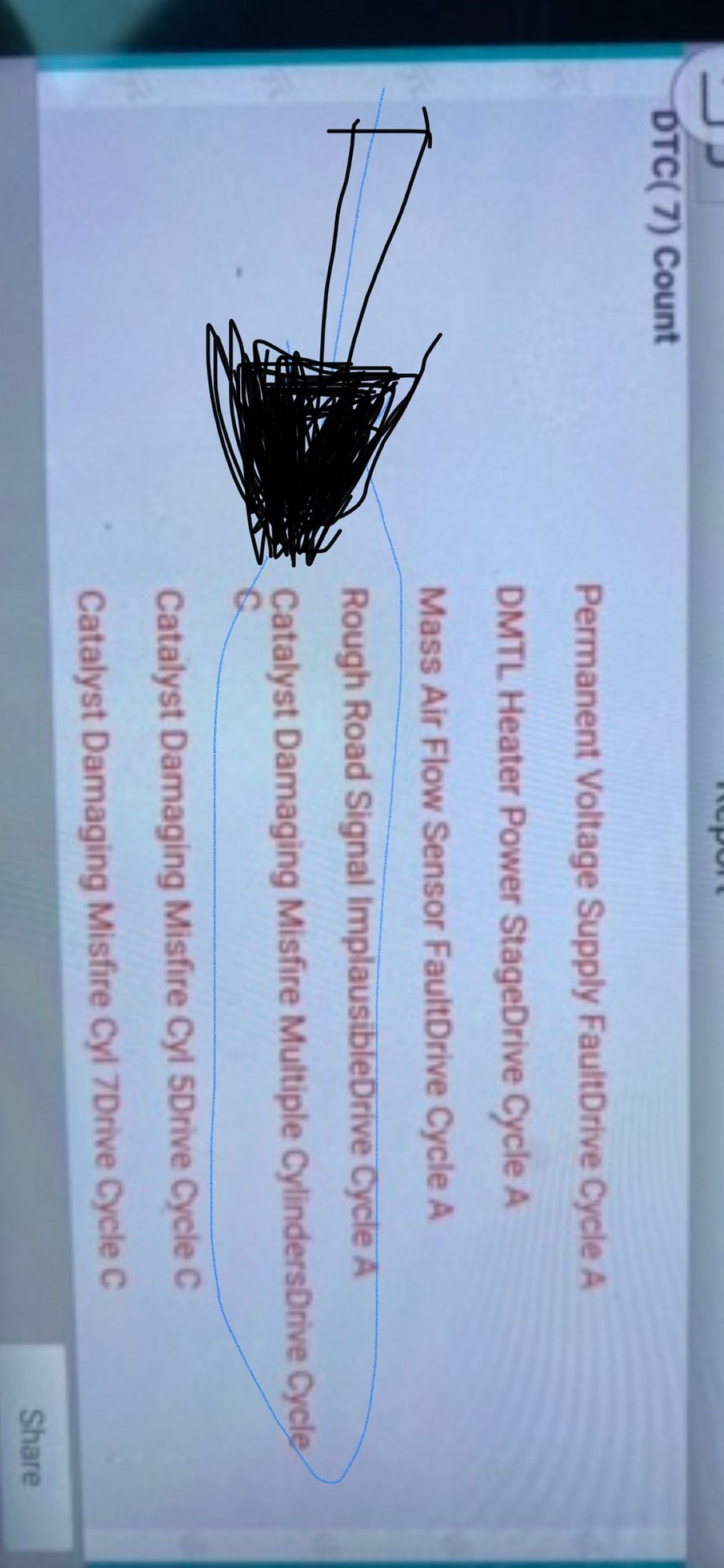

My 2002 Discovery 2 started to have very poor idle and stalling about month ago. Engine does not get overheat. With the help from redrover and fery, I was able to get a diagnostic report on the condition of the engine. See attached report for your review.
Please let me know what you think. I need all the help I can get to have it back on the road again

Most of those are generic fault codes that aren't providing much detail except for telling you that you have misfires. The "Rough Road Signal Implausible" is often caused by wheel speed sensor issues, so that's not the cause of your misfires.

Major concern: as pointed out by Redrover, two catalyst damaging misfire (indicated on the diagnostic report) on two adjacent cylinders could be a head gasket problem? eventhough engine is not overheating at this time?

You have two separate things going on there. The rough road signal is part of three amigos. Unplug the maf and see if 5&7 go away. If not, swap the plugs on 5&& with 1&3. If it does not follow, swap the plug wires with 8 and 6. If that does not cause it to move, swap coils left to right.
I think you likely have bad maf AND bad plug wires.
