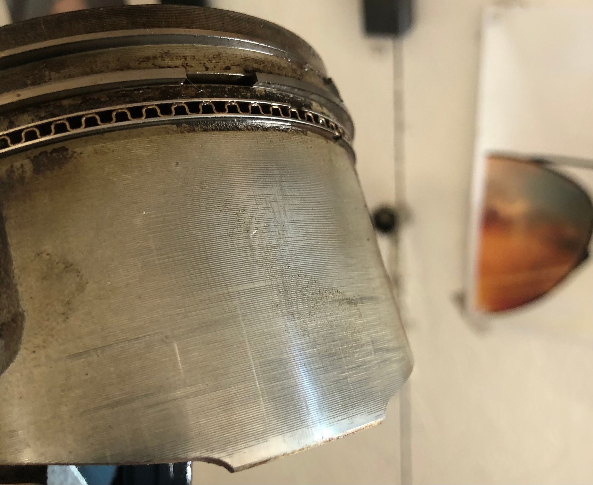

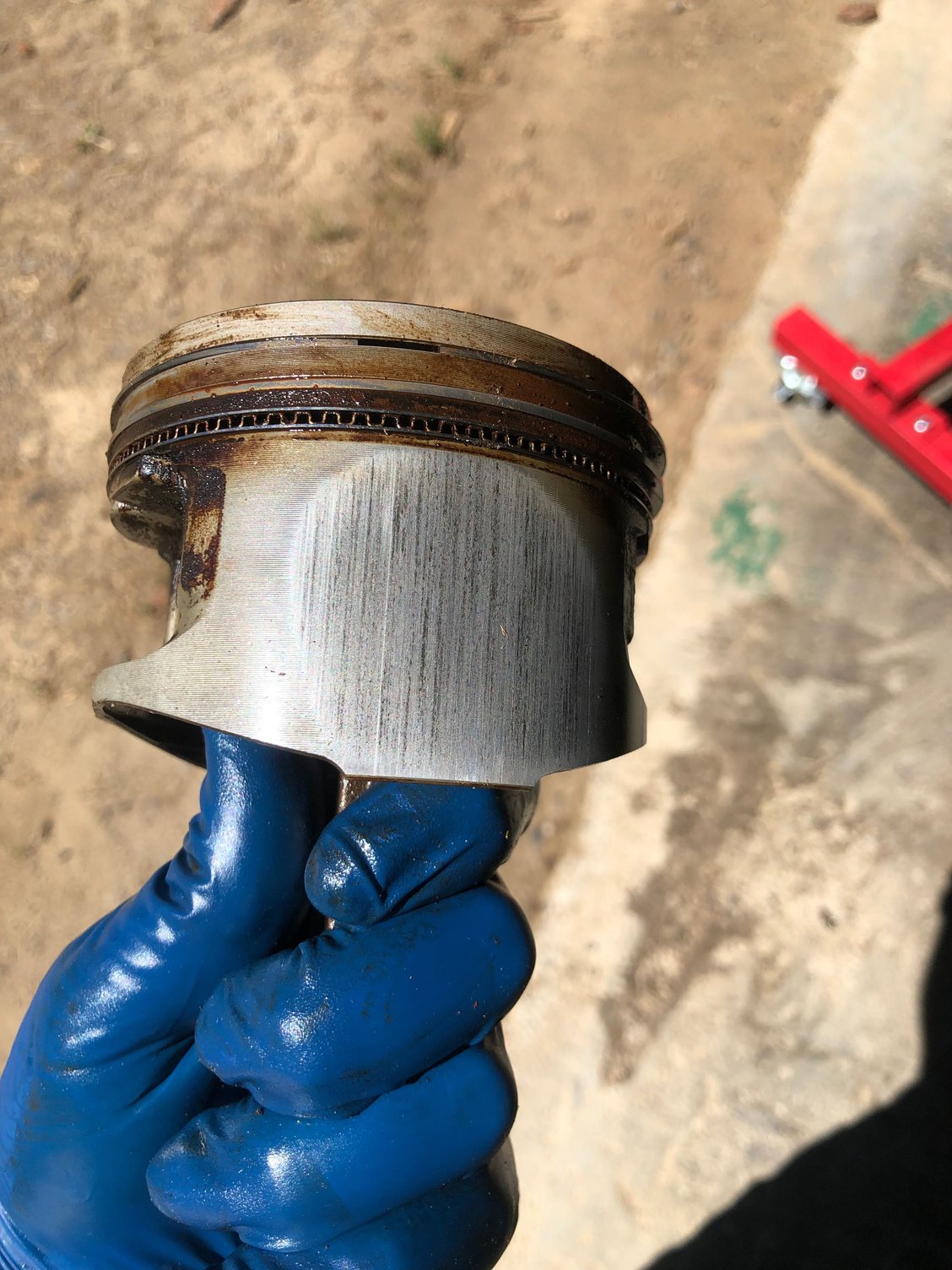

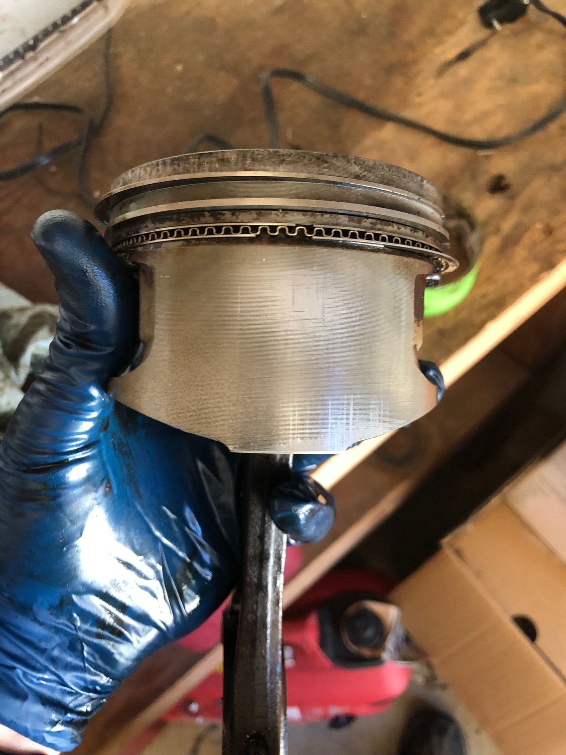

I got the pistons out today and here are some photos:
(i put text description between each image that may be easy to miss)

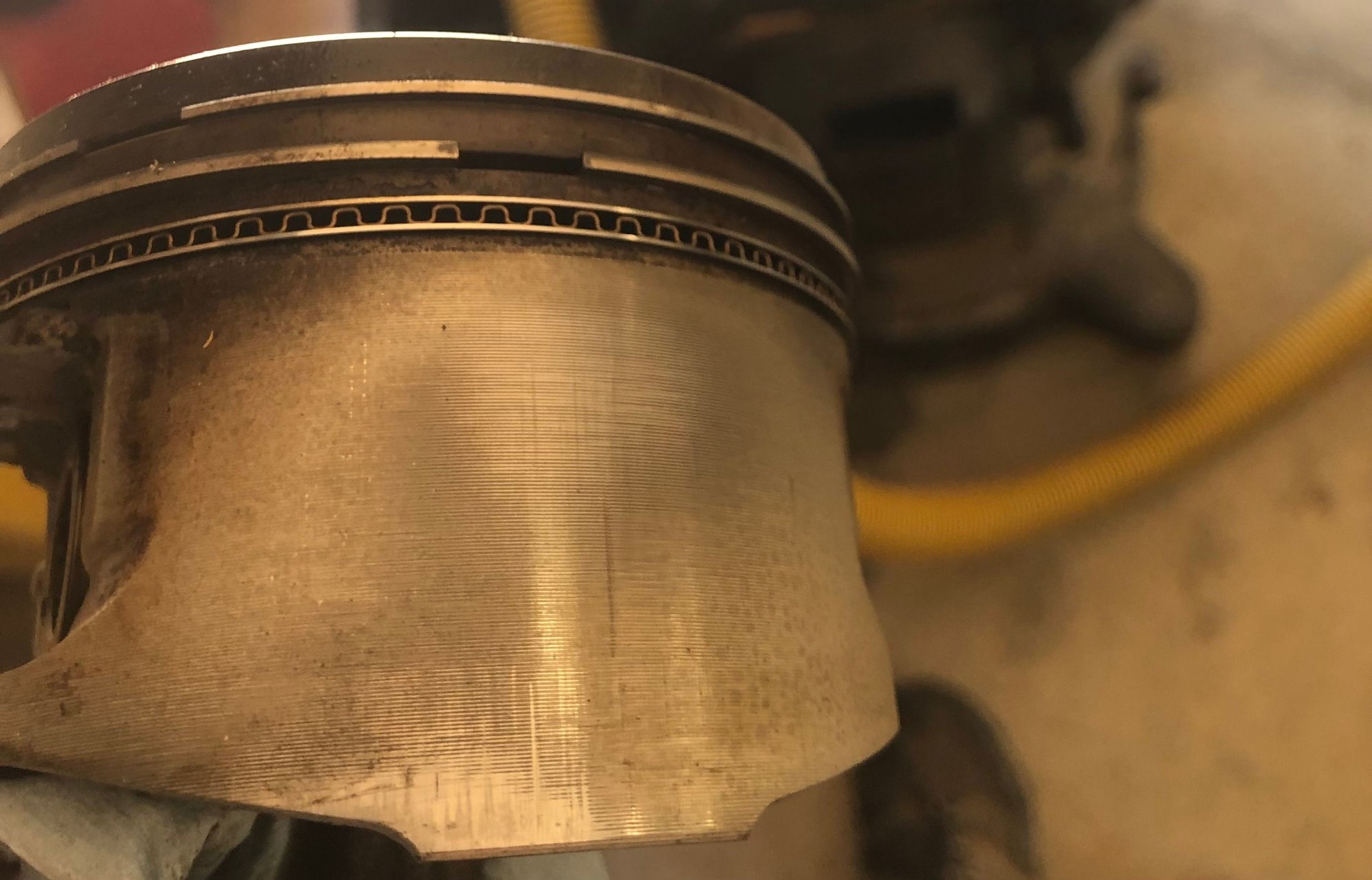

The next two photos are of different sides of one piston. I think there were 1 or 2 that looked like this.
The rest looked like this one.

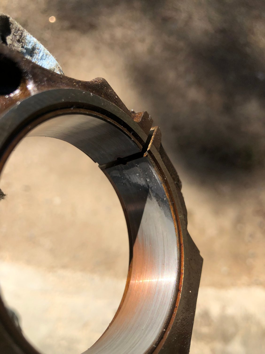

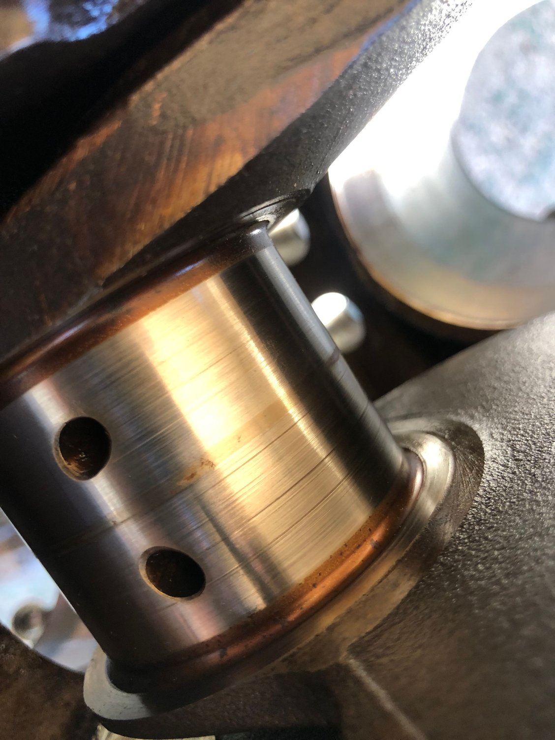

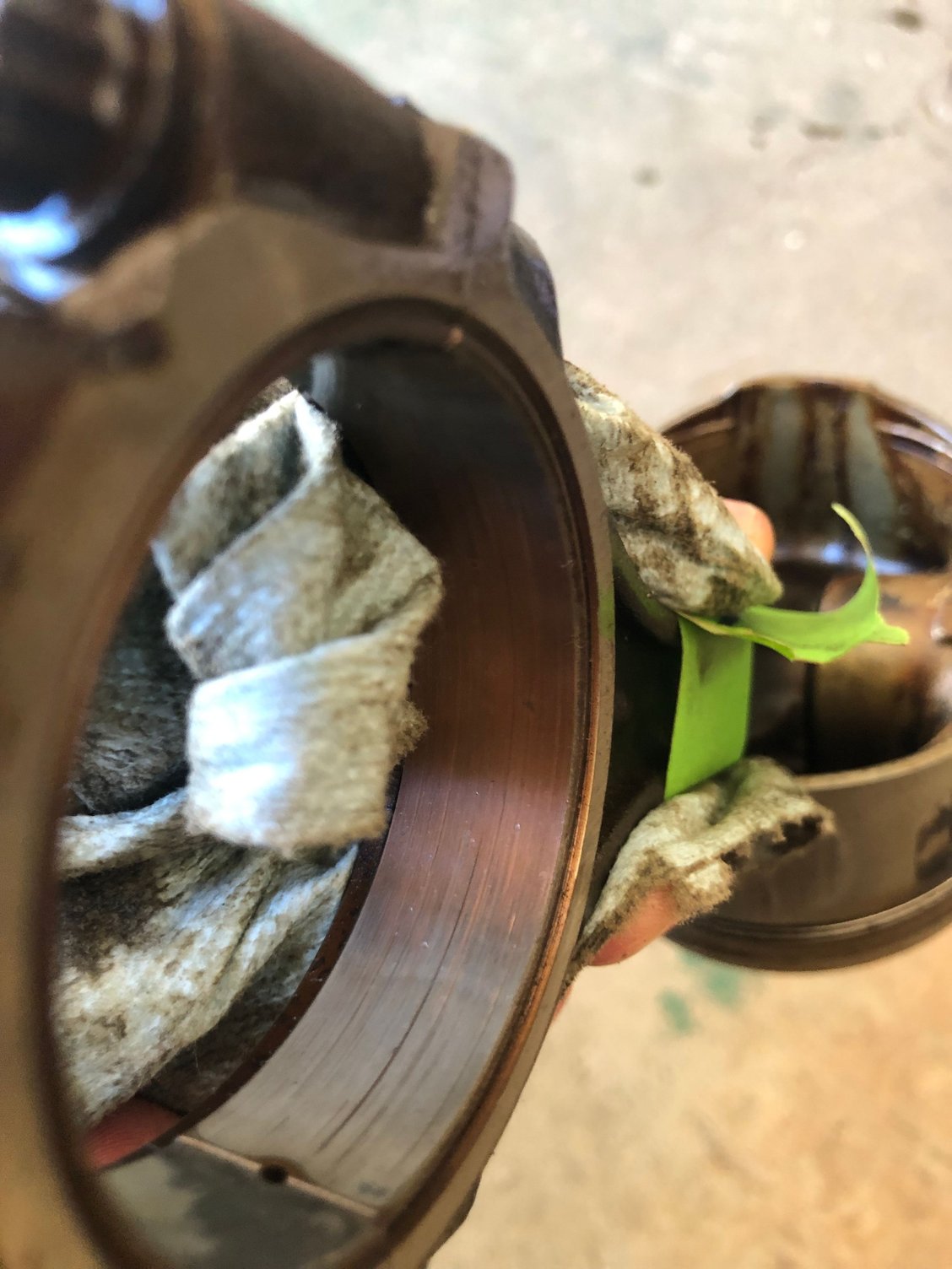

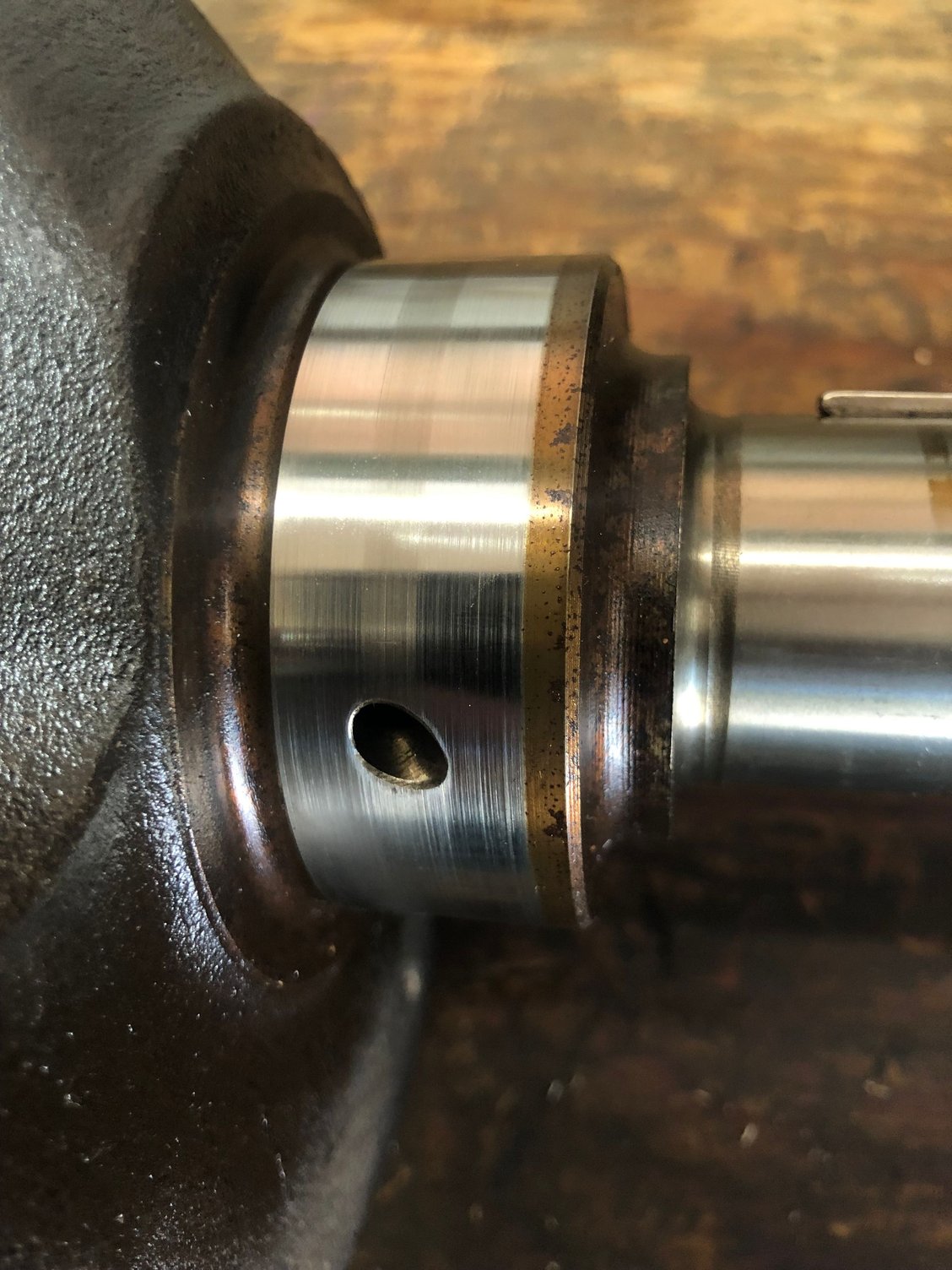

Where the right con rod connects was the worst looking part of the crank, and the rest look similar to the left side.

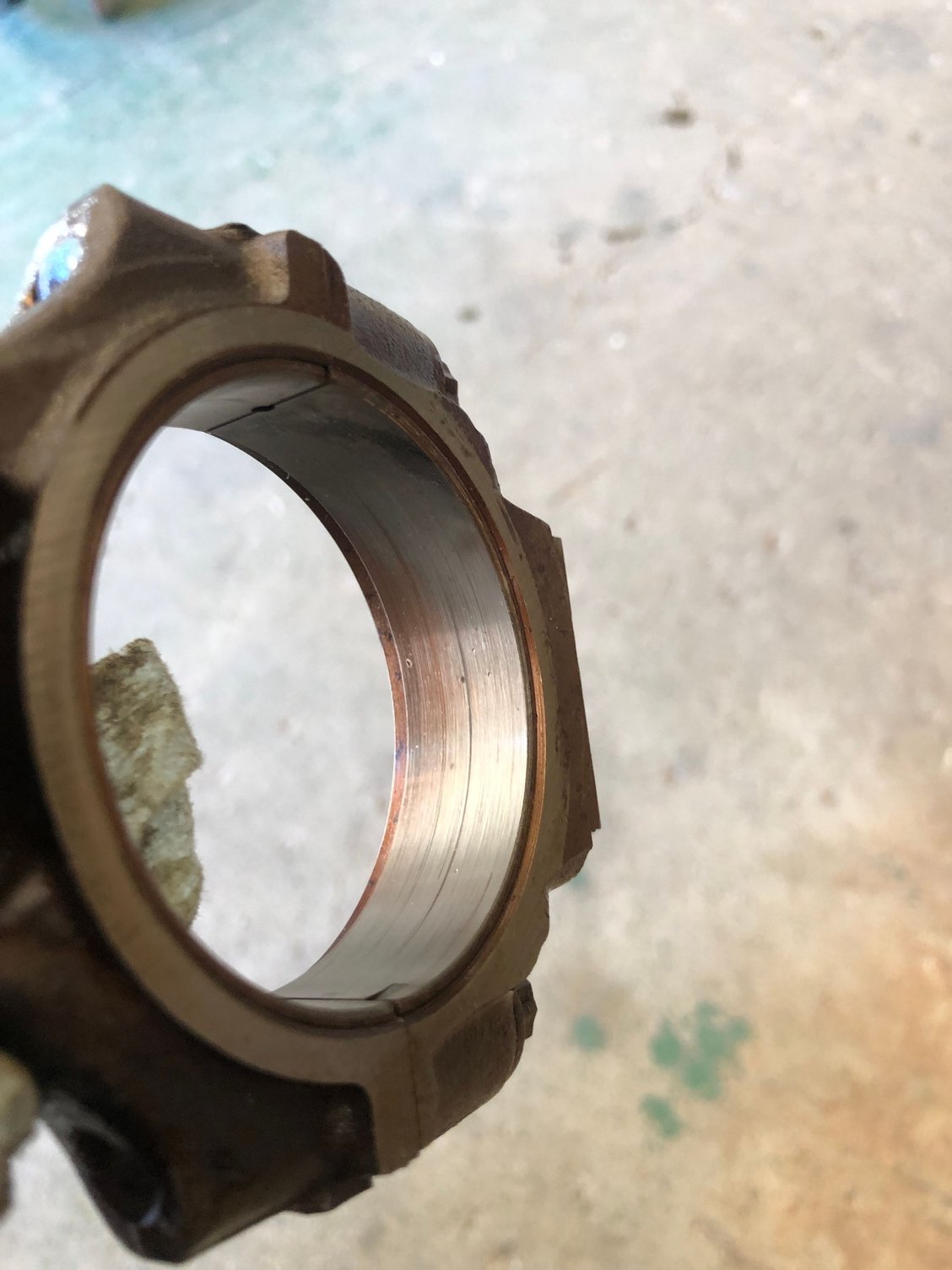

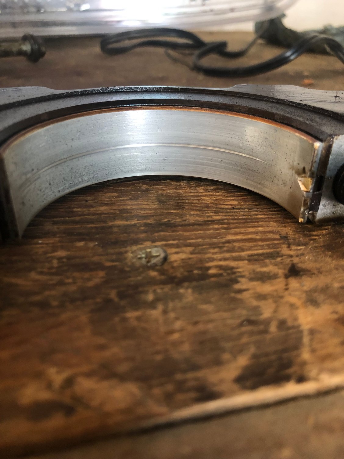

The next two are the bearings on that right side.
While the rest looked more similar to this.

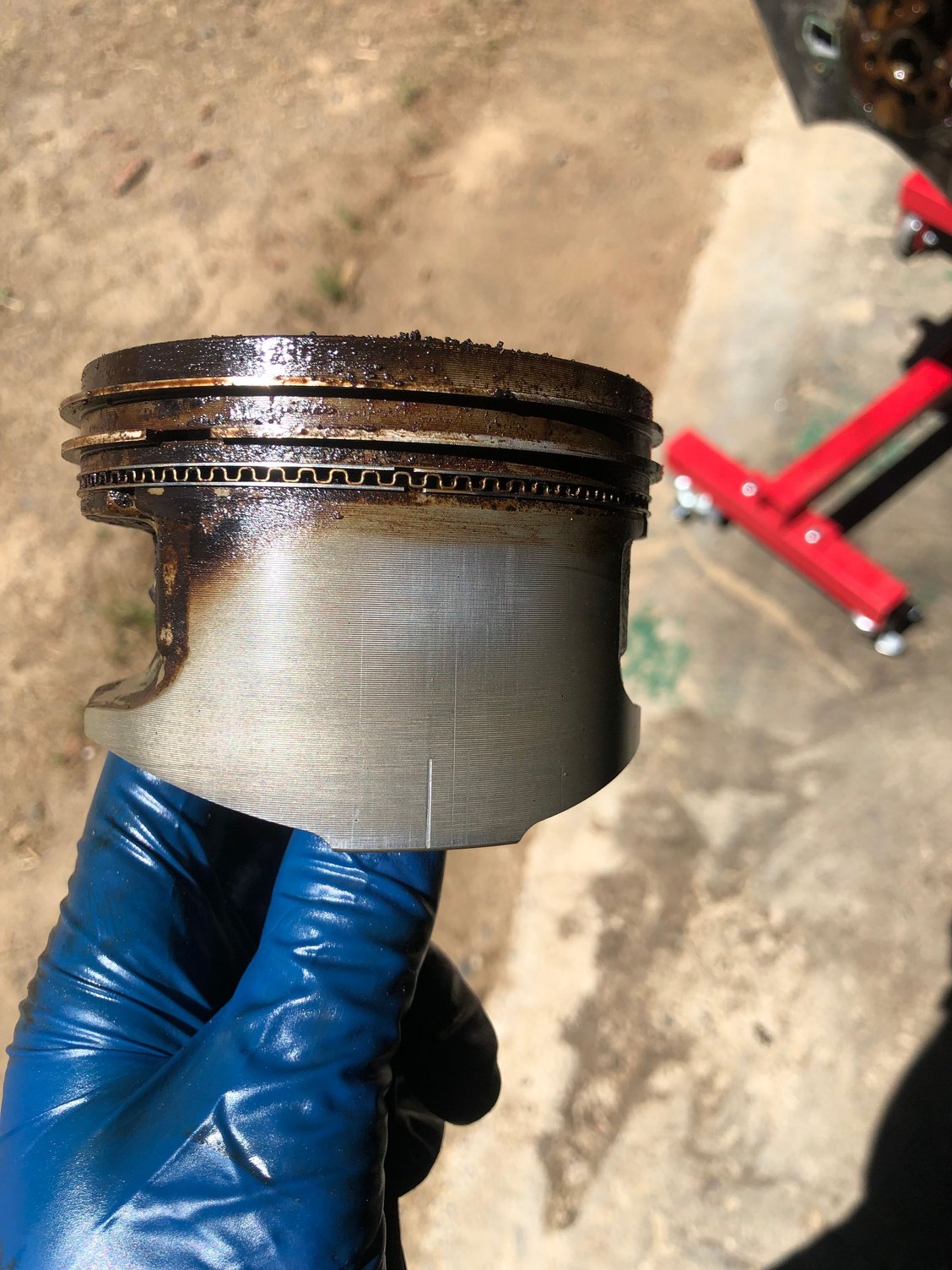

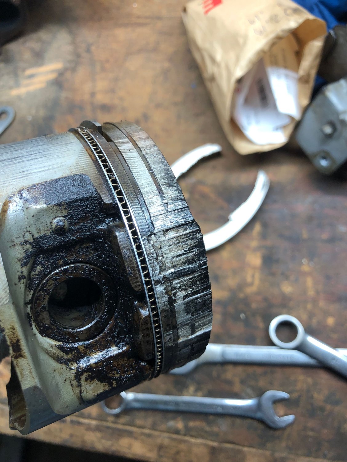

and this was the broken piston in my other post that I will be replacing.
So whats next? Are these pistons reusable? How bad is the crank damage? Will it work with the original bearings, or are those too damaged? I'll post photos of the crank bearings when I get the crank out.
If I replace the rod bearings and dont shave the crank, what is the possibility of them slipping? Would this even matter since they dont have holes for lubrication like the main bearings?

You haven't said what your expectations are for this engine when you are done. Are you happy with it if it'll just get you the the grocery store for another year before it fails? Do you want to tow a 4 ton trailer at 80mph across the Rockies during a heat wave in the dead of summer? Do you expect to get anther 200K miles out of this process? Your pictures clearly show parts that MUST be replaced - that one piston in particular and that rod bearing for starters. You have what appears to be scoring on that rod journal. Any flaws in the reused parts will immediately transfer to your new fresh parts and jump start the aging process. What decisions you make about that to reuse and what to replace depend on what you expect to have when you get done.
I don't know why LR chose to make honing optional, but that CERTAINLY refers to factory OEM rings. Does that instruction apply if you are using any randomly chosen third party ring? In general, honing is mandatory for new rings. What do you expect a hone to accomplish for you? You are talking about it, so you have seen some info saying it is something to consider - what do you understand it to do for you? A hone can be a necessary step, but might not be a sufficient step.

I would not use any that looked like this
Originally Posted by evil_goat
The others are usable
I would not reuse the rod bearings, crank looks fine.

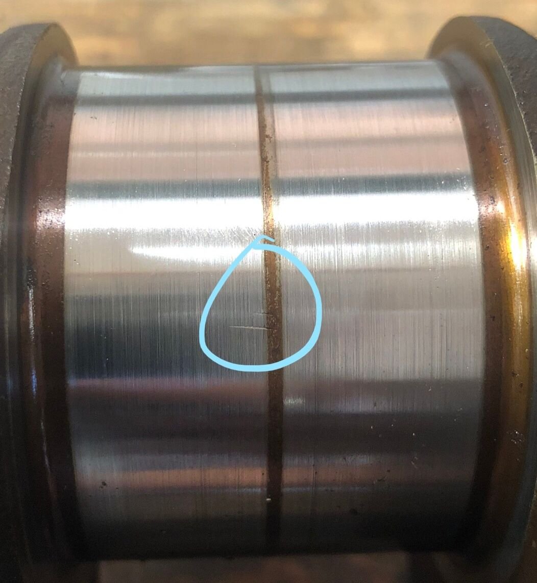

Without knowing your budget I would recommend downloading the River v8 rebuild manual and blueprint as many components as you can. Did you find out what caused the failure in your bad engine? The piston skirt wear is concerning. The crank as stated looks OK but without seeing it in person can’t tell. Lots of things can be out of round. Anything you are reusing should be checked against the specs in the rebuild manual. Is there a reputable machine shop near you?

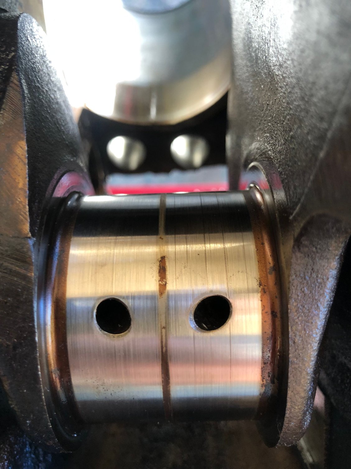

I noticed some small scratches on the crankshaft. Are these OK?
I
Here is the main bearing and crank wear. I assume the crank wear is fine and that I should replace the main bearings, correct?

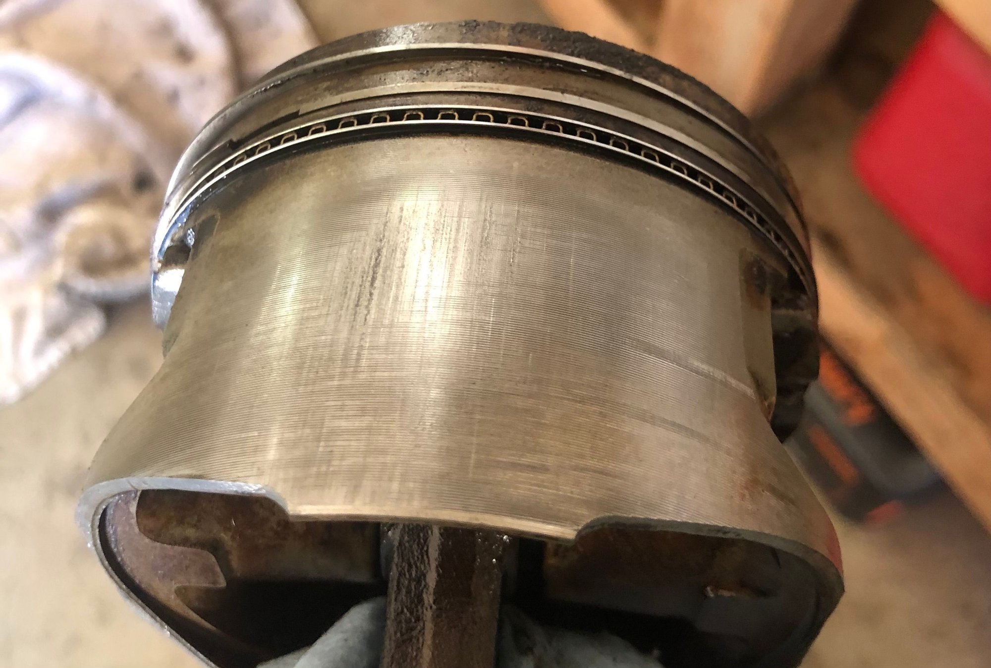

Here are some more photos of different pistons. Can they all be reused?
