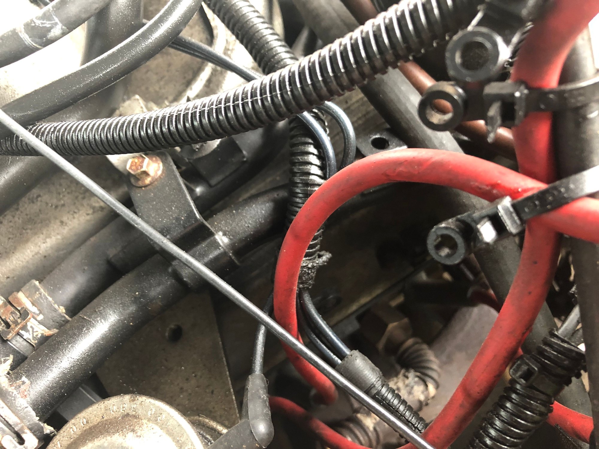

Well sure enough I have a leak on the sai piping passenger side.
Looks like someone tried to put something over it before.
Any tips to patching this without removing anything.
Maybe flex seal lol
