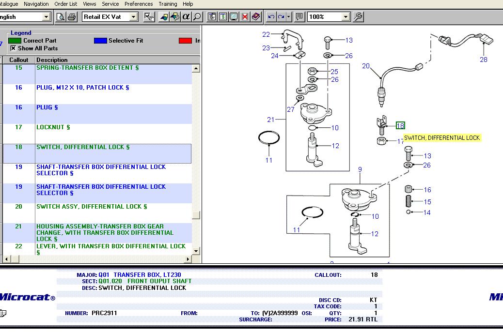

Well it appears my switch is totally dead now and the dash CDL light isn't coming on at all. [:@] I tested it today and no light. I've gone under again and used a wire brush and re-connected multiple times but nothing is happening. Is this a part I'm likely to get out of another t-case, or are there specific part numbers to order new? I would need the differential warning lamp switch & threaded spacer. Thanks for any help on this one.

Switch part number PRC2911 , you say you need the washer aswell? you have already got one of these ?
I do believe it is VERY similar to reverse light switches fitted on the Disco and "Other" cars, but cannot confirm that 100%

Ahh, I had the Microcat but didn't think it was something I'd need or use. Looks like I was wrong. I do have the threaded spacer, but wasn't sure if they'd both need to be replaced. I'll call the stealer and see about getting one from them. Thanks again Urban Panzer!!
