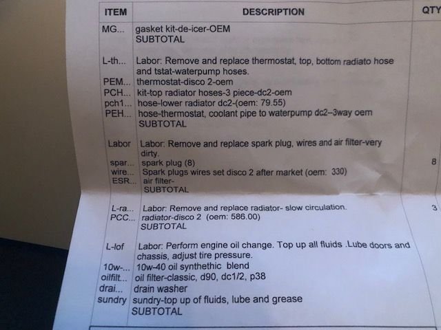

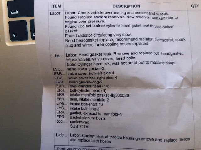

So here's the little that I was able to see in my engine (yes, I was the jerk that held up traffic for miles today on the Bay Bridge!)... There was coolant in the reservoir.
Back in October I had nearly 5k in fixes to the car.
Replaced:
head gasket
throttle deicer gasket
coolant reservoir
radiator and hoses
thermostat
spark plugs and wires
(invoice attached for specifics)
Anyone have any thoughts?
Thank you, any my apologies if I made your commute hell today on the Bay Bridge.
Old Dec 7, 2018 | 06:30 AM
So you may have started with a over heat but you kept going. Damage could be pretty spectacular
