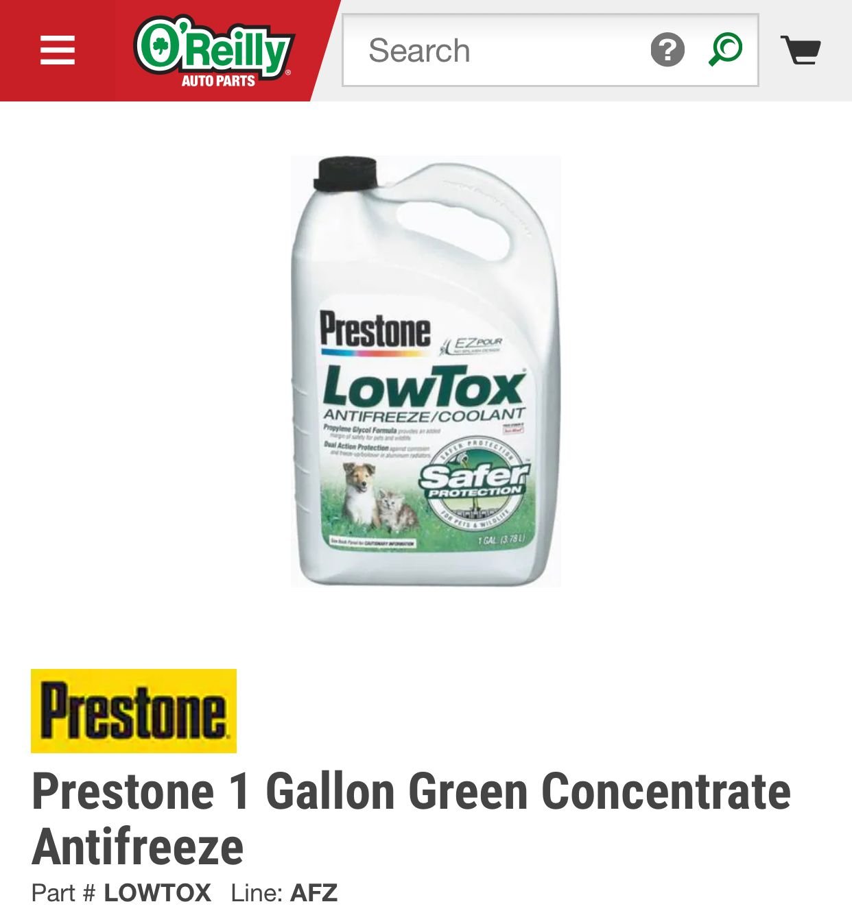

There’s also “LowTox,” which looks like pet shampoo - it showed up when I searched "green" but that might be for eco reasons, or it might be the wrong kind of green...

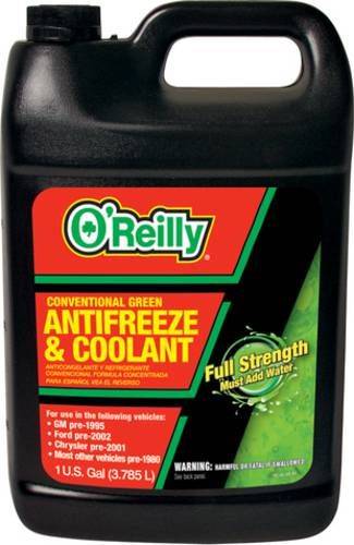

Or O’Reilly’s house brand “conventional green,” which is plentiful, but I don’t know if that’s a good idea or not.

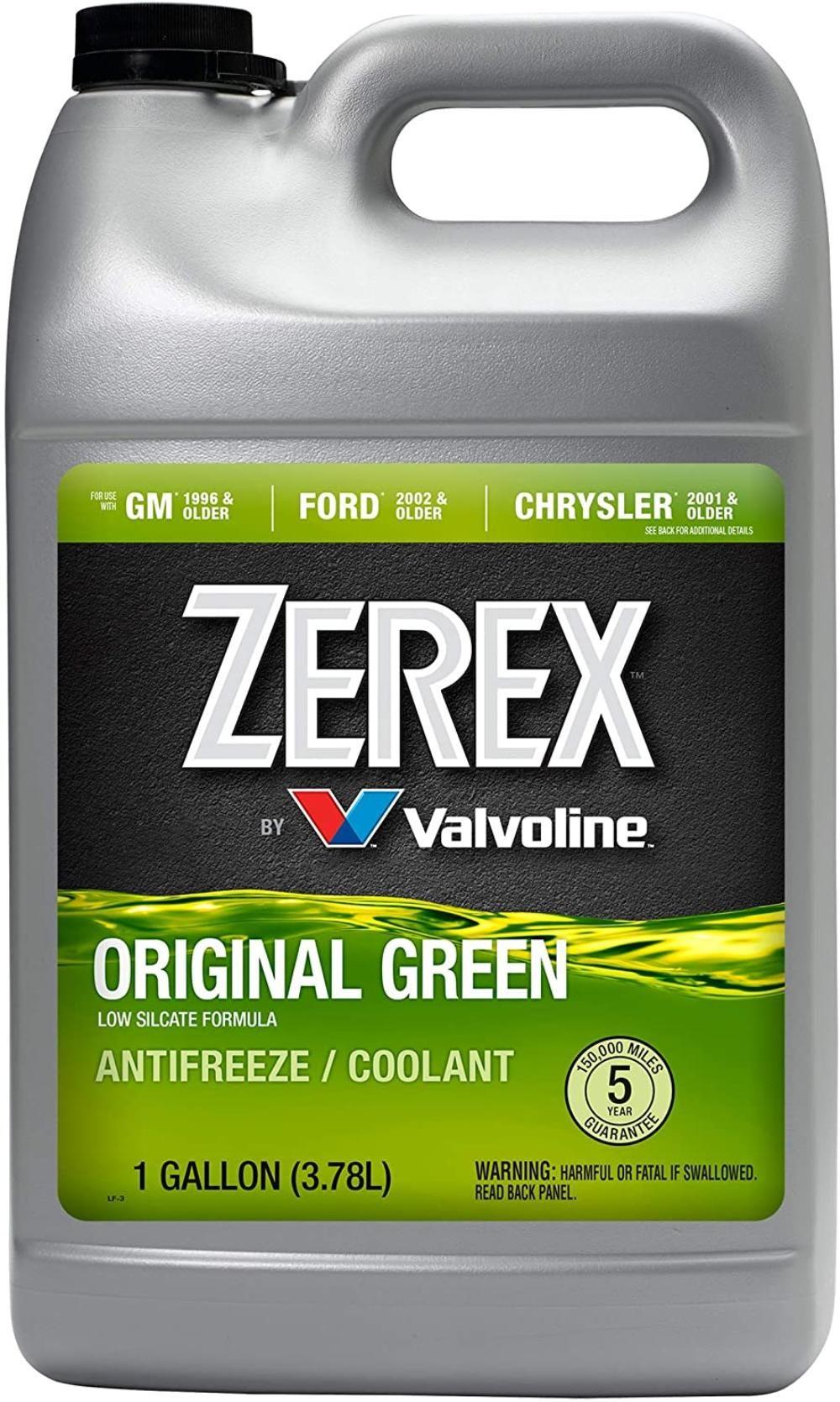

From what I can tell, we’re looking for something that says “Original Formula” “Low Silicate Formula” “older GM/Ford/Chrysler” - is Zerex “Original Green” a good option?

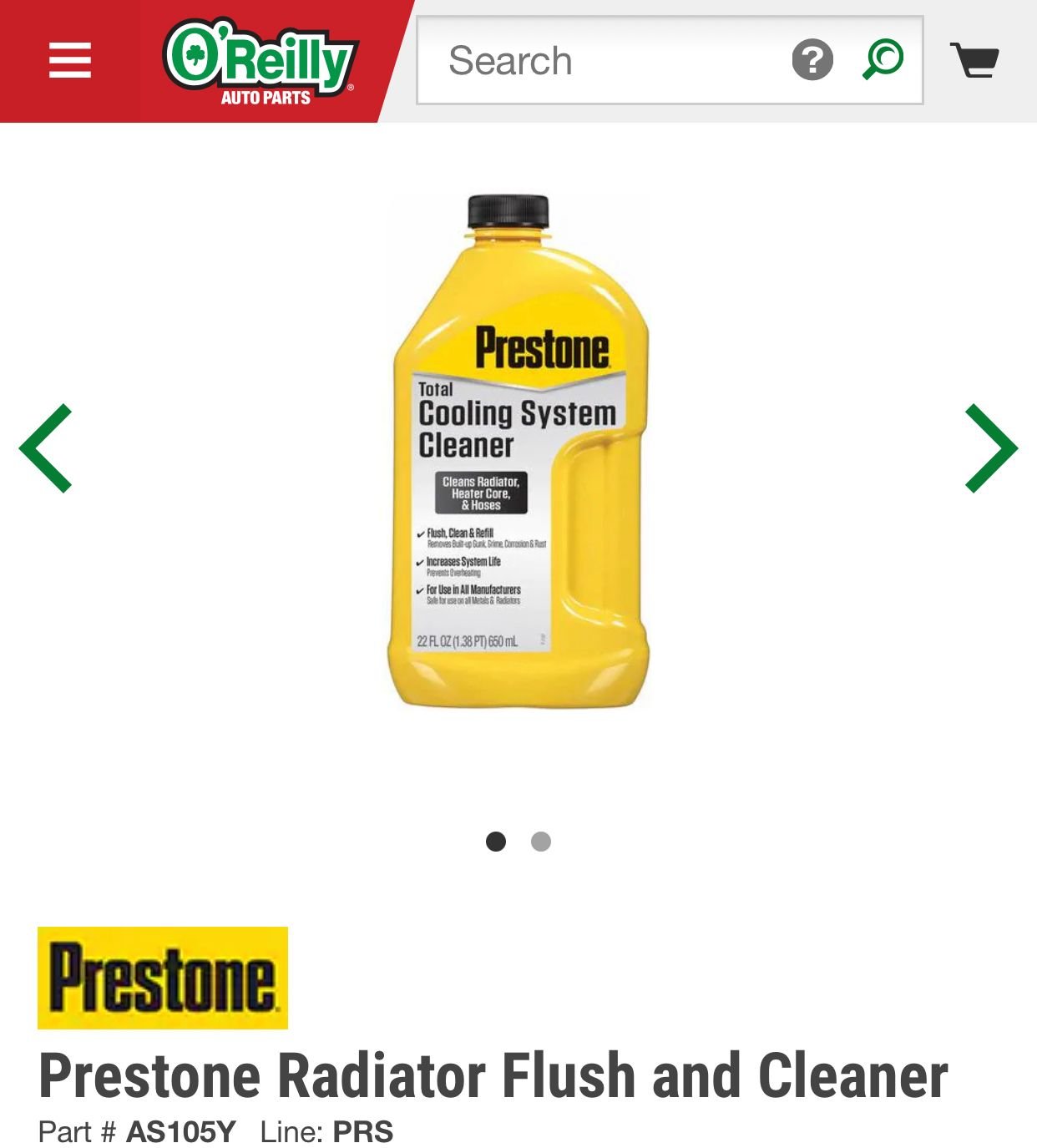

By the way, is the Prestone cooling system flush good and safe? I think there’s build up from hard water and then who knows what from all the years of unknown history, as well as the brakleen and scotch brite debris from my cleanup that got in there.

Any of those are fine. Just don't mix with other types. I use VW/Audi G13 because I use it in my Audi as well. Just easier that way. Zerex G-05 is good too. Just flush and use any of the above consistently. All good.

Thanks, it looks like the G-05 is a yellow coolant and it’s available nearby. How often do you flush it all out? Would you flush with anything other than distilled or tap water, like a cooling system flush to help dissolve mineral build-up or sludge that might be in the system from its unknown history?

Drain and fill with tap water. Run a few minutes and drain. Good time to back flush the heater core with a garden hose. I'd fill with distilled water and drive for a few days. Drain and fill with 60/40 G-05. Some water will remain in the block. This will end up close to 50/50. Drain and fill maybe every 3 years or so. Good to go.
