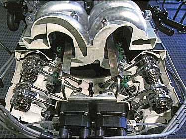

probably a multiple misfire code. May have swapped a plug wire., or one is not seated fully. See attached diagram.

Thank up for the picture. i had that with me while changing the plugs. that was rough getting on top of the motor to disconnect and reconnect the wires.
