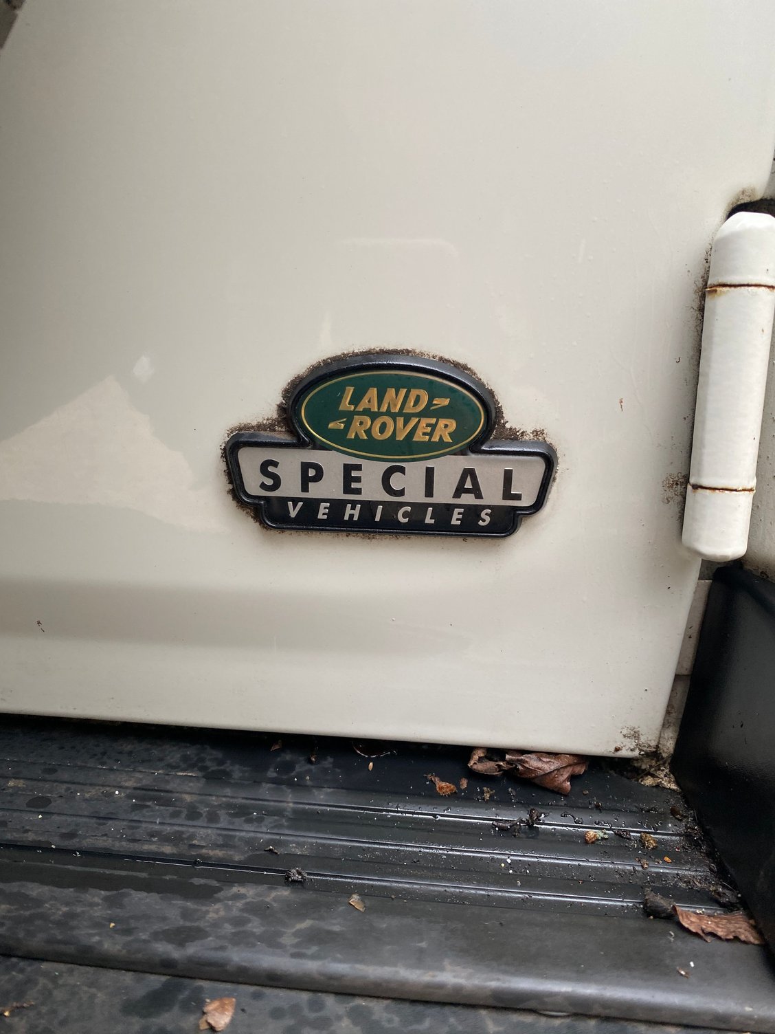

But - it’s a legit Kalahari. Bumper cut outs, Saudi grill, Safari Gard sliders, brush guard, light covers, weird leather + cloth interior, Typhoon wheels, and LR Special Vehicle's badges. Pretty cool!!

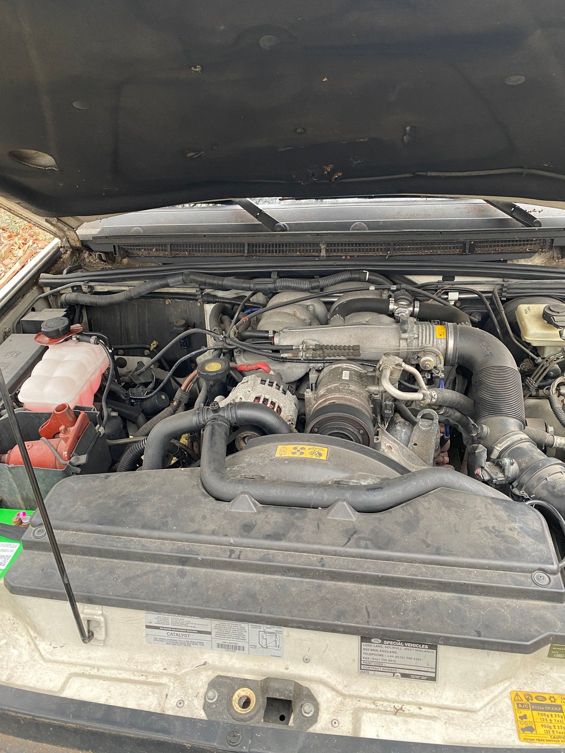

The motor is, almost, flawless. Within the 20k miles it’s had head-gaskets, camshaft, lifters, timing cover/timing chain, and probably more that I don’t have verification of. I mean, the brake fluid reservoir and the air filter had dates on them from when they were last changed.

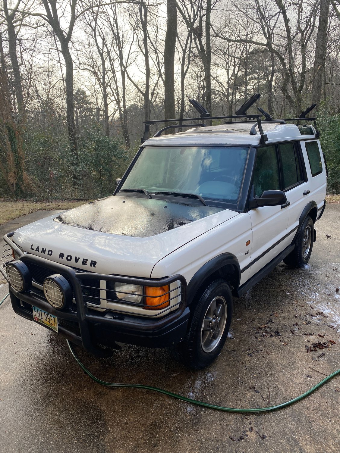

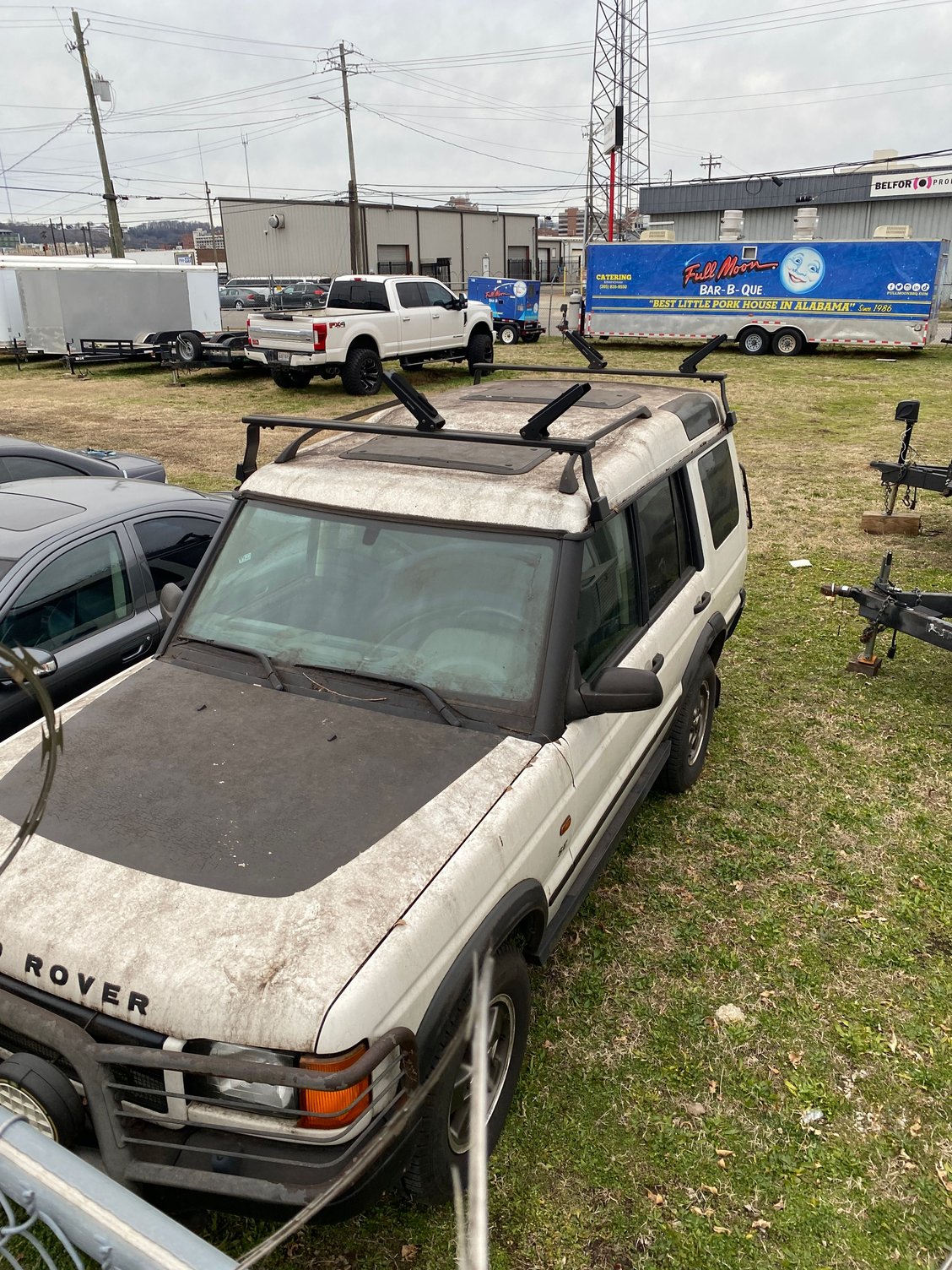

The only shot I have of it in all of its filth. Gross! Could barely see out the windshield!

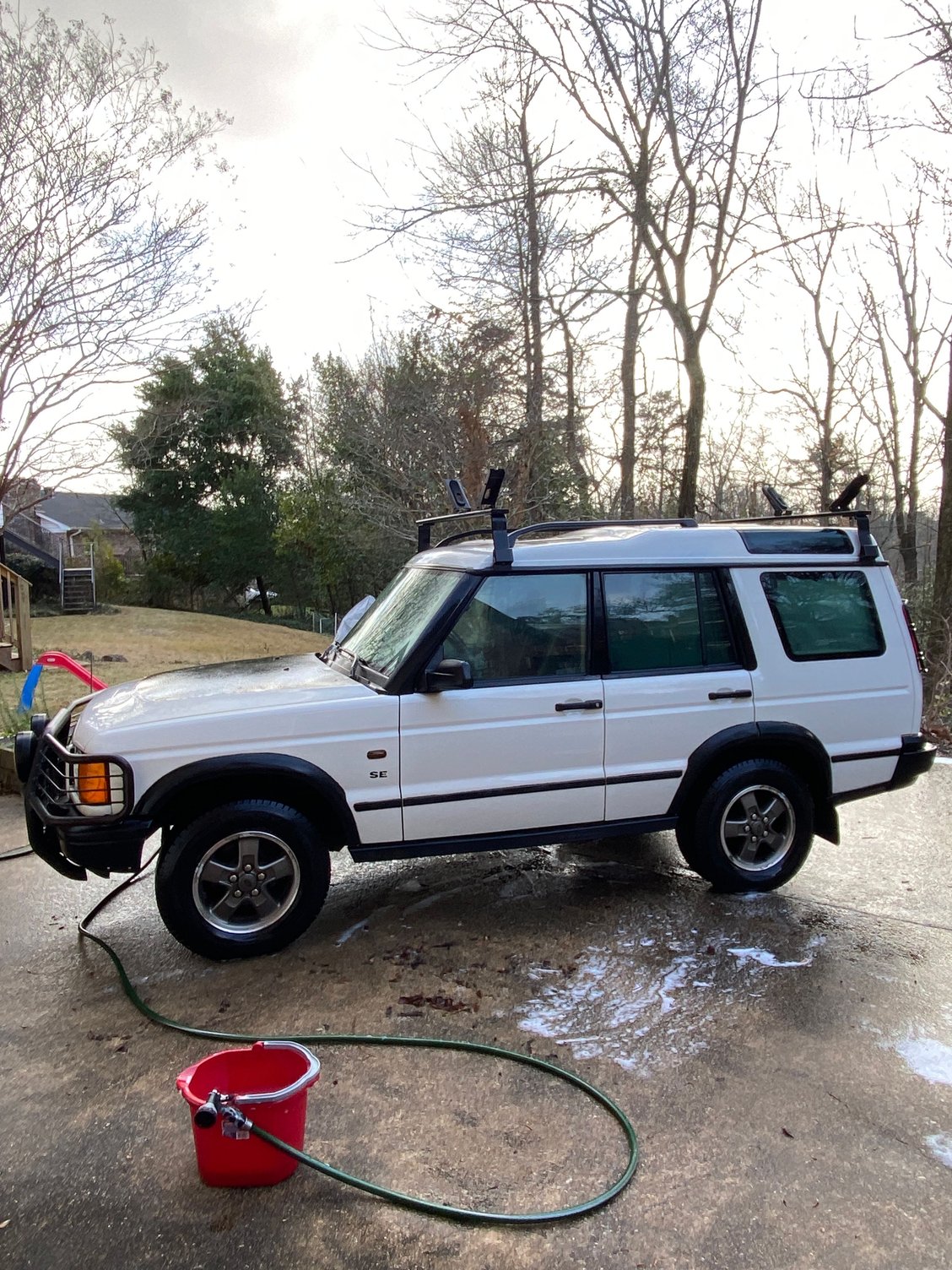

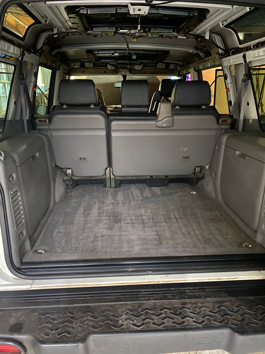

That’s better…
That’s better…

The motor is smooooth. Runs like a top. Tons of service history.

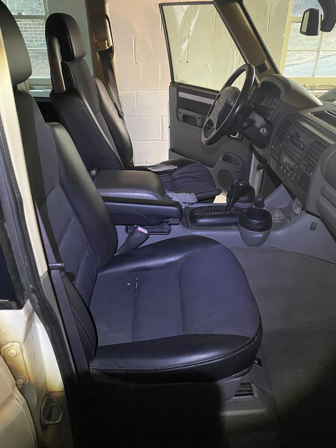

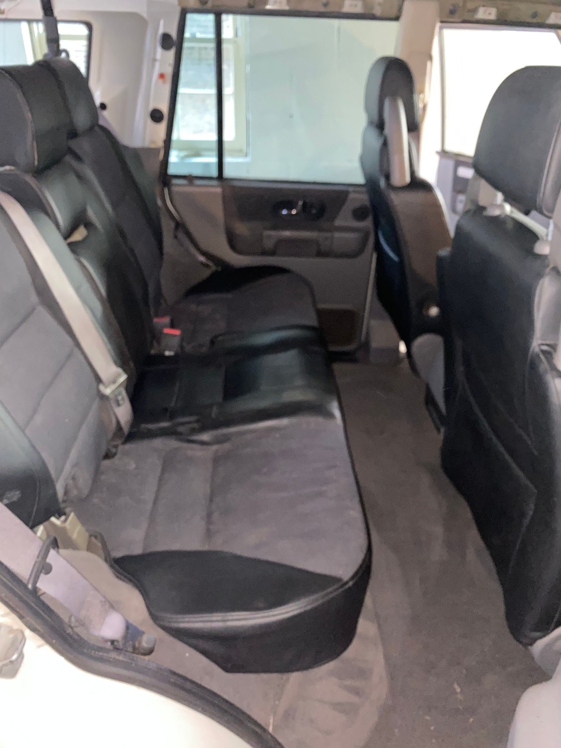

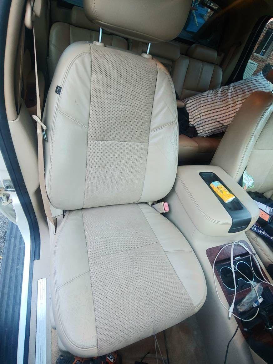

Hard to tell, but this interior was covered in mildew.

Congrats! I have had to tackle these types of interior restorations before. The rear carpet has an extremely thick padding under it. Remove the rear carpet from the truck completely and put it out in the sun upside down to dry out, it will never dry out otherwise and will always smell moldy. Once you have that out you will have a better idea if the front carpets and padding are dry and if they need to come out. Worst case those get pulled as well to dry. Once out you can use your choice of carpet shampoo devices but worst case Mr Clean sprayed on the surface and vacuumed off with a shop vac does an excellent job. The other thing that works excellent is a small electronic ozone generator, I have had good luck with this brand: https://a.co/d/9EhnpLH I put it in the truck, shut the doors and run it a couple of cycles. It kills all the mold bacteria and removes the smell.
All the electronics are just normal deaths, not water related, just cheap BMW electronics.
