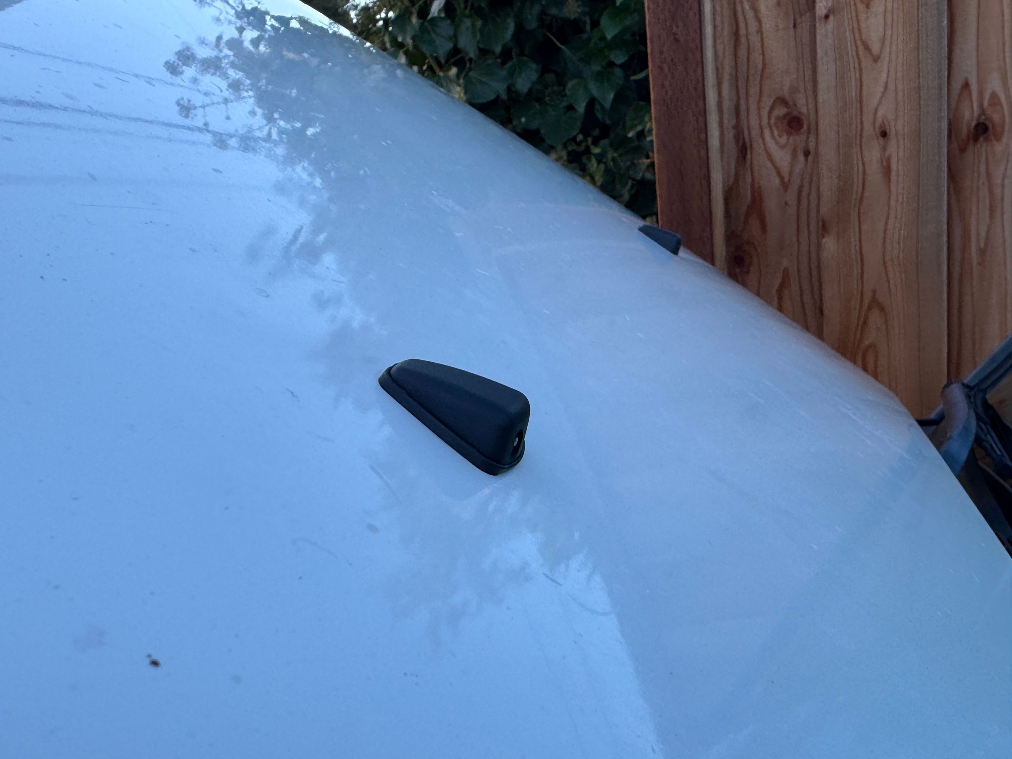

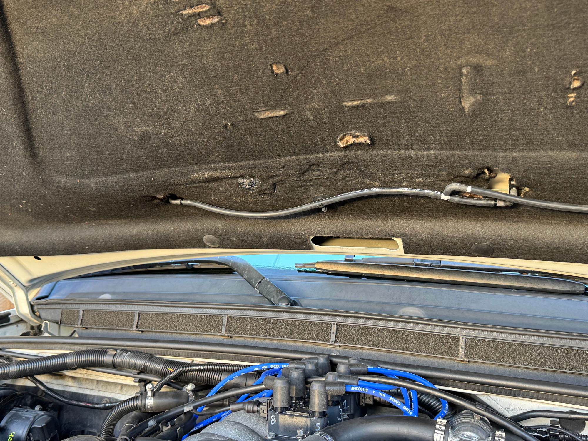

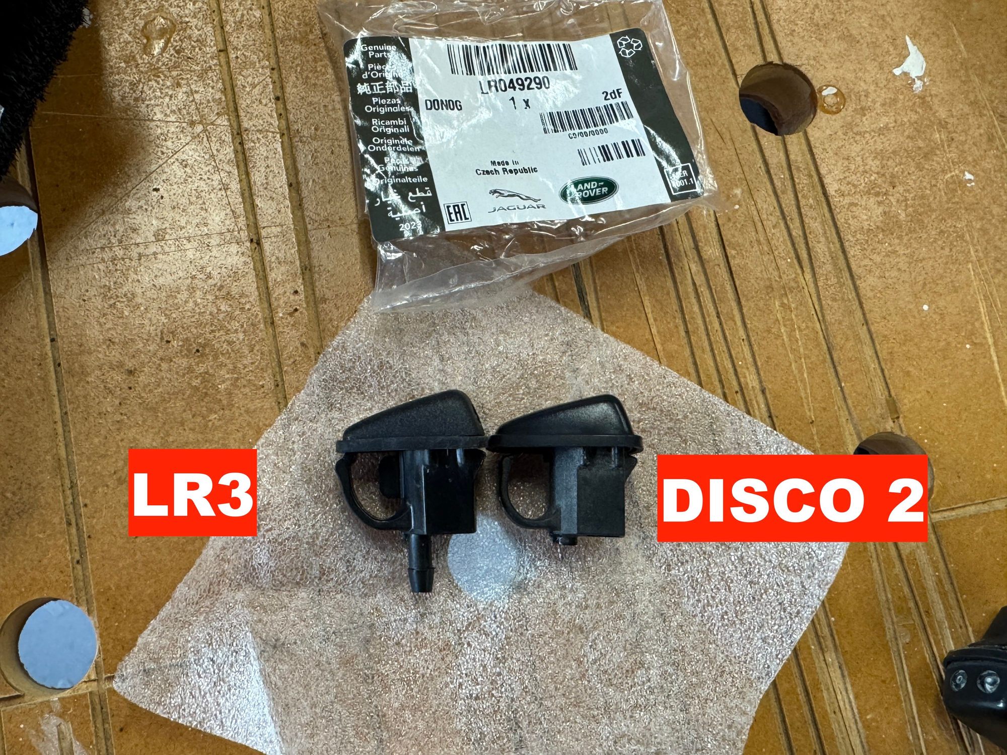

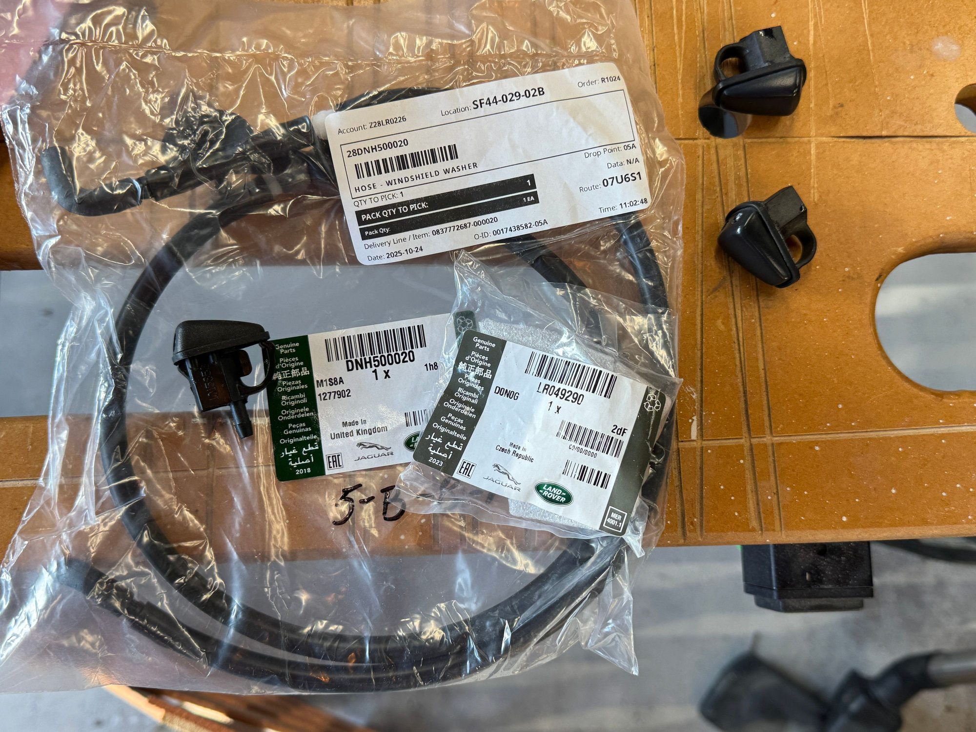

Snapped off the ends of my original washer jets while doing some hood surgery and was stoked to hear rumors of the washer jets from the LR3/LR4/RRS fit the Disco - because they're for some reason way less expensive than Disco 2 jets.
Part number is LR049290. I got a pair of these and a new washer hose kit and installed today and they work perfectly. The LR3 jets are a little taller.
