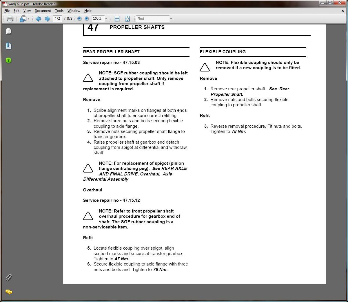

There are just a few bolts to worry about..
Try to get some Pictures tomorrow for you.

A dolly would be better than flat towing. I didn't even think about a dolly when I replied earlier. You can just undo the 3 bolts on one side of the rotoflex coupler and wire the shaft up to the frame to keep it out of the way. No need to completely remove, just disconnect it from the rear differential. Mark the rotoflex and the diff flange so you can realign them when you bolt the shaft back in so you don't get vibrations.
