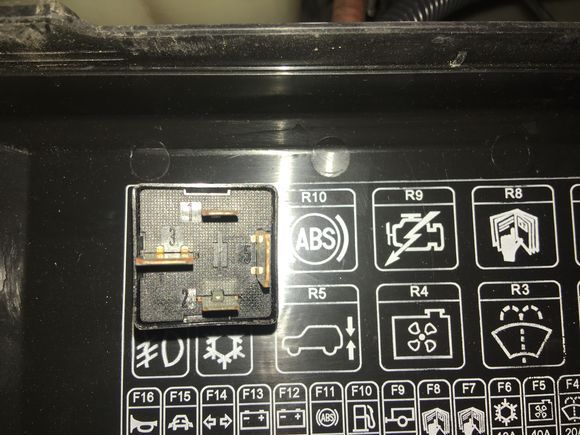

A 15ft piece of wire (a pair), and a toggle switch = quick & easy to power bleed a D2 by jumping the relay.
Yep.
This is exactly what I used for the longest until I got the Foxwell and Nanocom to power bleed my brakes...
And inserted the spades into the #3 & #5 sockets of ABS relay R10 under the hood...
