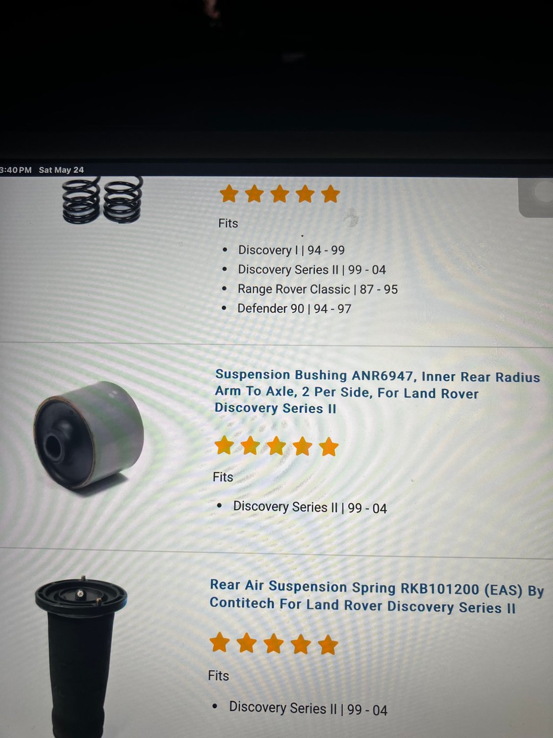

2003 Disco 177,000 miles. I have a loud metal crunching noise from back right when making right turns low speed. New terrafirma med coils and shocks with 2 inch lift, all new wattage bushings and arms. Can i replace the radial arm bushings myself or do i need a press?
any ideas other than bushings to explain noise. Brake dustguard in tact, hub bearing ok, brakes work well
Do I need a press to install this bushing?

You will need a press to install OEM rubber bushings as pictured. You could cut the old ones out and install poly bushings that don't need a press. Time to buy a press or go for the Powerflex bushings. I have not used them for Radius Arms but did for Watts and Panhard. I like them and easy to install.
