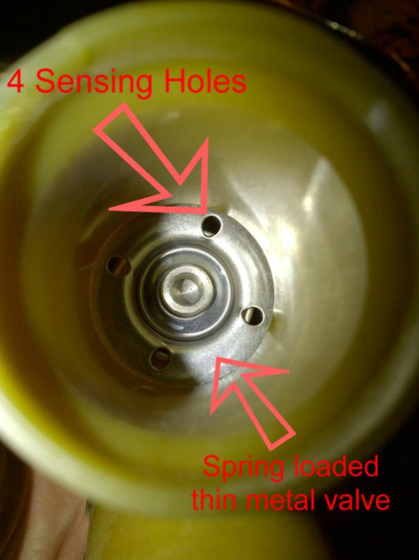

If your fan spins more than one revolution hot from release then it is in need of replacement. Your comment about the water flow into the radiator from the bottle.... that could be some circulation taking place from bottle thru small hose, back thru big hose to T, down thru T to main thermostat, thru thermostat meter holes, and back to water pump. When main stat is closed, the small holes in the bypass disk callow flow into the thermostat chamber. When revved up cold, the bypass disk is supposed to move and allow water pump pressure to not go thru heater core 100%. Meanwhile, main stat is closed and no water flow out of radiator bottom hose.
