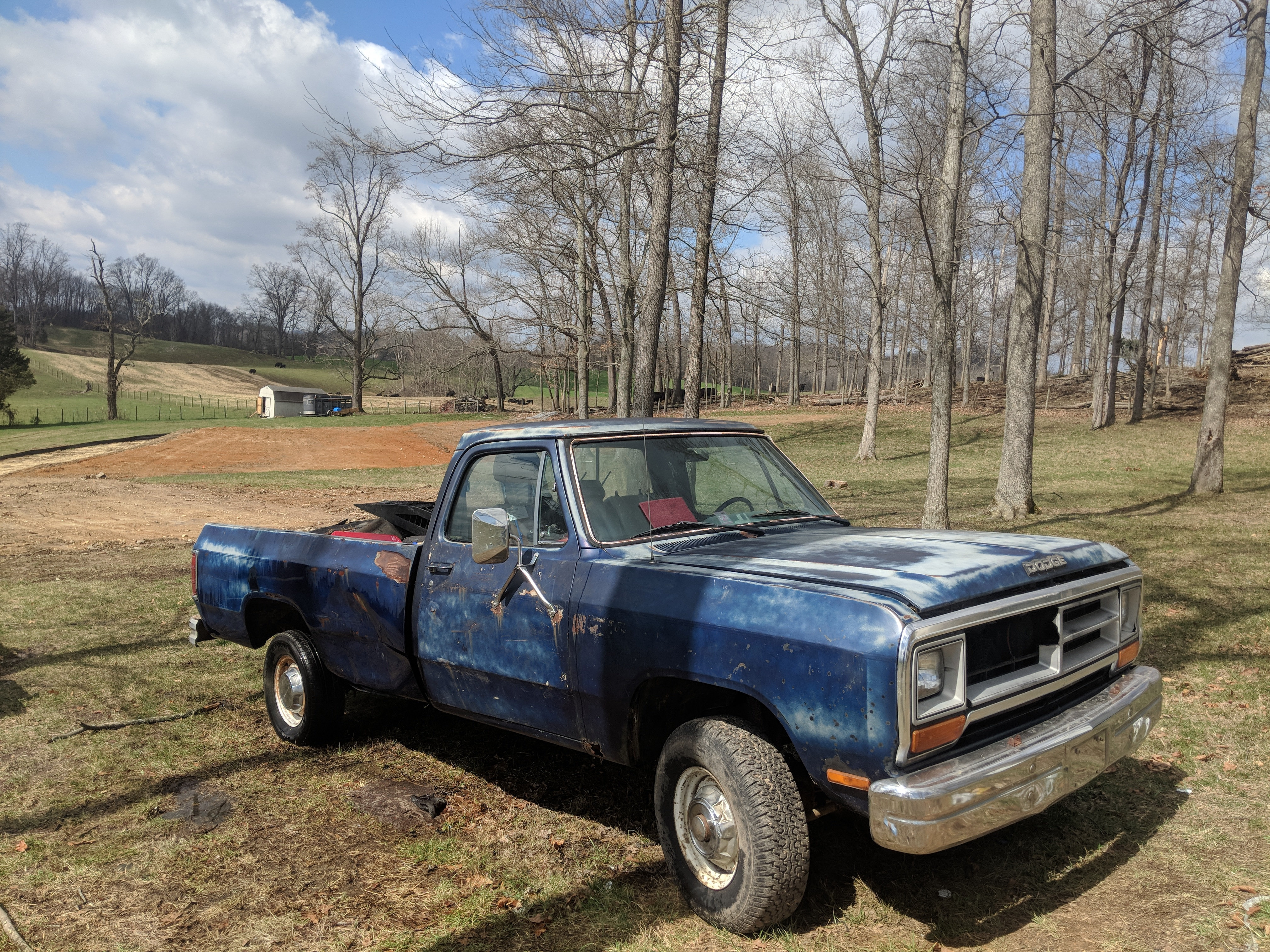

Afraid not, I still haven't gotten around to it. Probably will be a little while before I get to it, but when I do I'll make a post per usual. Gotta do gears first and i've got an old Dodge pickup I'm hopping up a little and trying to get ready for a daily driver suppliment.
It's not much to look at, but the price was right and only 88k miles on it with a really clean frame. New set of tires should really help the look, cause who needs paint?
X1 ..................... I like that, it's got character and with 88k miles, new tires and a clean frame, as you say, who needs paint

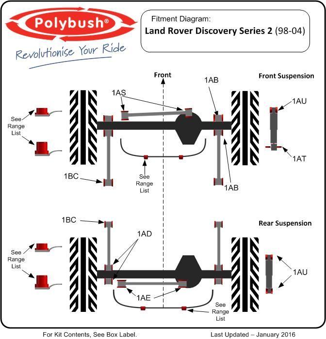

I found this on Polybush...
Discovery Series 2 - Land Rover - Polybush
and how to fit the bushings...
Fitting Instructions - pages - Polybush
