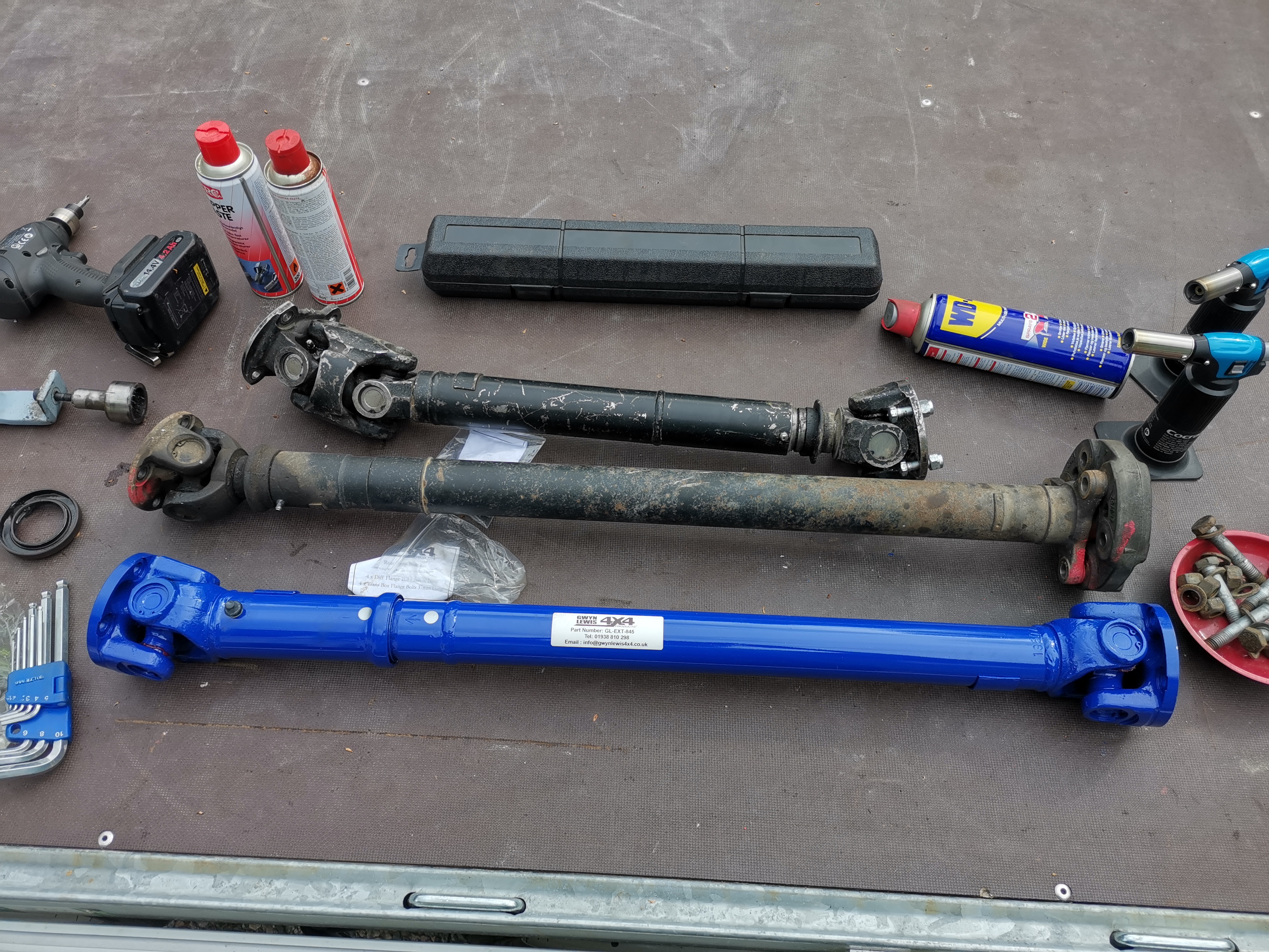

I'd say, go for the 4 bolt flange and new prop with u joints on both ends and loose the donut.

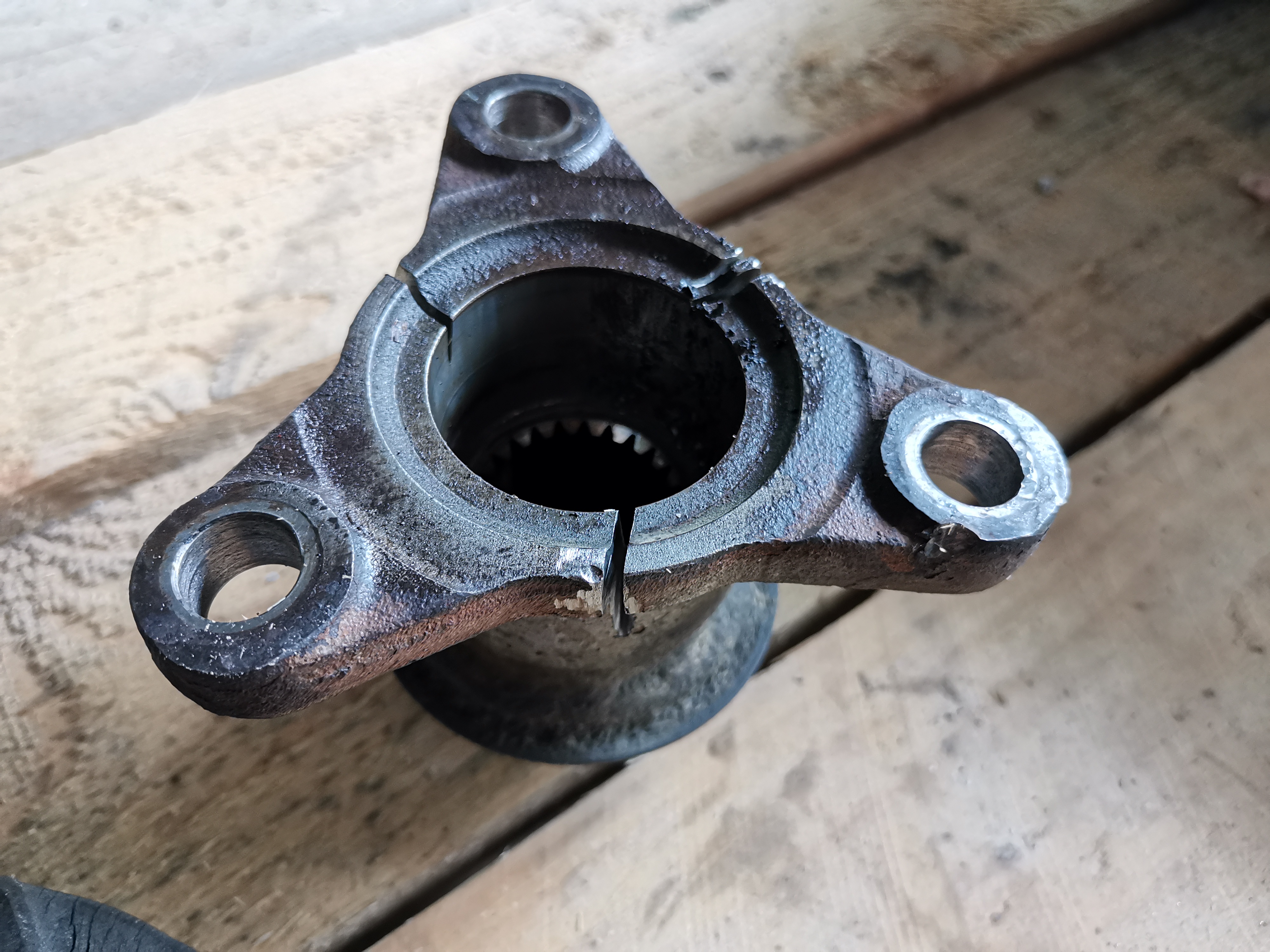

Remove the rear prop and rubber donut.
Get a Dremel or something with a small cutting disc and cut the 3 bolt flange open to get the centering pin out easier. It can be very tight to get out without cutting some reliefs to the flange. And you wont be needing it anymore so no reason to try getting it out intact.
Red arrow shows the edge between the pin and flange.

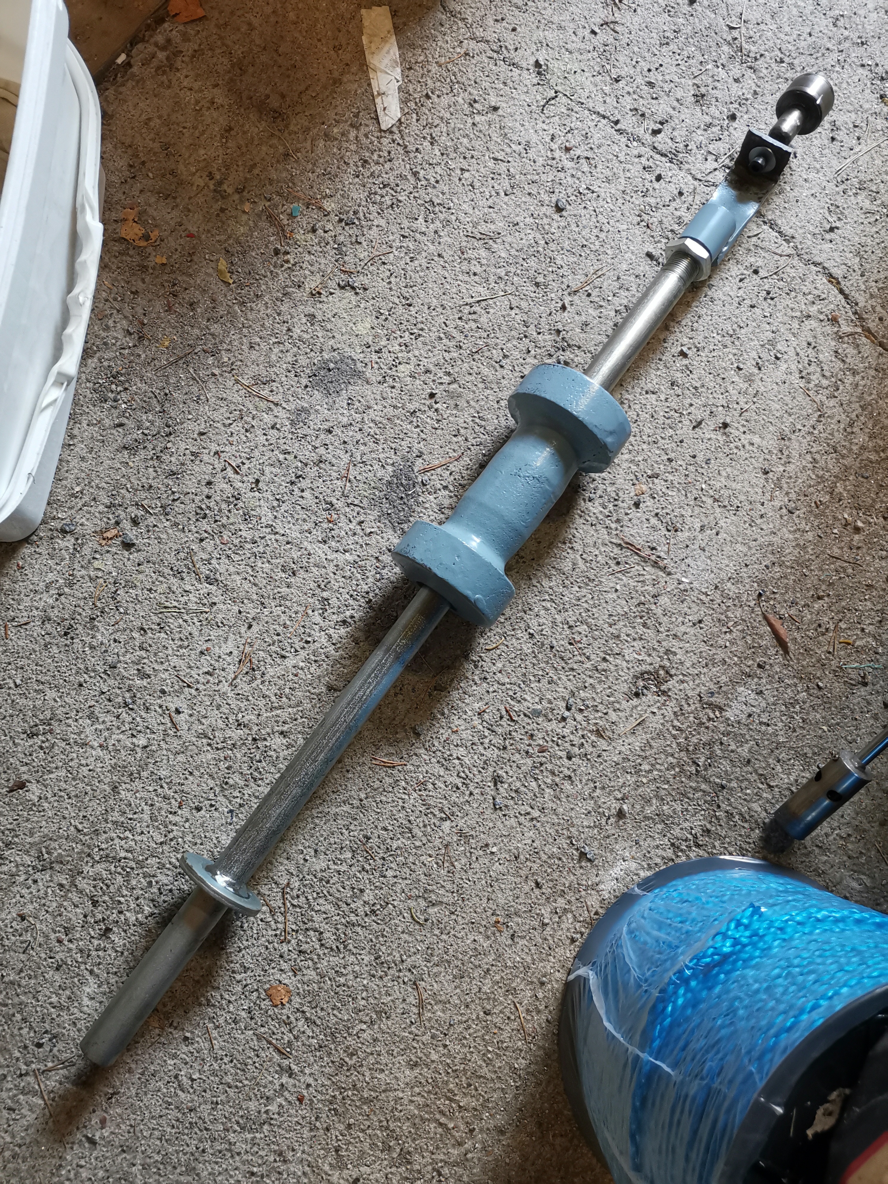

There is a M8 thread inside the pin to attach a slidehammer or something to it.
I had my bigger one on hand as I tried to get it out intact.

I wouldn't use it.
It's not strong anymore and is out of balance.
I just have no use for it anymore and used the tools to remove it that I had avail. Maybe with induction heating etc, or the right tool, You could get it out intact.
It can also be locked in with loctite.
I've got a write up on this (see my signature), but the easiest way is to run an M8 tap on thru the center of that. Then you can take an M8 bolt (fully threaded) and just run it in. That will push the piece out, no cutting or slide hammer required.
