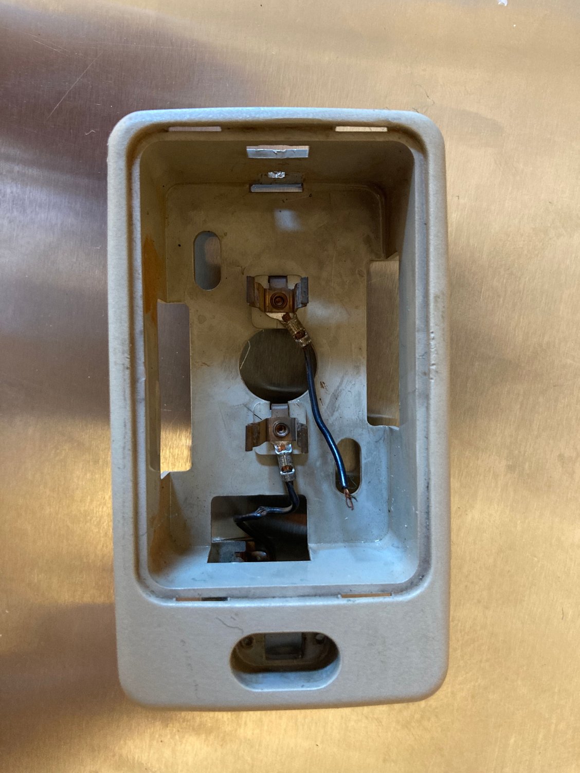

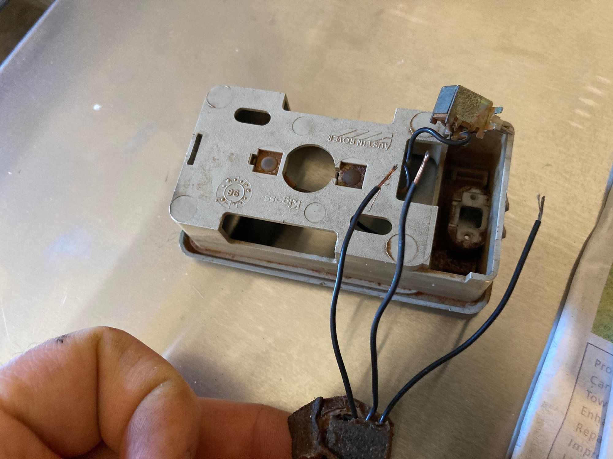

The wires were ripped out of my rear dome light by the headliner guys (this is in Uganda, so no chance of expecting them to fix it). I want to solder the wires back in place but I can’t be sure how they’re supposed to go. Can anyone either take a picture of their dome light wiring or give me some guidance?
Here’s mine:
That wire coming from the top/farthest point—where does that wire connect to?

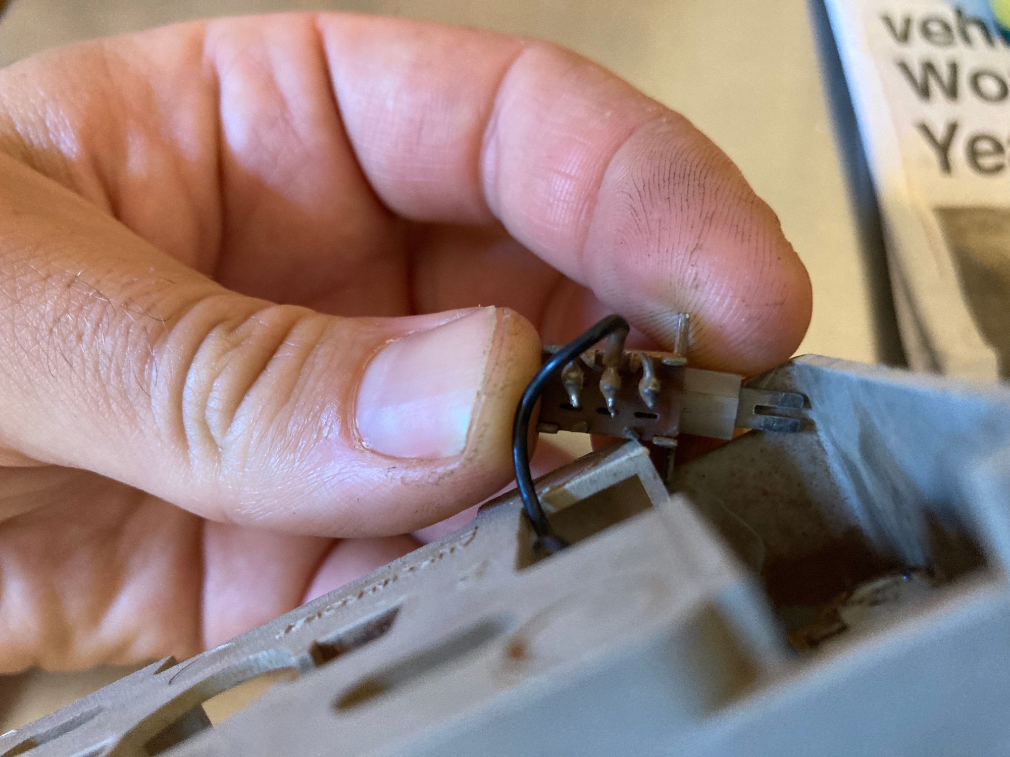

There’s the three metal dewdrops (don’t know what they’re called).
Here’s the wires from the multiplug

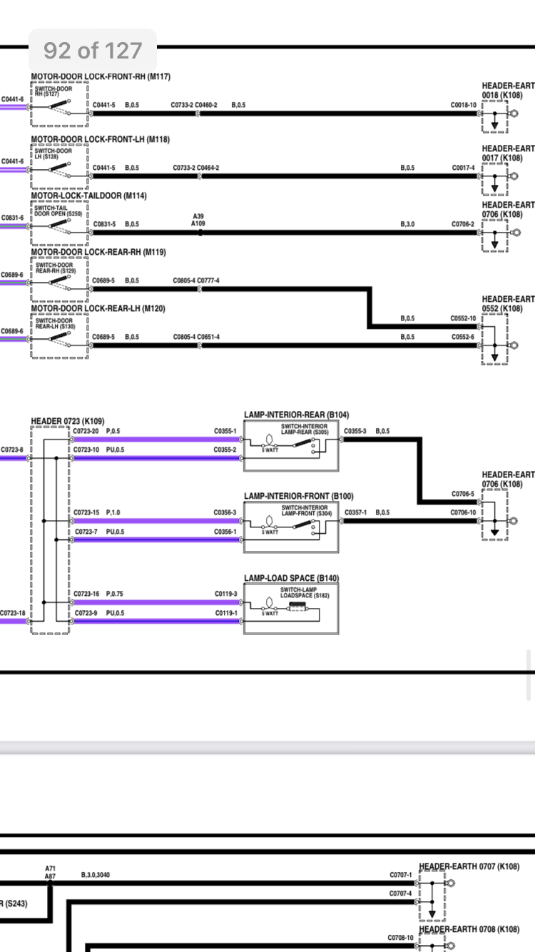

Here’s the wiring diagram too, been struggling to correlate it to the actual components

Success. I matched the wiring to a second multiplug and got it soldered in correctly. That loose black wire was, duh, to ground, and that soldered to the black wire directly on the multiplug.
