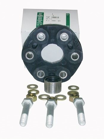

I will bet you a $1.00 that the rotoflex is your problem. I've had this happen many times with RRC('95), DIs and DIIs. Most of the time the cheap aftermarket ( Britpart, Allmakes, etc) roto's fail fast, but old OE GKN joints will also cause vibration problems. And the cracks in the rubber do not have to be major. If you get the roto off the truck and twist it you will see tons of small stress cracks.
So 2 options; Convert the rear drive shaft to a (2) U-joint shaft, or get a NEW GKN Rotoflex. If you choose the rotoflex... Trust me, you ONLY want a NEW GKN (#TVF100010G Made in Germany). Good Luck!
The GKN Rotoflex is good to go, it's the best.

Lucky8 has the rear conversion kit if you wanna get rid of the rotoflex but if not go factory and not cheap on it. It will bite you in the *** if you do.
